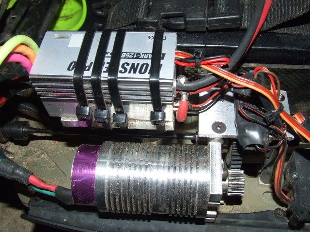

This is the latest version of my setup...
I ran it tonight with the 40 series Moabs, geared 13/46 on the 9XL with the Quark esc, with a maxamps 4S 8Ah pack and it thermalled after about 3 minutes of running. I thought I heard it cog, so I'm figuring that it was overgeared a bit. What really worries me is that the Quark didn't feel all that hot. It looks like I'm going to have to send it in again as it seems that the thermal pad has let loose (or does the Quark have an over current protection?).
Once Mike's mount gets here, I'm sure that it will look prettier.

that doesn't look like the stock spur, what spur are you using and does it fit on the stock diff cup that came with the losi? did it require any mods?

kyosho spur i think, fits.

That is a 46T Kyosho nylon spur gear. The Losi 8ight center diff cup is the same one that is used in the Muggy and Sportwerks 1/8 scale vehicles. The stock diff cup did need to be modified, in that I reduced the outside diameter of the upper portion of the cup by about 20/1000ths. It is my understanding that the Maximizer aluminum diff cup does fit the Kyosho spur without modification, but I haven't confirmed this myself.

I had to do the cooling mod to my brand new Quark yesterday, just to keep it from thermalling. I ran it for a combined total of about an hour and the Quark quit on me. This was my second Quark. I exchanged the first one for this one. I really don't see what all of the ranting about these Quarks has been. From my experience they are real pieces of crap.
Now all I have is a $280 pretty aluminum box that does nothing and I can't send it in because I had to do the cooling mod to it.

I just ordered a Neu 1512 1.5Y for the 8ight. I've grown tired of the heat issues with the Feigao motors. I do have my truck running well with the 9XL on 4S. As you can see in the pic above, I had to turn a custom heatsink for my motor. It completely encases the motor and is a tight fit. I had to do some mild pressing to get the motor into the sink. It didn't do anything to reduce temps, but I can now run a 30 minute race before the temps reach critical.

I also installed Mike's motor mount. It's pretty. The chassis mounting holes were a bit shallow, so I had to cut the screws. Later, I'm going to get a tap to cut the threads a bit deeper, but I'm sure that this will be fixed in later versions of the mount. Other than that, I would have liked to have seen a relief cut to allow easier access to the pinion screw. On the whole, the mount is a keeper. I was going to go back to my homemade mount, but it is heavier and for racing, I'm counting ounces.
