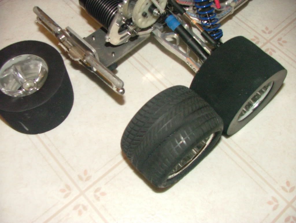

I working on some foam tires for my rustler. They are 3.5" tall and have 2 types of foams as well. Still need to glue them and see what they can do.

Those look pretty sick, man. What are you using for the foams?

I bought the foams online. Those are the cheapo ones..10bucks a pair. I have the 20 dollar silver compound as well. I still need to work on some new rims with the outer lips intact still. I'm still seeking a manufacturer for the foams.
But I got them here.

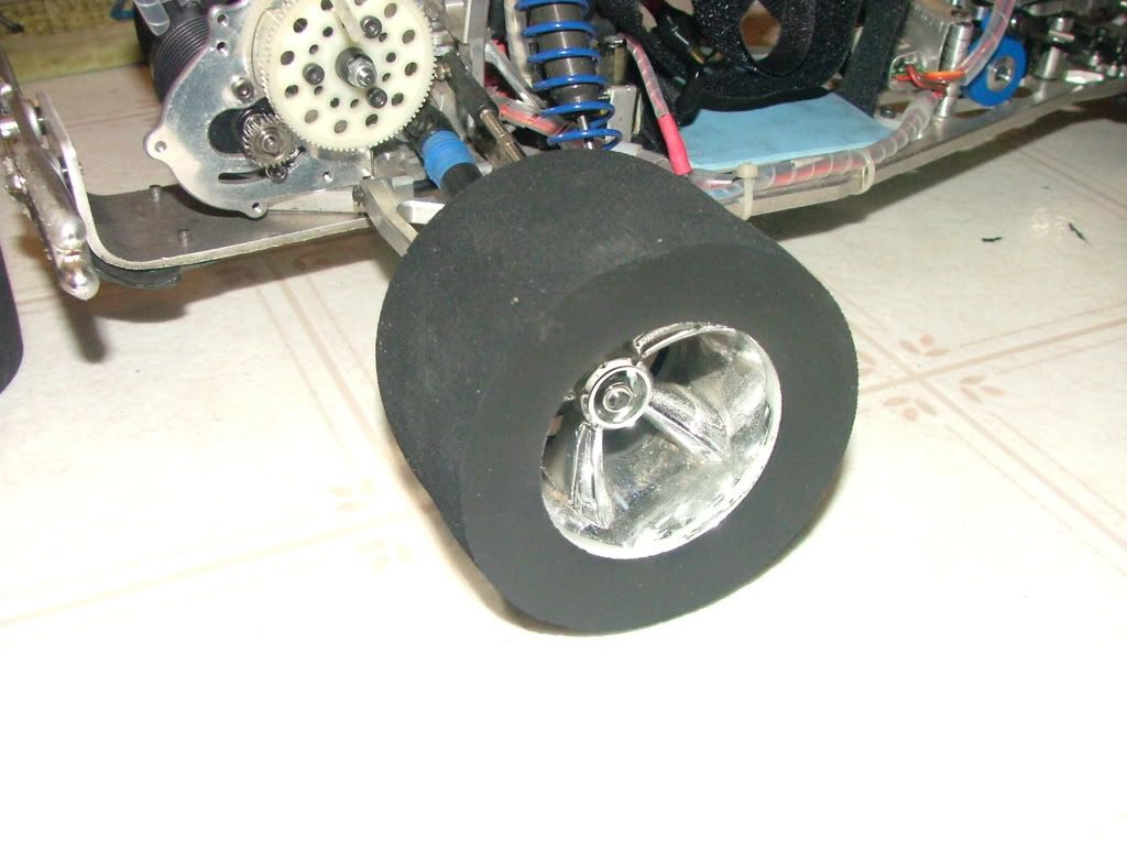

How exactly do you go about gluing foams? I mean, is there a proper way?
Is that a stock Traxxas spur I see in your above picture, and is it bolted to a Revo slipper?!??!
Also, good idea using the Rustler bumper as a liner for your wheelie bar. Less friction and the Al wont wear out.

The glue part is what I'm still trying to master. There are so many glues available and I'm still finding out what will work and what won't. But so far I have used 3M #77 and it worked great on the foams. My drill press is working overtime cutting up old rims. So far the tires don't balloon at all, freewheeling at max unloaded speeds. 180 Grit sandpaper is what I use for creating a rounded edge and flat contact surface.
The spur is connected to a traxxas adapter, which eliminate the slipper all together. #3693 is the traxxas partnumber.
That bumper/skid mod works out great for me. I don't worry about breaking little wheels at high speed tumbles. That plastic bumper is cheaper then a set of wheels and bearings.
