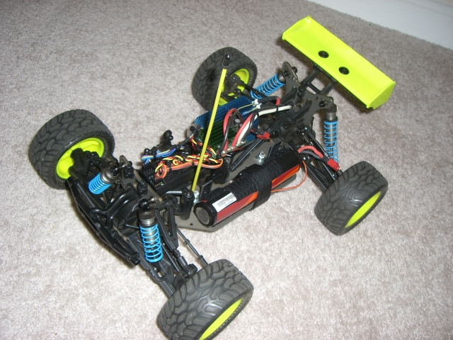

09.15.2007, 01:29 AM
I am using a 4s 4000 maxamps pack. Basically took the emaxx chassis and cut out one battery tray. Made a plate to go across the top off the CD and stood the tray on its side. The stock hold down can be used with 3s but I used longer screws with 4s. Heres a few pics, works fine for me. I have the same setup in a LS10, slightly larger truck, but slightly lighter than the crt.5!? The pics show a 20 tooth pinion, that is what I ran with the 3s setup.

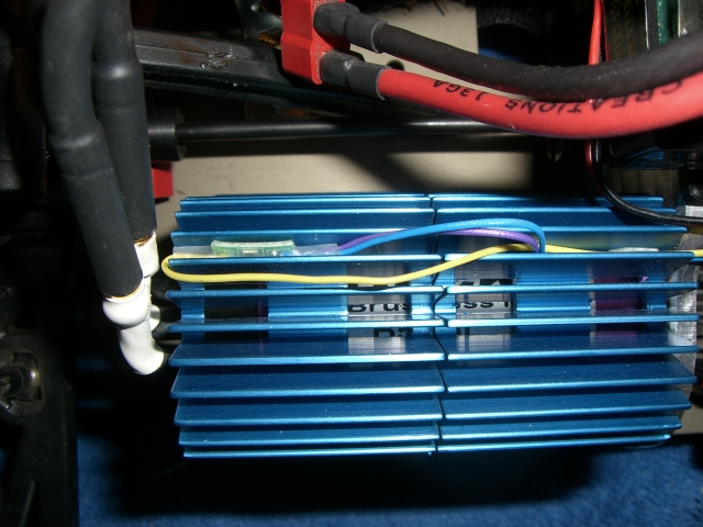

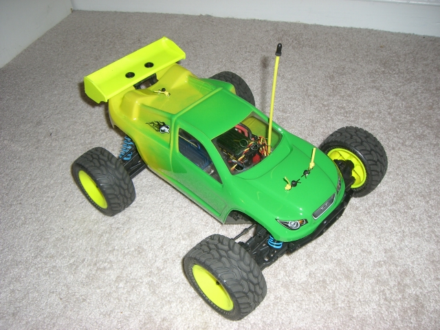

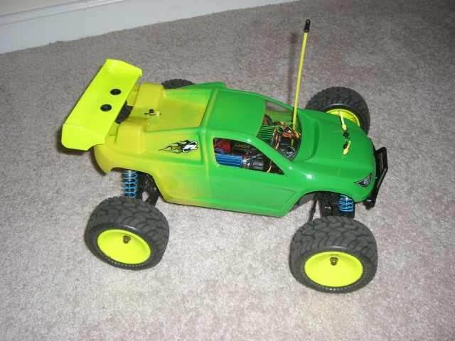

Almost done!
Just got the React in the mail today. This radio is really cool.
Installed the transceiver in the buggy with the temperature sensor.
I've got the basics configured for the system and the difference is amazing.
The steering response with the digital servo is so smooth and instant. The motor response is smoother as well. I'll get the chance to run it outside tomorrow, but just running around the house there is no signs of glitching at all.

OMG - I love the React!!!!!
Took the buggy out to the park after work today. Ran the car pretty hard in grass through 2 of the 3S 5000 mAh packs and a 2S A123 pack.
Goodbye glitching - and goodbye heat. Seems the glitching was causing some pretty high current surges and heating everything up.
Running temp of the motor is now 110-120* and the ESC is warm to the touch. Batteries only just warm as well.
The range on this radio is really awesome, as is the feel driving with it. I am absolutely loving the telemetry - the heat sensor is just awesome. Hooked up the voltage sensor as well when i got home. I love the ability to change the alerting settings on the fly right from the menus.
I think I can consider this build complete.
