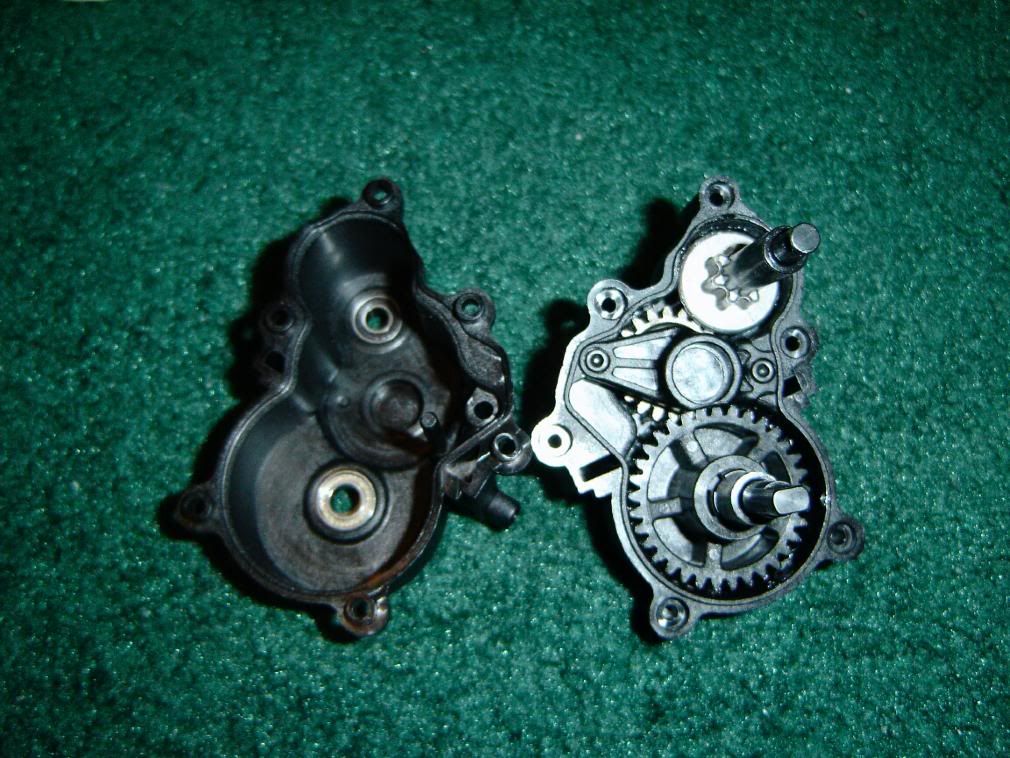

Got a new E-maxx transmission from tower for only $48 without motor plate or spur gear, but eBay has this exact thing going for at least $70. So finally got the transmission in and a servo and such.
Threw in the old Velineon on 3s and geared it 19/68. Seems to have more power than I remember, could pull 10 mph rolling wheelies and flip it onto it's lid in the blink of an eye. Will make some for an amusing video when I get some decent clips together. Jumping will also be done, jumping is good.

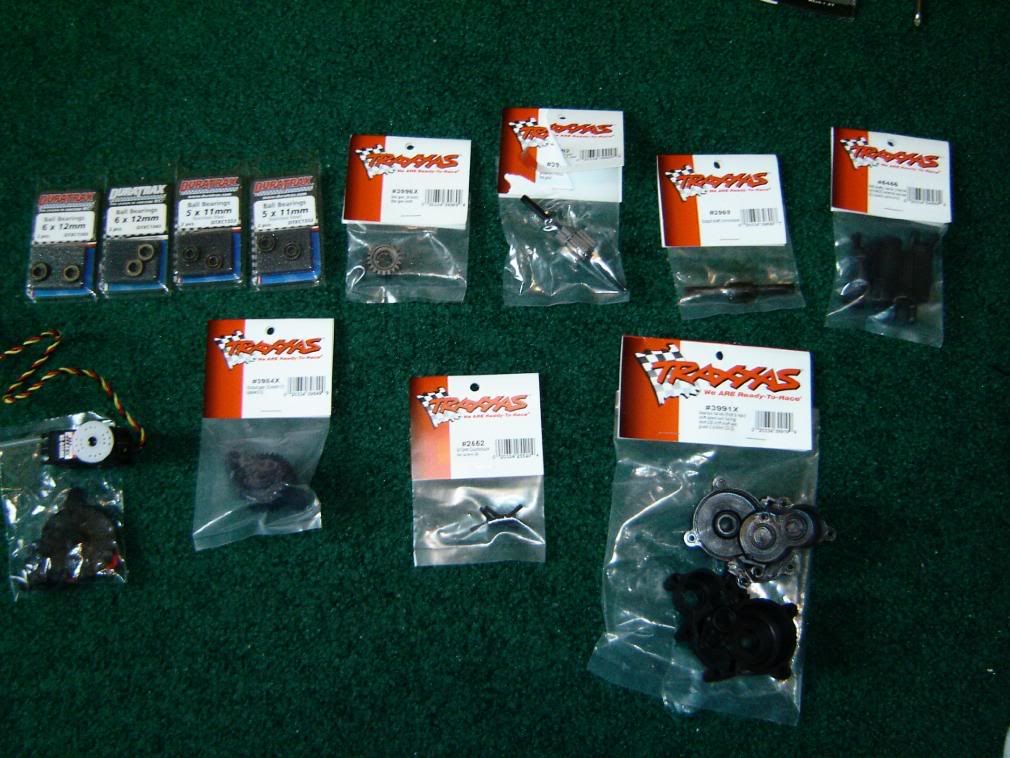

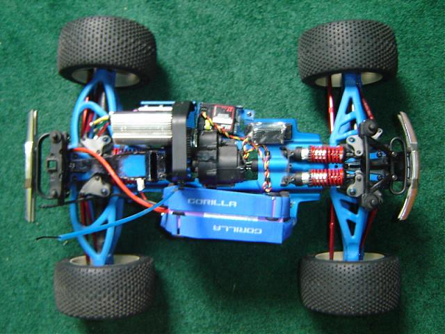

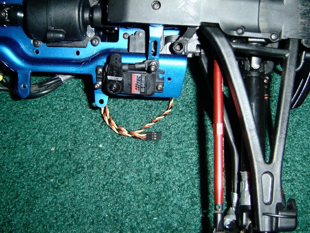

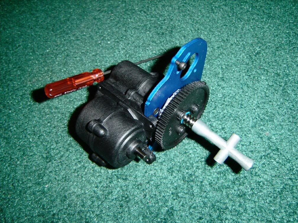

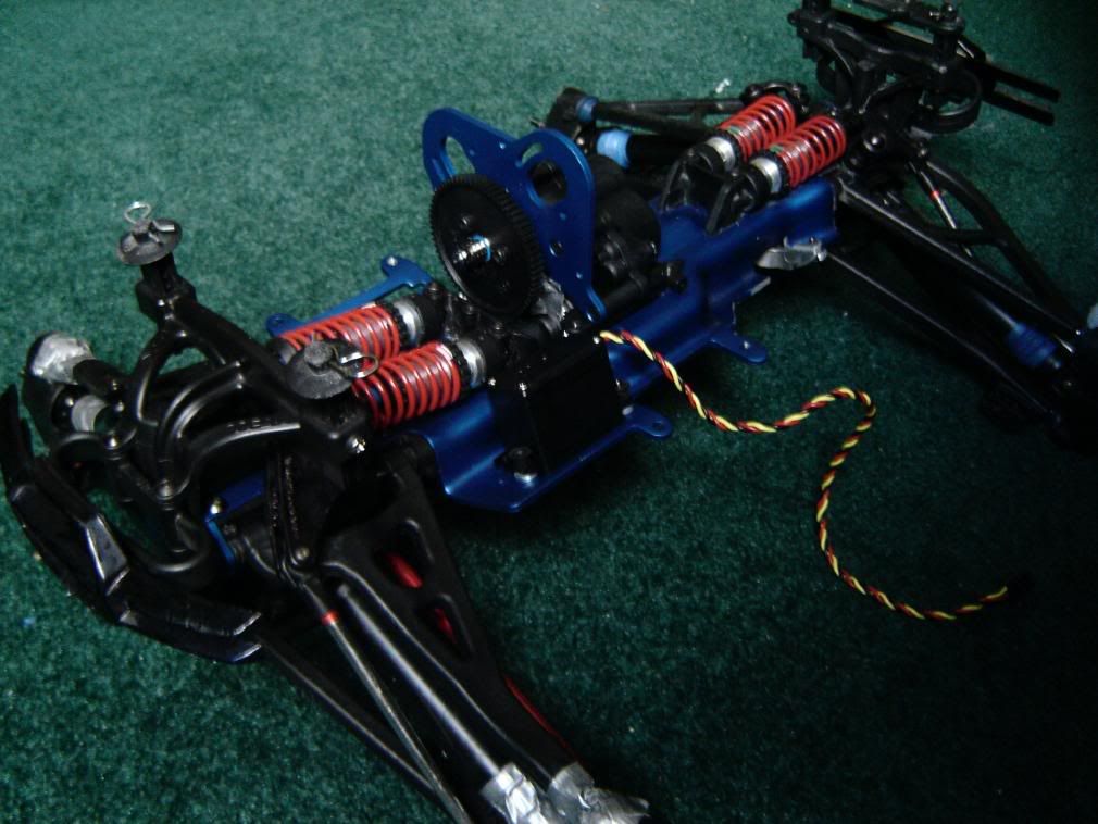

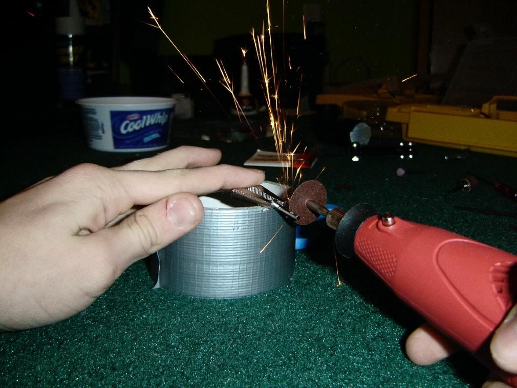

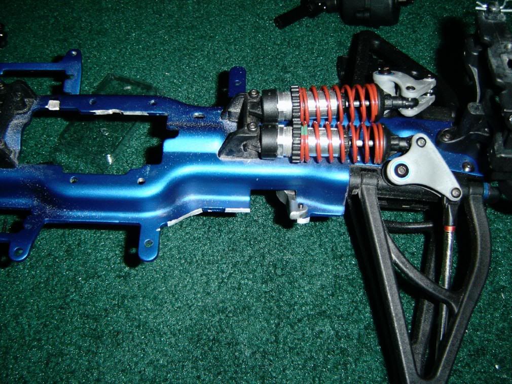

Here's pics of the Transmission install and build-up of the 2.5:
parts
gears installed
transmission finished
cut off the engine mount and some minor chassis shaving with the dremel
oooh sparks
servo installed
complete transmission mounted to chassis
Velineon, tires and wheels
with body

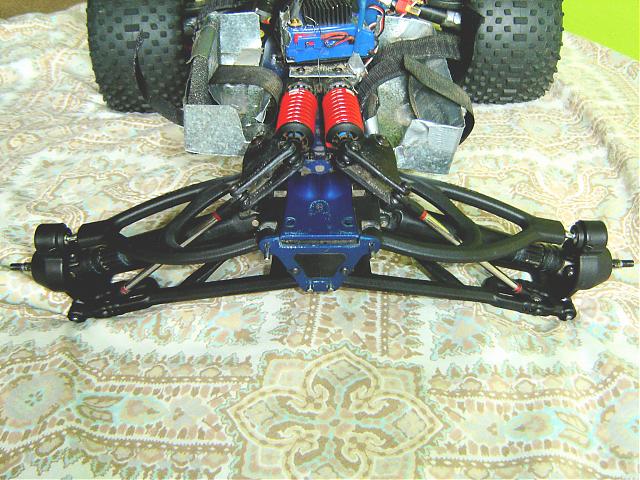

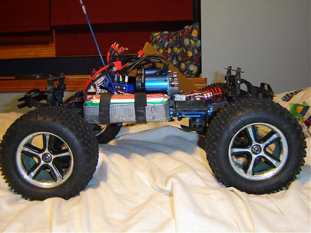

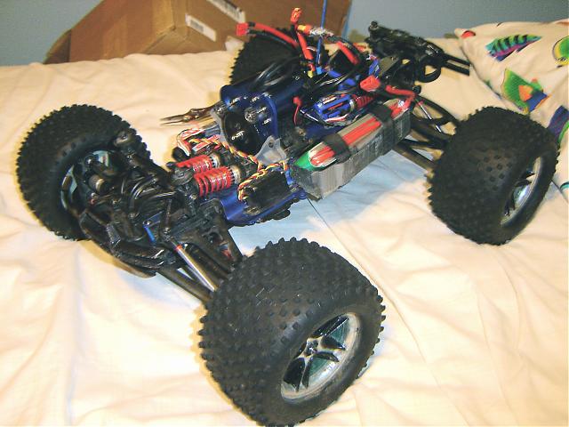

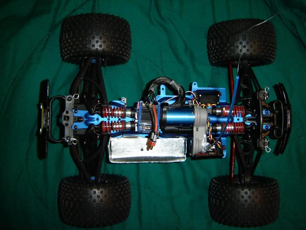

Pics of Revo 3.3 with the weight further forward, I had to bend the servo mount down to keep the battery low.
