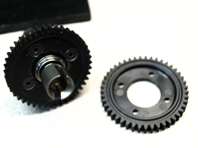

Some parts
Losa 3562 45t spur for the Losi 8 E. a mod1
I took a 43t regular HPI gear and drilled it out to match it up .
Spur pinion Ratio Total ratio 3s speed 6s Speed
49/14 3.5 11.5 28mph 56
49/17 2.88 9.5 36 72
45t/14p 3.21 10.6 32 64
45/12 3.75 12.4 26 52
45/13 3.46 11.4 28 57
44/14 3.14 10.3 31 62
43/12 3.58 11.8 29 58
43/14 3.07 10.15 33 67

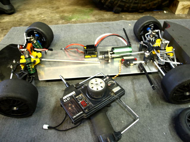

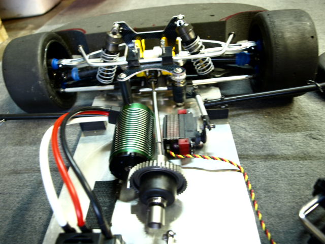

ANybody know of someyone that has adapted 1/5 wheels on 1/8 or 1/10 trucks ?
My way is a machining nightmare
Some new mock ups,

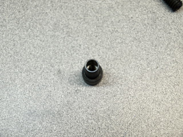

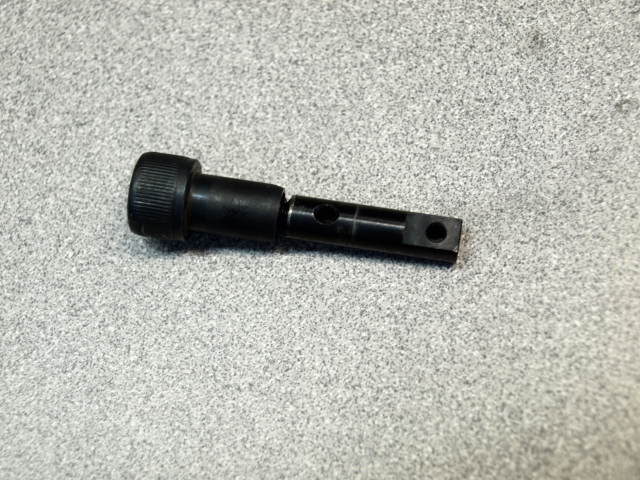

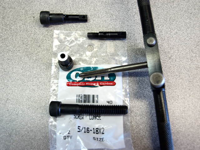

Making 1/5 wheel adaptors, square drive and some 5/16 wheel bolys to screw onto the trxxas shafts
For wheel adaptors, I used a 5/16 hex cap head bolt drill the center , cut the threads off, then Tap to 10/32 to match traxxas axle threas and then drill a 6mm 1/8 depth. Been a PITA as it does not always center, need a real machine
Making a tranny/motor mount out of Delrin, cause I dont have any 3/16 aluminum.
Since the car lifts the front under acceleration with just 3S , 15:1 ratio The motor will be mounted in the front almost centered
