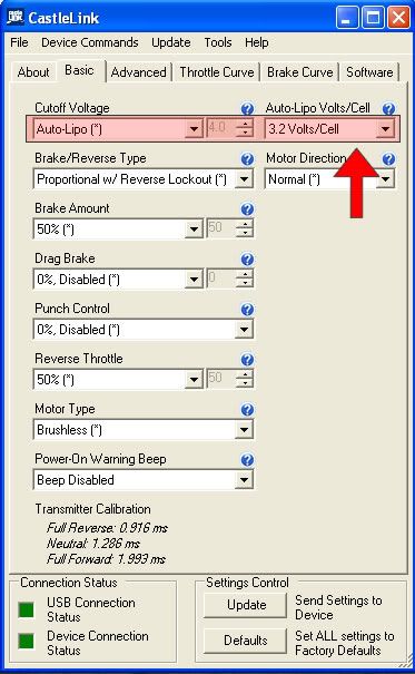

Ok im new to the MMM how do I set my lipo cut off to custom? I see auto an up to 18v but I plan to run 6s but I want my cut off at 3.1v per cell vs 3v how do I do this?

With the new 3.13 software under the auto lipo option is an option to change the auto lipo individual cell cutoff value.
