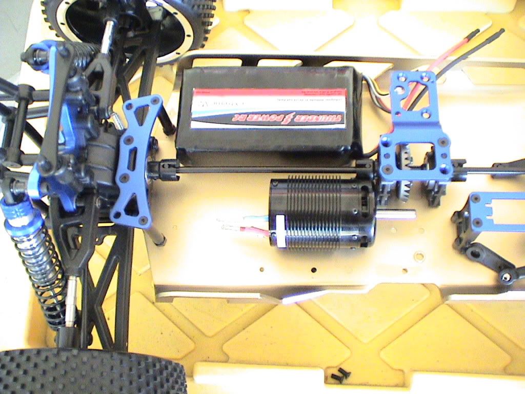

i weighed the chassis as a BL roller and it weighs 19.3 pounds. that was with the battery trays on it. so here are the other stats, according to memory.
servo: 2.5oz each. x 2
2215 Neu: 25oz.
NeuEnergy 5s Lipo: 22.5oz x 2
Hydra 240HV ESC: 7.7oz
So all together i get a weight of roughly 24.5 pounds. I am gonna add on another 8 to 16 ounces for wire, screws, mech brakes, mounting hardware for esc, etc. so the finished product should weigh in at 25lb or just over.
This is the first build i have done where i havent tried to shed weight and been concerned with weight.

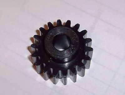

THE 8MM, MOD 1.5 pinions are avail on RCM now. i ordered a few for the conversion. also, i met with machinist to start on motor mount
http://www.rc-monster.com/proddetail...=rcmbajapinion
mod1.5pinion

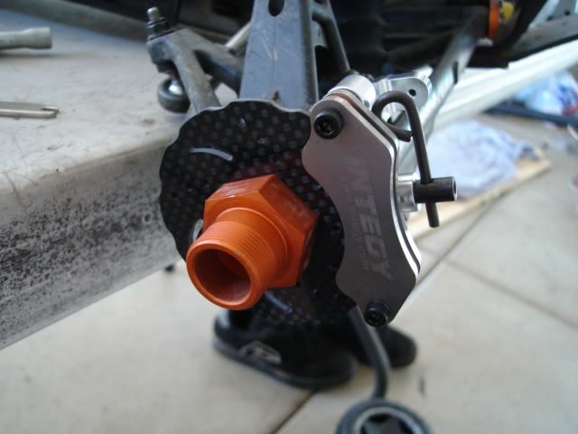

I say front disk brakes for a 5b.. not sure on the hex size but they sure do look sexy...
