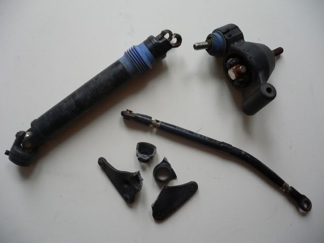

Nice! In what way did you break the truetrac knuckle? I see the busted shaft. Did you deform the hinge pin area on the knuckle?
  (#69)
Popoxx
Sapere aude
Popoxx's Avatar
Posts: 128
Join Date: Nov 2009
Location: France
08.29.2010, 06:22 PM
Eagle eye !
Only the driveshaft is broken, I just wanted to show the damn rust but it's hard to see it in fact... The hinge pins are really big I've never bent one !

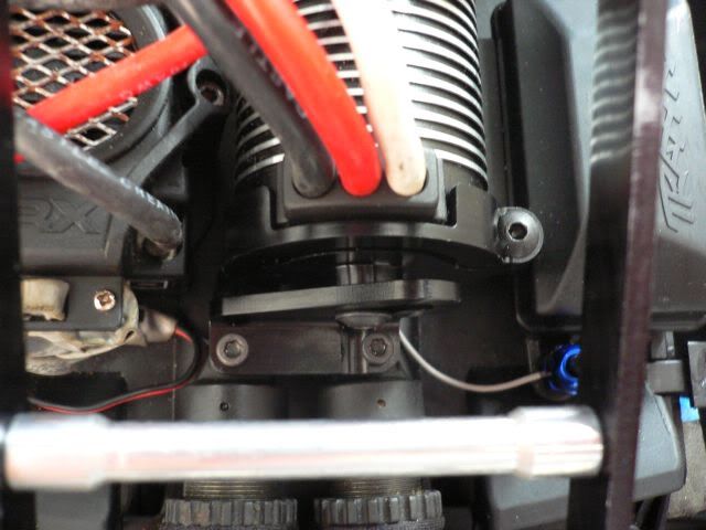

HPP motor bracket
  (#70)
Popoxx
Sapere aude
Popoxx's Avatar
Posts: 128
Join Date: Nov 2009
Location: France

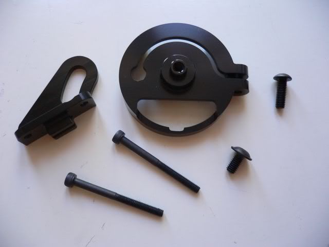

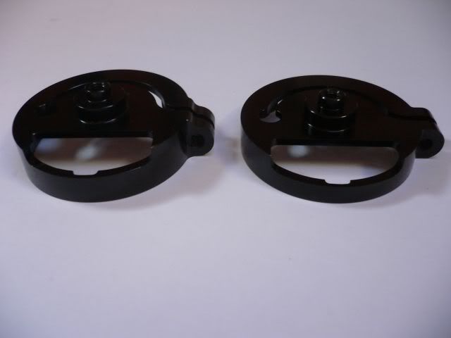

HPP motor bracket - 09.19.2010, 05:59 AM

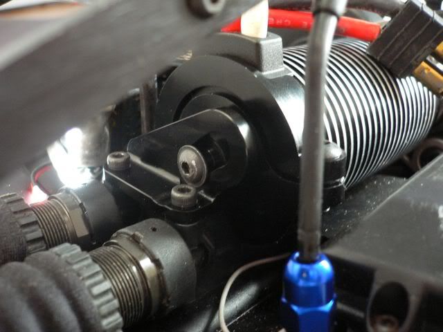

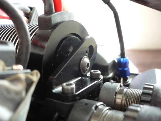

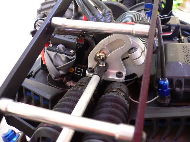

The new version of the HPP motor bracket is finally available ! The waiting was quite long but I'm really not disappointed I installed it yesterday it's a work of art. Ingenious design, perfect fit, high quality components and beautiful black anodizing
Previous version :
New version :
It's worth it !

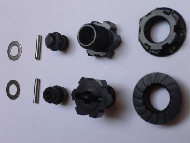

I finally found the time to install the HPP wheel hubs and updated bracket ! :D
Wheel hubs

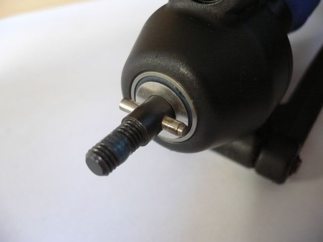

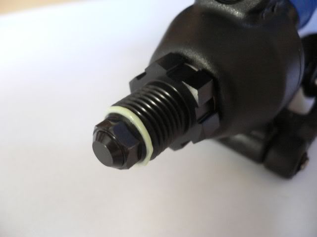

Here is the result, step by step (as usual ) :
Washer, axle pin, thread lock.
Hub.

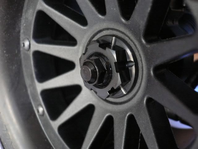

Center nut with grease.
Wheel !

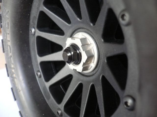

And tadaaa :
Bkack wheel nut.
Desanodized wheel nut.
And of course, absolutely no slop

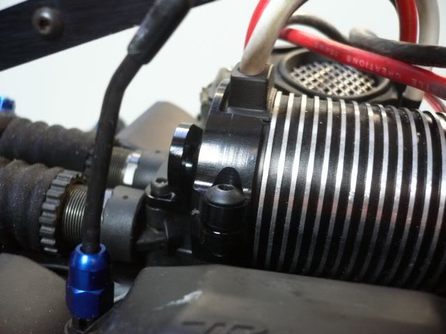

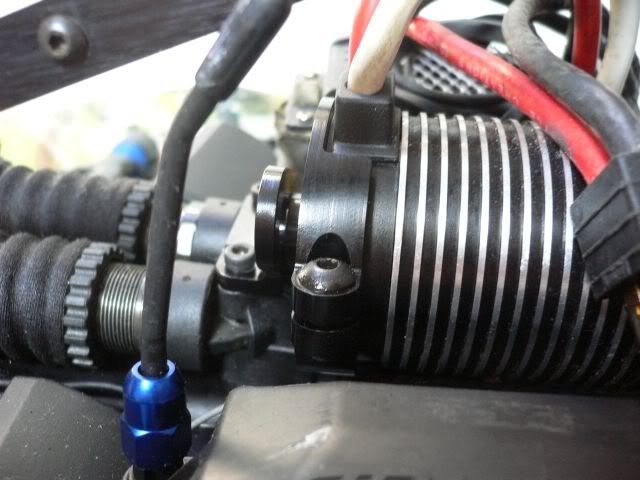

Updated bracket

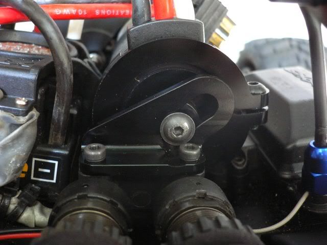

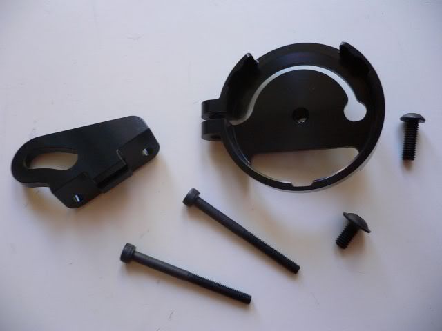

Some people have had problem with the first version, the motor mount popped off during hard landings.
So HPP released a second version, larger (on the left) :
Before :
After :
Now I have to trim this E-Maxx BL body to bash my revo soon ! (as soon as I find a nice spot around my new city)
