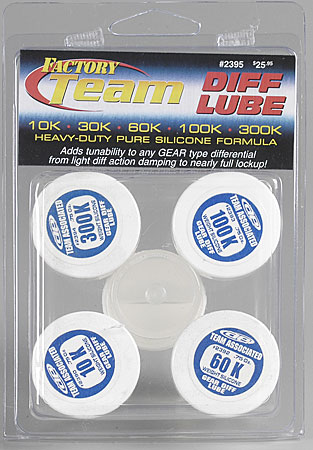

Would this do the job? I could not find a 80wt for the front.:

What's the difference between a 1000 and a 10000 and a 100000wt? how do they affect the performance of the diff?

The stiffer or higher number means less diff action. The thicker oil tries to make sure both tires turn closer to the same speed.

Well, what weight of diff oil do you recommend for a truck with full aluminum parts and a 1950 motor as well as 20 cells of batts? I want it to be fast and controlable.

7 k front 5 k rear.

You mean 7k= 7000 or 70000?

k = 1000
