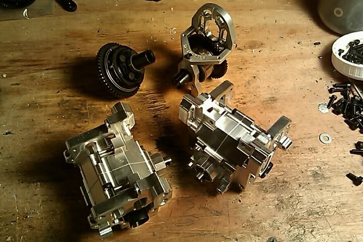

So far I have most the parts I need, with a few others already for fun. I'm going to go w/ the FLM bulkheads I have w/ BP diffs. I know the draw backs, but going to run them. Also have FLM towers w/ LST shocks on my current XL. The setup is good, but heavy. Plus the shock shafts for the LSTs tend to break at the thread alot. Had these before BB flux shocks came out, so may explore better shock options.

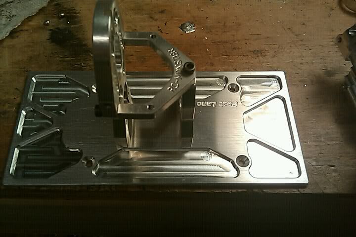

Plan to mount CD to a skidplate. Here's one from FLM I intended for my XL before I decided to go XXL. for reference. Will likely do my own, so no fancy machining :(

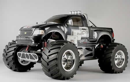

The wheelbase is longer than the XL, but shorter than the baja (590mm.) Basically I'm going for a FG/Redcat Rampage size. Been really digging the Monster Beetle look:
But the MT option is always cool too:

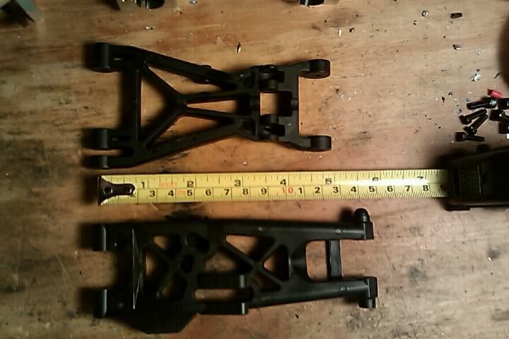

Also, I've been looking to extend the arms out, but the only option I've ever seen was the alu arms from FLM. Eh, want to stay plastic and easily replaceable. I was shown a thread recently of someone who fit CRT X2 arms onto the savage. Cool. Will explore option. Here's a comparison of the arms from my Hyper ST. Over 3/4" gain ea side. Very strong arms (busted many sav ones) bit the arms are too close to fit.
