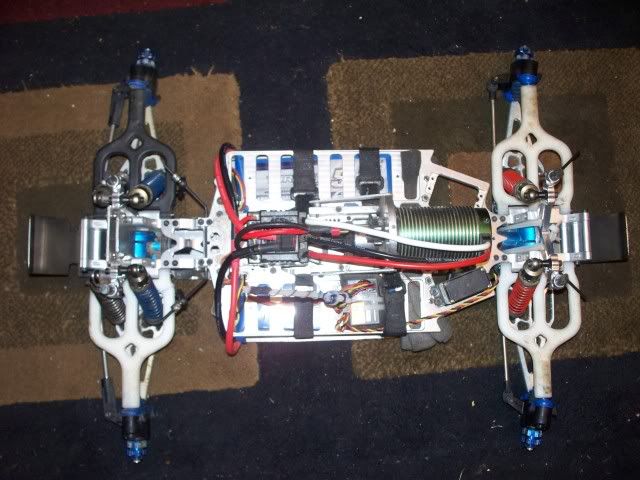

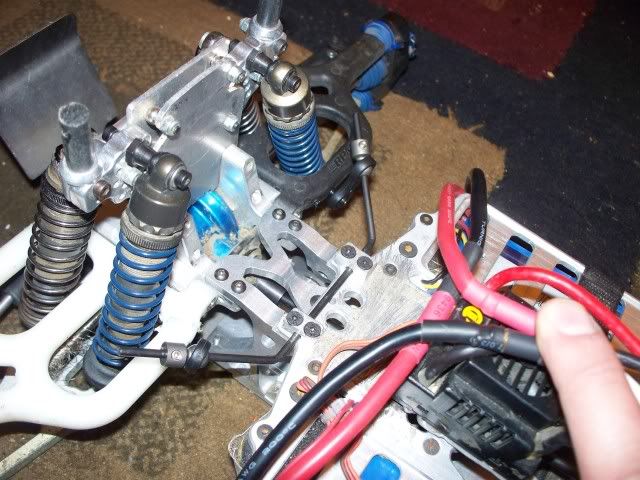

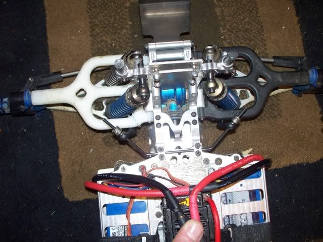

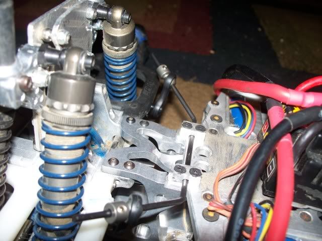

Simple 6061 block. using existing screw holes in the chassis and a notch for the bar to go through. Then just drilled small hole in front of arm and screwed in the Pivot point. Very easy
Photobucket
Photobucket
The front wont work this way so I will rethink that one... But I think the rear came out good...

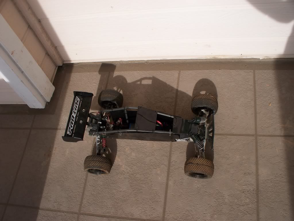

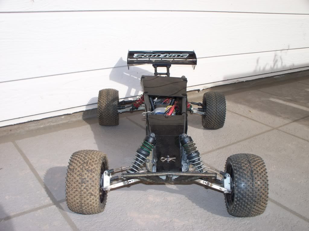

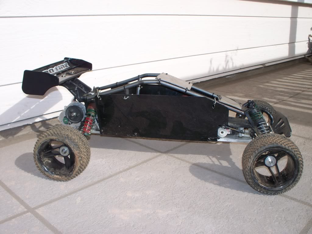

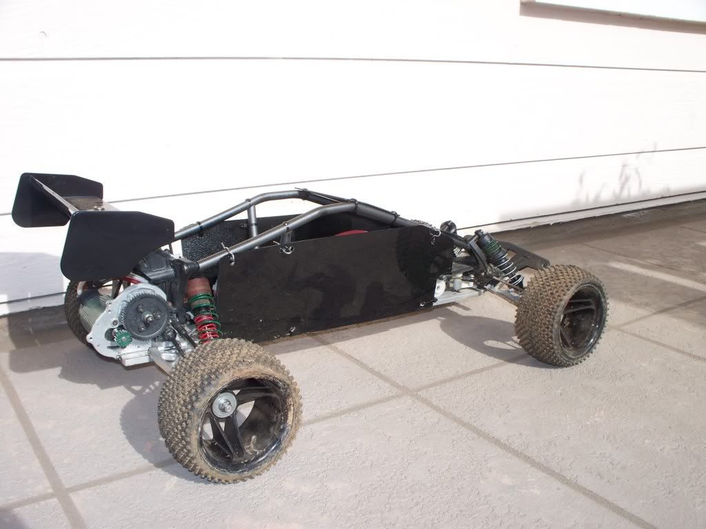

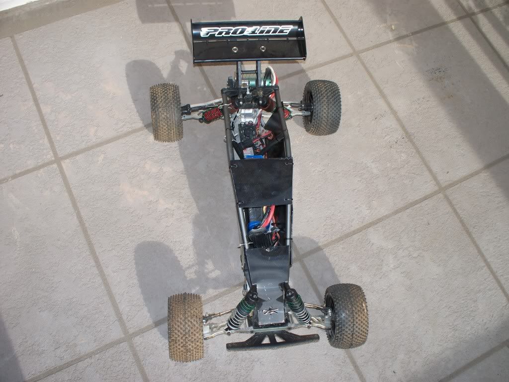

Just some pics of the roll cage I made. It'll keep the dirt out that for sure... It actually drives really well, I had to make a shock preload spacer out of some 1" PVC and it didnt take the black dye well at all... But it was free and sets the spring rate just right...
Photobucket
I made one side panel able to fold down so I can get the battery out from top or side and use 2 hands doing so... See clips here:
Photobucket
Photobucket
Photobucket
Photobucket
I will get some better shots of how its all connected later, I will have to pull off one panel and solder a new UBEC and get rid of the RX Pack. Almost finished...

Cool rig. I was concerned at first with the length you were stretching it to, as I didn't have the greatest results with my last stretch chassis project. Glad you're happy with the hangling. Its funny seeing those big ass shocks on that truck though! A little suggestion, instead of body clips for the side panel, how about reusable zip ties. Body clips tend to get lost in rollovers, and those reusable zip ties won't take much longer to install/remove.
