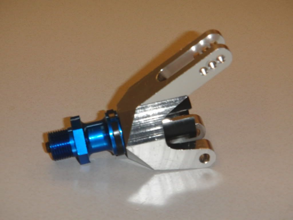

You're right. It was very difficult with a drill press. The fact the hubs have 6 sides makes it impossible to clamp them in a vise with the pin hole vertical. I gave it a shot anyway. Some of the 17mm hub pin holes got a little widened (either due to bit wobble or some other crap), but I think they should hold up. I only had one pair of hubs at the time with another set on order. I'll have to drill those hubs out a little bit for the pin to fit and only time will tell if it all holds up.'
Anyway, here's one done.

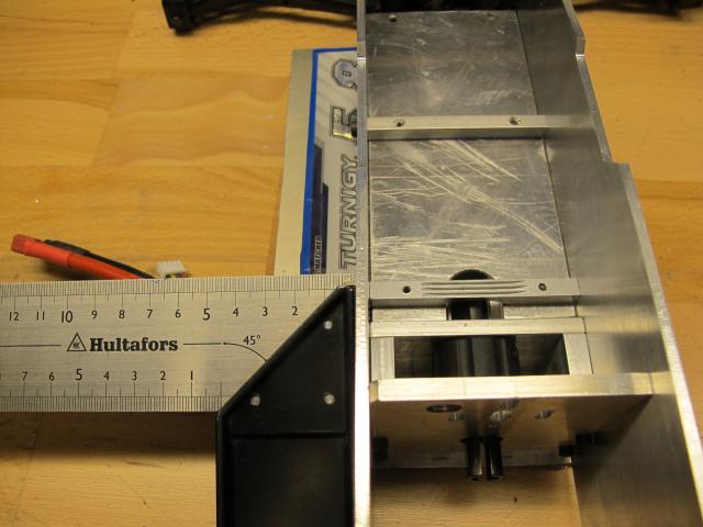

I guess this build ended up in a quest for a god damn low CoG... did we get there?
Well, for a Savage Id say we did :)

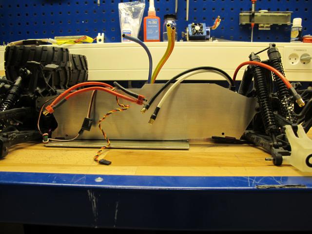

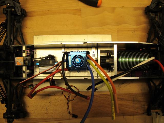

Motor, ESC, Servo, 2,4GHz RX placement:

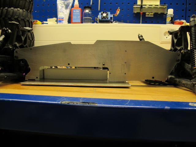

The battery compartment in spe:
The cut outs in the TVPs will be 155mm x 32mm... thats enough to fit most LiPo's out there... horizontal of course
Hmm lol the frontal part is sitting upside down... the dogbone cut out is supposed to open the part in the top... good morning! ;)
Judging from rough mock ups the balance of the truck is pretty good... slightly tilted forward... but only slightly.

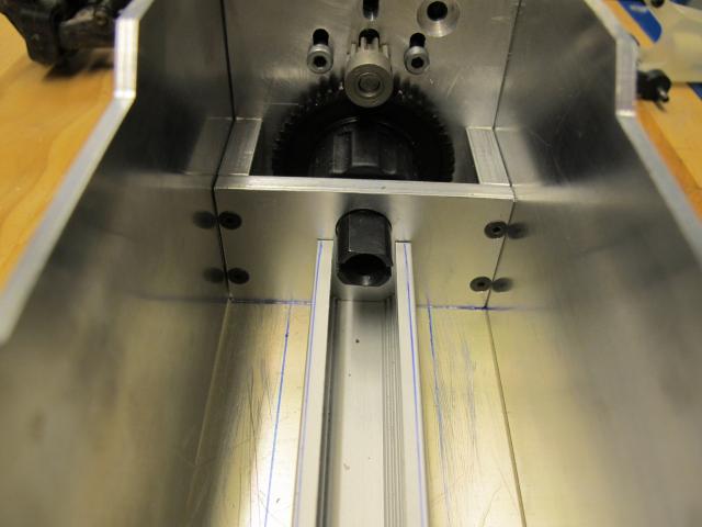

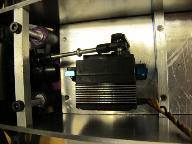

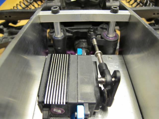

The batteries will rest against the U-shaped alu part in the center line... which will protect dogbone from bats or is it the other way round? 10T pinion fitted on the motor :)
Servo setup:

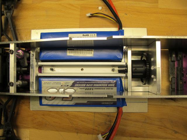

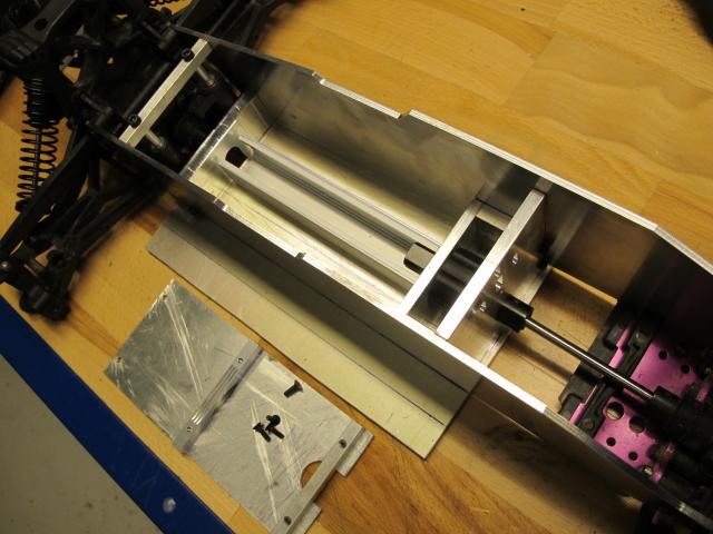

Finally got around to it... TVP's cut to allow horizontal battery placement:
Batteries inserted:
They protrude 2 - 2½ cm to the sides:
Im thinking that two vertical straps going from the skid plate to the TVP might be the best way to secure the bats...
Another idea is a "gorilla style" strap going from the front of the cut out to the end. It should push the batteries inwards and against the U-shaped dog bone guard.
Need a bit of counter sinking, final servo placement, wireing and a custom dogbone... then Im good to go :)
Ohh... also need to drill the side holes in the CD mount and thread them... 12 m3 screws should hopefully do it!?
