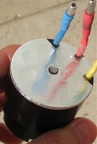

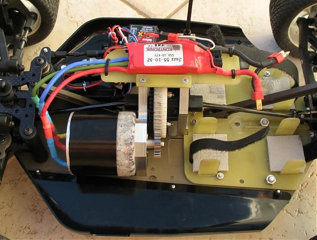

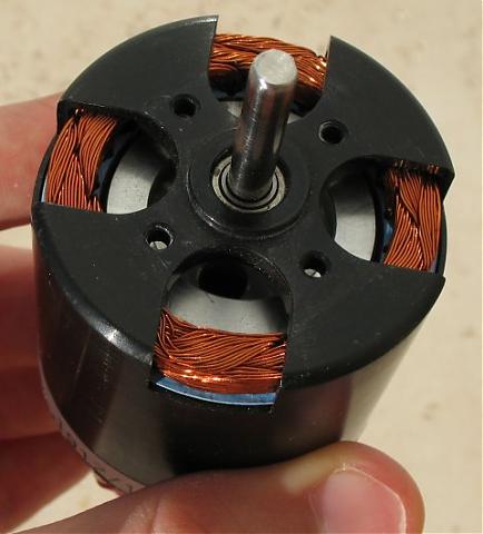

Hi all,
I finally got around to sealing my motor. I made a front cap up of fibreglass which turned out really well. Fits like a glove and only 3 grams. Should hold up to heat too.
Taking a short cut for the motor's rear - just some aluminium tape. Not sure how the contact adhesive will hold up.
I'm hoping to take some nitros on on the track. :)

  (#71)
11.24.2008, 08:07 PM
Very cool. Are you planning to make a video?
  (#72)
Aragon
11.24.2008, 08:24 PM
If I can find a camera man, definitely. :)
