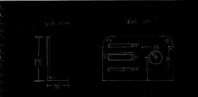

my layout is going to be just like lincpimp's. I didnt quite finish the motor mount today at lunch break gonna try and finish it tomorrow heat treat it to T6 on monday. i changed materials today when i started im using .100 7075-o which is untreated and will allow a sharp bend and then can be heat treated to T6. Which is gonna be very very strong, it will attach to 4 points on the bulk head and two places on the chassis (again overkill to have 6 mounting bolts). I do have my drawings i did for it today ill get those scanned and on here for you to see along with some pictures. Wish i had a spare couple hours at work one day to cnc a few of these, our machines programing are setup like autocad so its easy to program if you know autocad fairly well. My battery and RCmonster heatsink/clamp should be here this week also.

sorry the motormount sketch didnt show up very good, i inverted the colors so you can see it better and two of the mounting holes arent shown either.

looks good. i started something just to get me going, but i'm sure its not as strong, or as good looking. i'll post pics when i get it on there if it works out. i have to use hand tools so its more crude. how hard do you think it would be to reverse your mount for the other side? maybe just make the L face the other way and its done? i can't remember if the center diff supports are simmetrical.

they are simmetrical but the lower mount holes in the L portion i think would have to be longer to make it back to the nitro motor mounts, i could make one like that, or just draw it up for you if you wanted. i gotta get off here and go finsih mine before my lunch break is over.

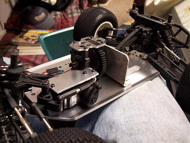

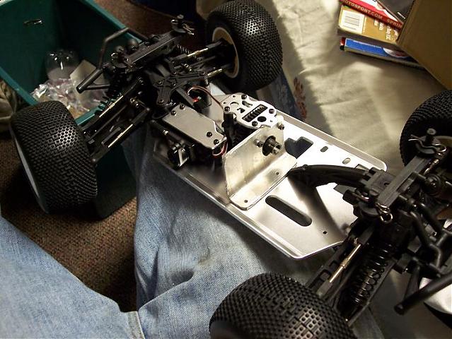

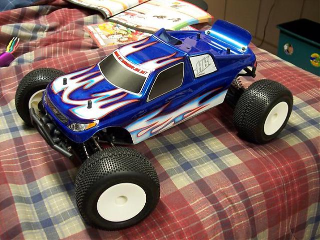

For the tires, I just ordered the HB rims and put on the Snake Eyes. I looked at some Losi rims and they fit, but don't have as much clearance as the HB's so I didn't risk it. As for Springs, I ended up using some threaded shocks and springs from a Duratrax buggy - just the rear ones. I think you can use the Losi ones too. Here's some pics of mine when I had it:
