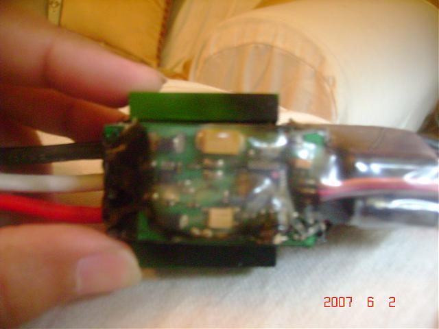

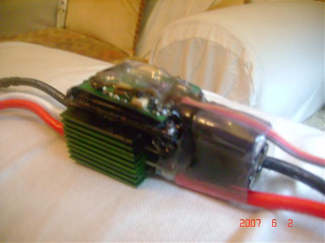

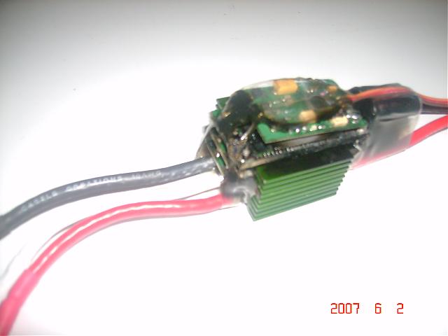

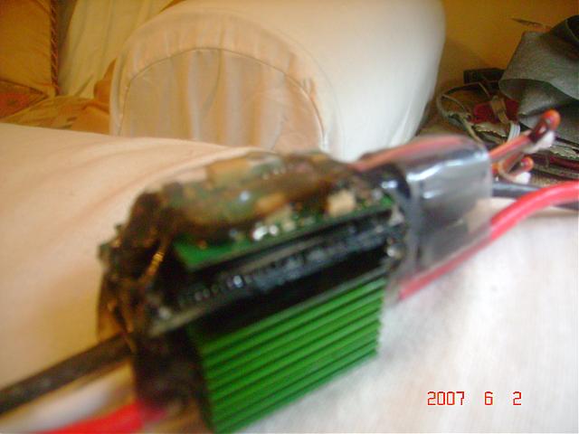

I tried the HV110 and it failed. In another forum, the Heli guys are saying the HV85 and 110 are failing as well.

There is a couple of other, but this one was the most recent. I have to say that the HV110 did work for a couple of runs and it is smooth. One day it just decided to let some smoke out.
Name:	Fried HV110a.jpg
ID:	3415   Click image for larger version
Name:	Fried HV110b.jpg
ID:	3416   Click image for larger version
Name:	Fried HV110c.jpg
  (#66)
lutach
lutach's Avatar
Posts: 5,139
10.28.2007, 09:26 PM
one more pic
Name:	Fried HV110d.jpg

Here is a link for the heli guy that I was talking about:
http://www.rcgroups.com/forums/showthread.php?t=729737
Holy smokes, what were you running this on?
Was that on your BPP geared for 165mph?
I wouldn't recommend running these hot. My HV's are ~100 deg F after a 20 min run.
The Heli guy issue sounds like an isolated incident as he reproduced the fried esc multiple times. He's running 10S at 85%, maybe he should just run 9S at 100%
I've been running my HV's for a few months anywhere from 5S lipo to 10S A123's geared for 45mph. So far, no problems at all.
The time I fired my HV110, I had changed the spur back to 65T and a 22T pinion. When I had the 51T spur and 30T pinion, the controller was a sample unit from the person who is doing or trying to do my 200A controller. I did run my truck before getting my DPR with one 36V pack and my Jazz 55/FUN600-17 combo and it ran great for some time.
