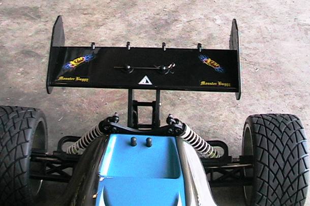

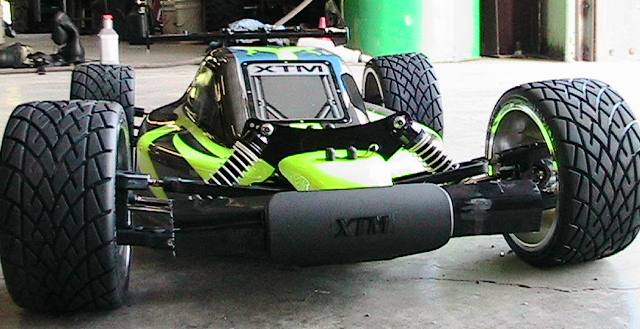

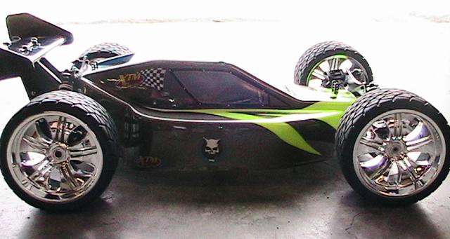

New updates on mods done. Car is now SLAMMED to the ground, wing modified for high speed passes and front bumper modified with radius curved deflector for high speed. Soon to have some video passes

Wow. That looks awesome. Looks like it's going 100mph just standing there. Can't wait to see some vids of it.

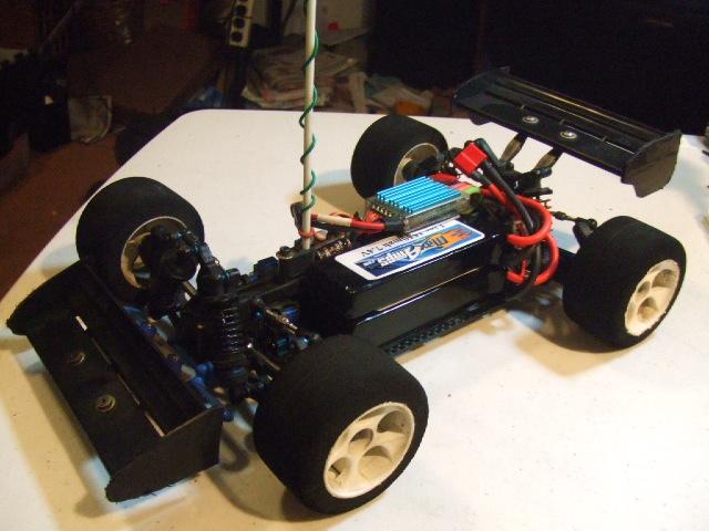

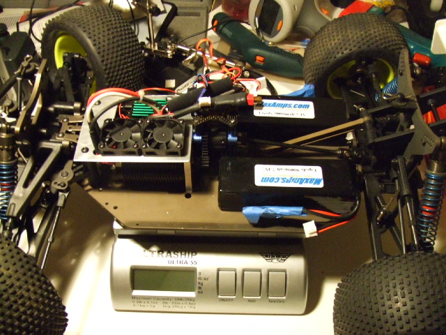

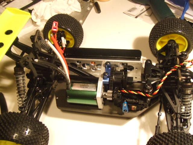

Layout wise I found in my CRT conv everything fit and was ballanced running the 1515 motor forward and duel packs in the back? pic 1
On my CRT.5 conv I tied the motor mount into the battery mount that runs from the front of the chassis to the rear pic 2 I found this eliminated just about all the chassis flex and made the car alot more stable at speed vers a friends CRT.5 with a std motor mount? If you can incorporate a mount like this in the XTM with it's exessive chassis flex it will help keep the car going in a straight line at speed.
Weight? get rid of as much weight as you can my CRT weighs in at just a little over 11lbs RTR with 2 8000mah packs you should be able to come in under 13-14lbs RTR?
Just a few things to think about when you are laying everything out.
BTW What KV 1527 motors did you end up getting?

Running 2 1.5D's. Will be running 12S through each motor.....so both will be spinning WAY over RPM's.....probably not good , but I will try it.
