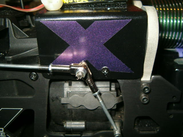

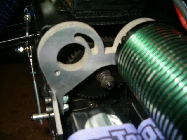

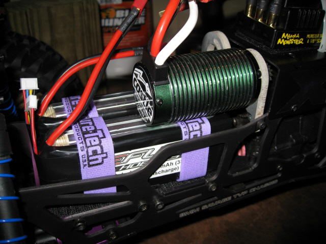

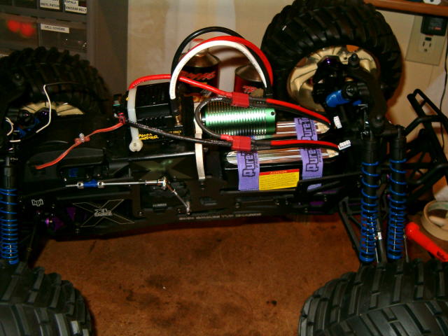

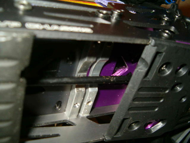

Hi, I just found this post and thought I'd share my project. I'm running on 6s power with a locked 2 speed tranny. I locked it by using my mig welder and tacked a weld on the arm to hold it in place. I'll take a pic next time its apart. This truck was a Savage SS on gas last year, but I caught the electric bug and made an BL XL conversion. I'm still running the manual fiber brakes and also steering from the hump pack. I thought it might save me some power, and I've read that it can keep the motor as much as 30 degrees cooler. So far I have'nt had any tranny problems. I'm running a 47 spur with a 15 pinion and can still do standing backflips. I wont claim it can do 60 with this pinion, but It is a lot faster than my Savage SS on gas so I'd guess Its around 45-50 mph. Id love to run the direct drive, but I dont think my packs will fit with that set up. Thats partly why I changed to an XL chassis. (to hold packs between TVP's)

tklemin: Very nice looking build! Im working on a savx conversion of my own and had considered getting the XL plates. The only thing Im wondering about yours is that if you did mount the batteries on the sides of the TVPs with some kyosho battery trays (very nice looking), you could mount them lower in the chassis (and towards the front a little for better weight distribution) and then mount the motor much lower. Overall improved center of gravity.... But if you arent too worried about that your setup is absolutely perfect. Love the XL look... youre tempting me to sell my new X plates!

Awesome! have to say that those genesis wheels match there prefectly. What's up with that other motor plate or is that a motor plate, cant really see all of it.. Planning to stick another motor there?

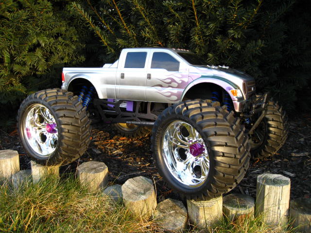

Thanks for the props. I was trying to make the baddest truck Ive ever owned. The motor plate is from KD. It just has a double mount for brushed motors I guess. The weight distribution probably could be a little better, But the batts still sit pretty low in the truck, and I still have the hump pack in the box that evens out a little. That was part of the reason I used the XL chassis. I figured the the longer chassis would even out the weight of the more rear weight of the batts. I just like the look of the batts tucked in, and it might ad a little more clearance under the truck and protect the lipos also. It drives great (not to flippy). As with most 6s trucks it takes a more dialed in throttle control than with gas. It took a few charges to learn to drive again. With my gearing It will still do standing back flips, but its not to bad after half speed.
