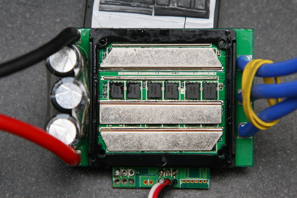

I don't get it, so the 150A and the 80A has the same MOSFETs!!! Do you have pictures of the MOSFET board of the 150A?
No, the 80A has 18 FETs, and they are different part numbers too. This is what leads me to believe there is an extra 12 FETs under the heatsink that is glued down in the 150A...

Ok, my fault. The 80A has the DPAK style MOSFETs and the 150A has the same MOSFETs as the Tekin R1/RS and maybe the Mamba Max and Mamba Monster. I apologize for my mistake.

Just because I'm such a nice guy I went to look again, took it apart. There are TWO banks of 6 FETS on the other side of the brain board. Thats makes a grand total of 12 as I said before. Did not take the heatsink off(think they glued it). BTW: The semi transparent bottom part is not sealed well - i dont know why they bothered with the rubber seal because there is a large hole in an obvious place.
03.04.2009, 07:21 PM
Yeah, page 3 clearly shows the 12 FETs under the heatsink. I think there is an extra 12 sandwiched between the brains board and the power board, like there is with the 80A. That would give the 150A 24 FETs, which would make MUCH more sense...

The 150A uses 36 MOSFETs, ON semi's NTMFS4833N(the MMM uses NTMFS4108N).
Here's my picture.
On the top side of PCB: 4x6 = 24 FETs,there are two more rows underneath the power PCB, 2x6 = 12 FETs. Note the way the heatsink touches. Looks like HobbyWing was trying to cool the PCB, not directly the FETs (to take care of the ones on back side maybe? ).

03.05.2009, 01:28 AM
Here's my picture.
Very nice......matches the MMM.

03.05.2009, 10:42 AM
Here's my picture.
Now that makes more sense. 36 of those FETs more than meets the 150A spec. Those metal bars attached to the PCB is a good idea IMO because the PCB carries the majority of the heat (heat doesn't travel as well through the plastic FET casing as it does through the leads).

03.06.2009, 07:25 AM
Yes, the metal bars act as a heat transfer, as well as a current flew path, a smart design.

Did anyone actually look at the current rating of each FET?
MMM --> NTMFS4108N = 30A x 36
HW --> 150A NTMFS4833N= 180A x 36
WTF?
