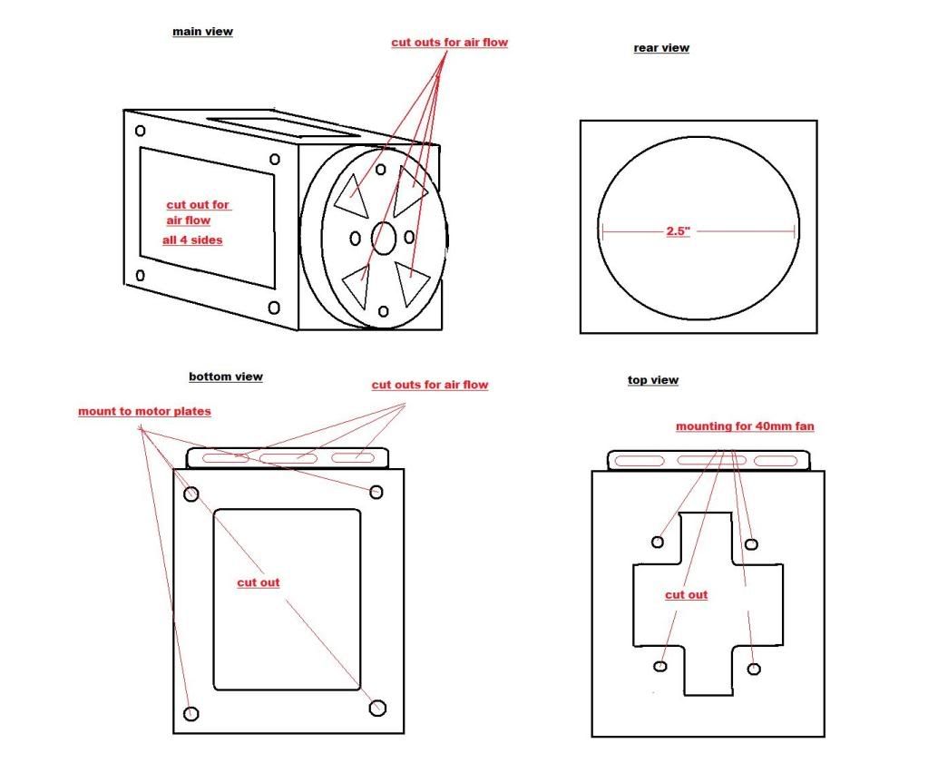

i have been looking for a free CAD type drawing software online. if anyone knows of anything please let me know. right now i have just been drawing with MS Paint which is a joke. but its good enough for my machinist to work from but i would like to just design everything so its ready for the CNC.
here is a rough draft of the motor mount. i havent put in any dimensions yet but you get the idea. i will post some pics of all the brake components and setup i think i will run soon.

Looks like a solid design. Holy crap those brakes are EXPENSIVE!

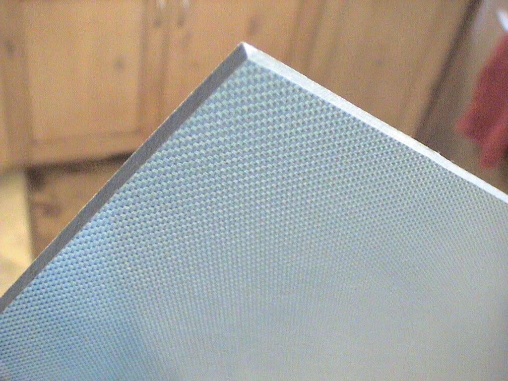

so i got this new 4mm blue carbon today. it is 4mm 1k fineweave which is super tough and an outer layer of blue texalium on each side. texalium is an aluminum cloth and the stuff used for fishing rods and other sports equip.
i got this stuff cuz it became apparent that i had to move the front chassis brace to the right side of the drive shaft so the motor mount could sit where it needs to. since i had to move the chassis brace i decided to make a new front top plate. and i most likely will have to make a new center top plate if i go with the mech. brakes off the center diff outdrives. so this blue carbon should be tuff enough and looks cool too.

you can see in this pic where i had to take off the chassis brace. so the new top plate will just mount the brace to the other side.
redcat20
Cant you just flip front top plate upsidedown? And use different bolts or countersunk washers? Wouldnt it fit then?
So that front brace mounting hole goes to right side of chassis?

that could be done but it wouldnt be very clean. all the holes on the top plate are countersunk so flipping it over would put the countersink on the wrong side.
the carbon setup is going to work beautifully and look stellar too. i actually should have the carbon parts done today. i will post pics soon.
