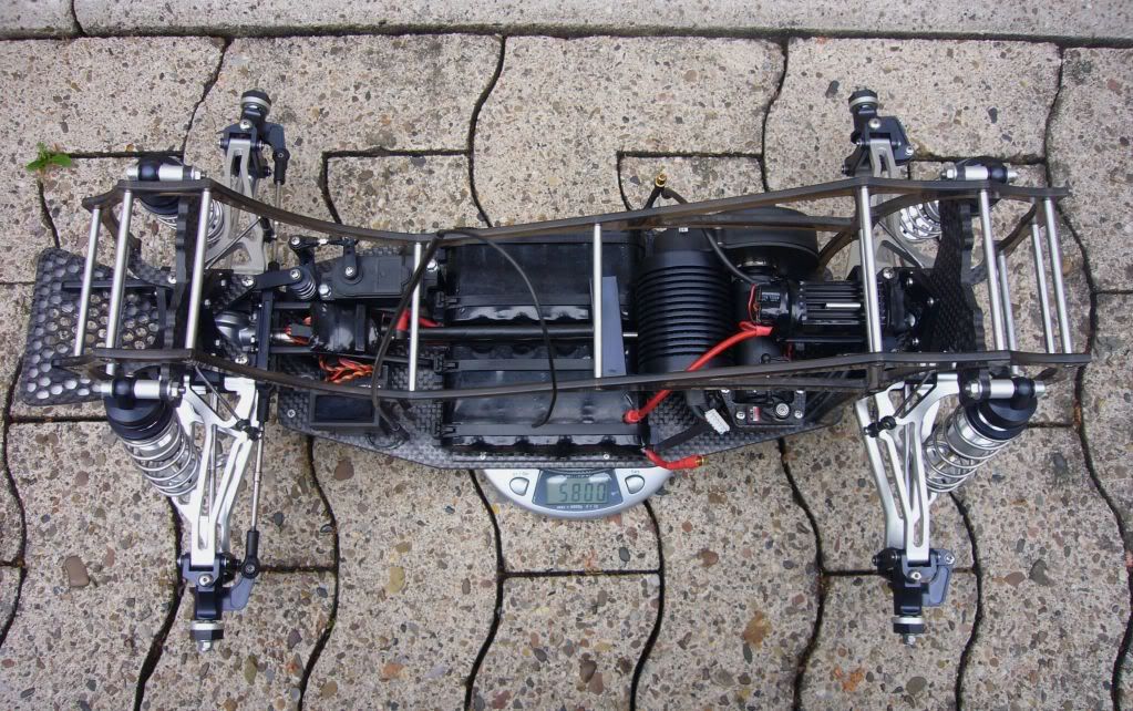

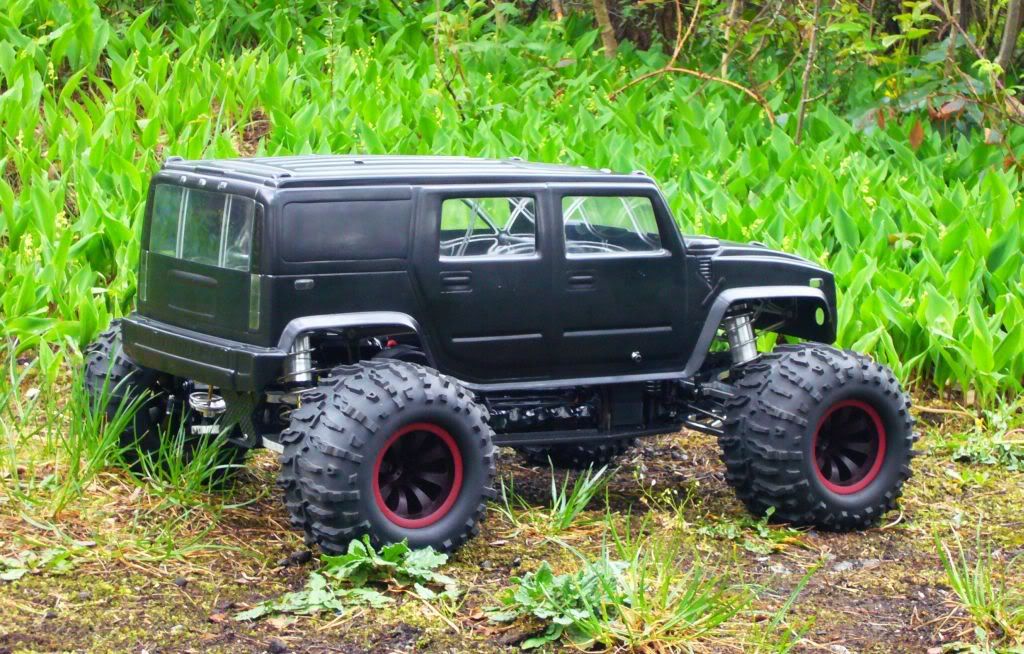

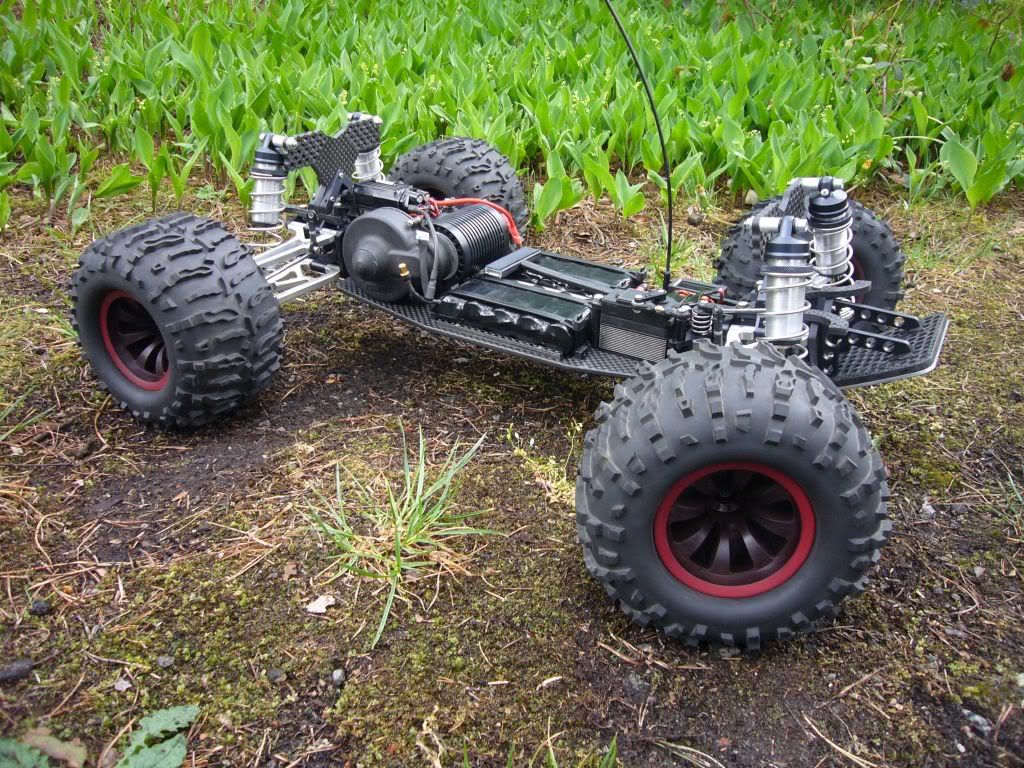

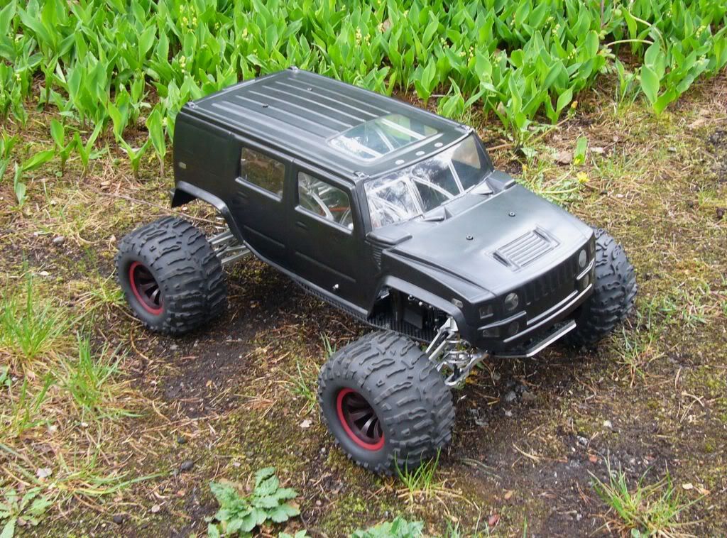

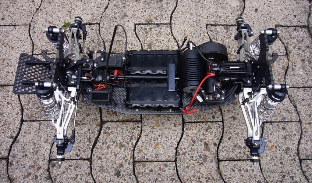

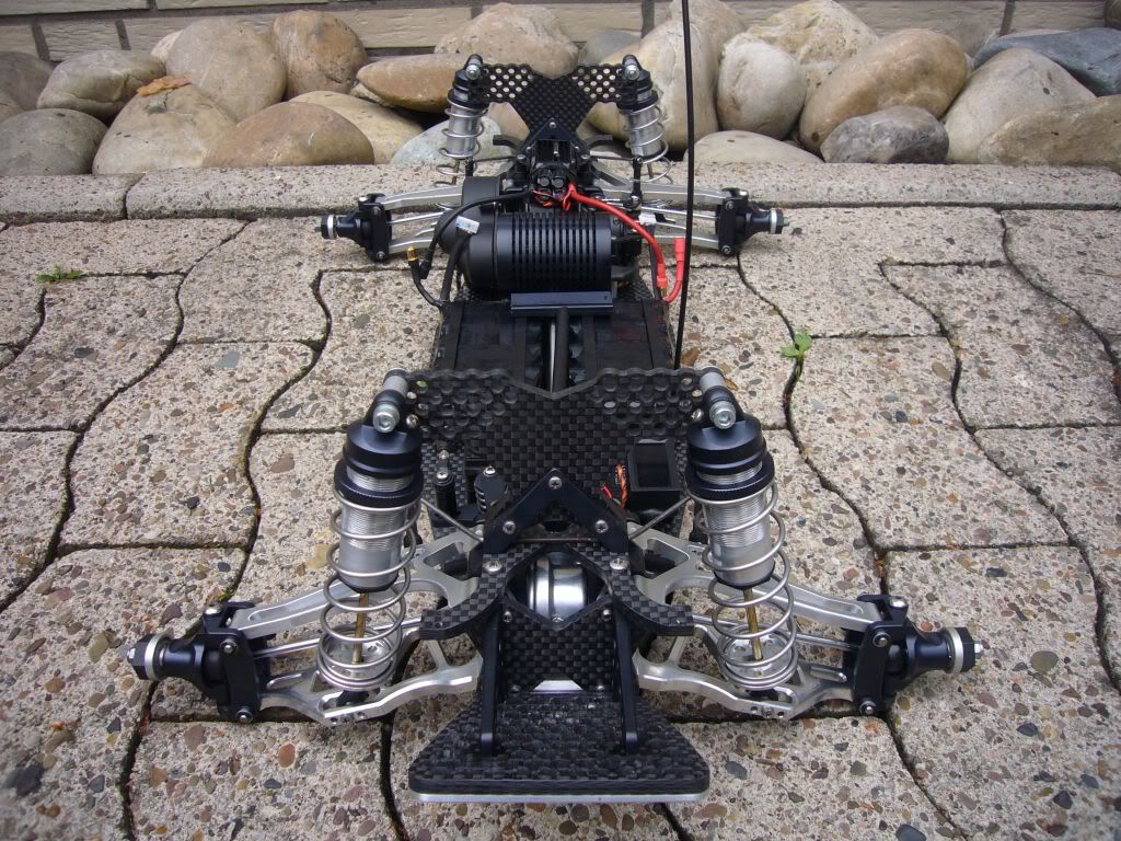

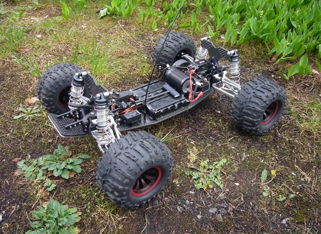

Almost done

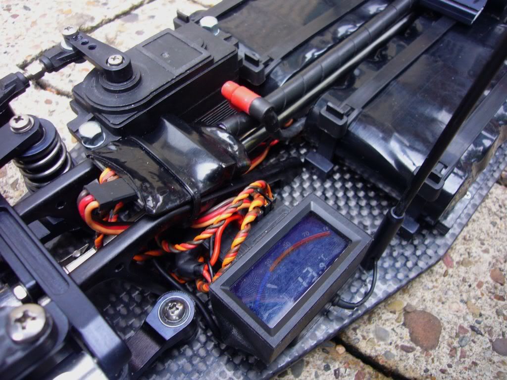

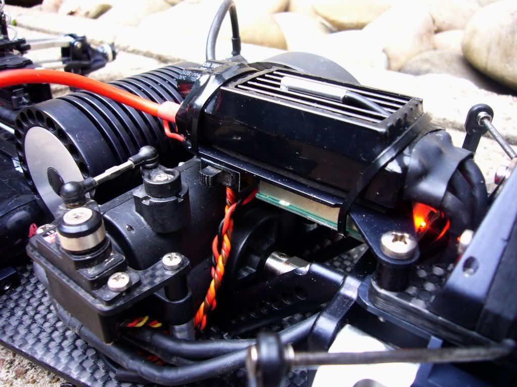

Some srews are replaced by M4

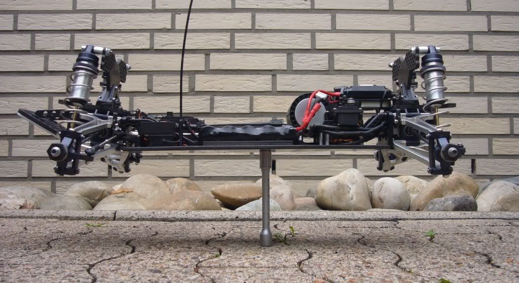

even the balance point is on the right place I think...
All straight, many black parts
Temp-Display on receiver and in the middel the LiFeDiMatic
The ECS whit temperature sensor. Under it the Ultimate-BEC

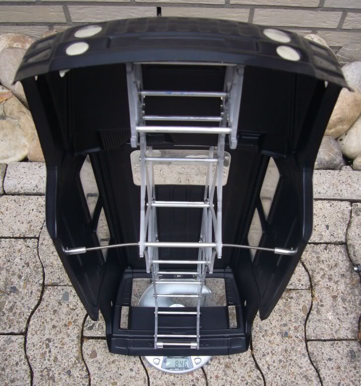

weighing:
either
or
5800g - RTR Chassis incl. small Cage
1112g - the lightest Wheels I have
thatīs 6912g

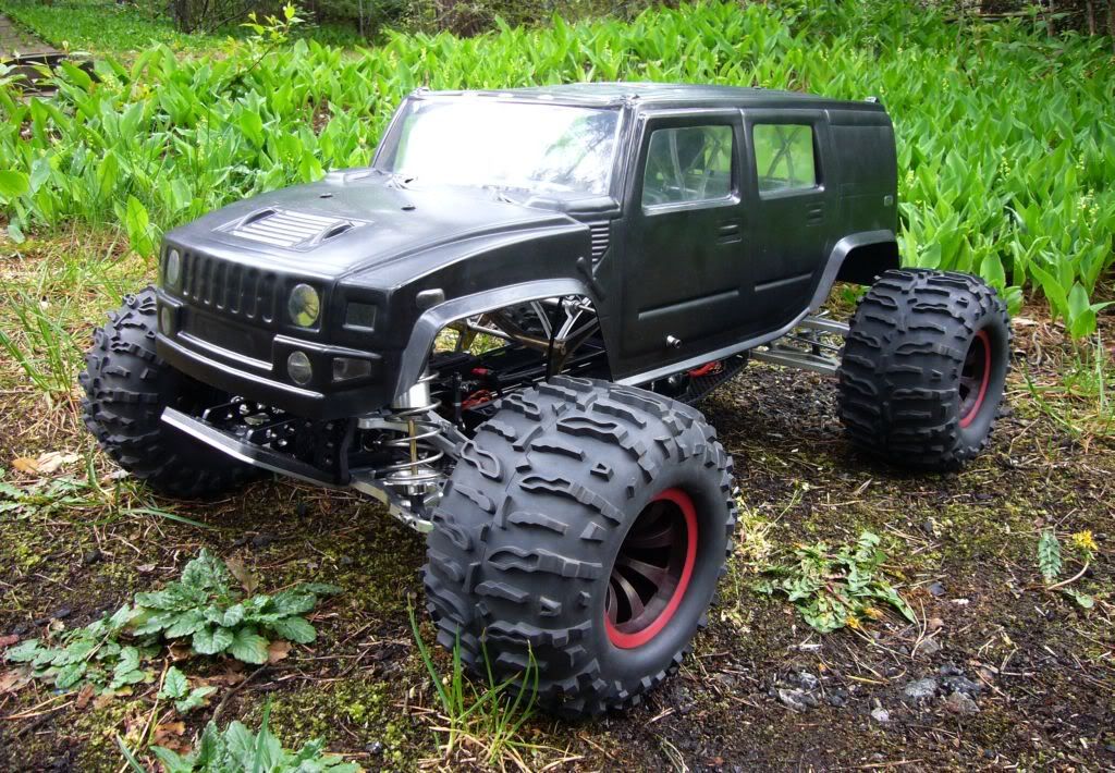

Whit Body and big Cage 7,7kg. But even for show.
I hope you like it...

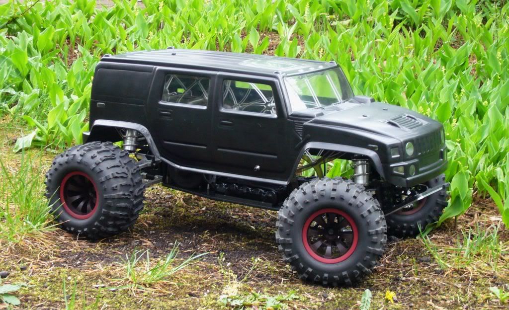

.... Gosh... it's such a beautiful build... That all black hummer body sure adds some personality to the truck... it seems pointless to compliment you on the design and build because you
already know it looks so damn good... but, I must... great work man... the thought process and engineering that went into the truck is just outstanding... I am sure if you got these parts in the
aftermarket seen, they'll do very well... glad you could share it with us here.

I believe the "concrete" in his picture is actually paving stones. The uniform shape, layout, and unevenness leads me to believe this.
Of course I was to busy drooling over the truck to notice concrete and had to actually go back and look to figure out what was going on with that comment.
Stumpjumper, I really think you may get bored with this truck and should go on and ship it to my house. The address is.............

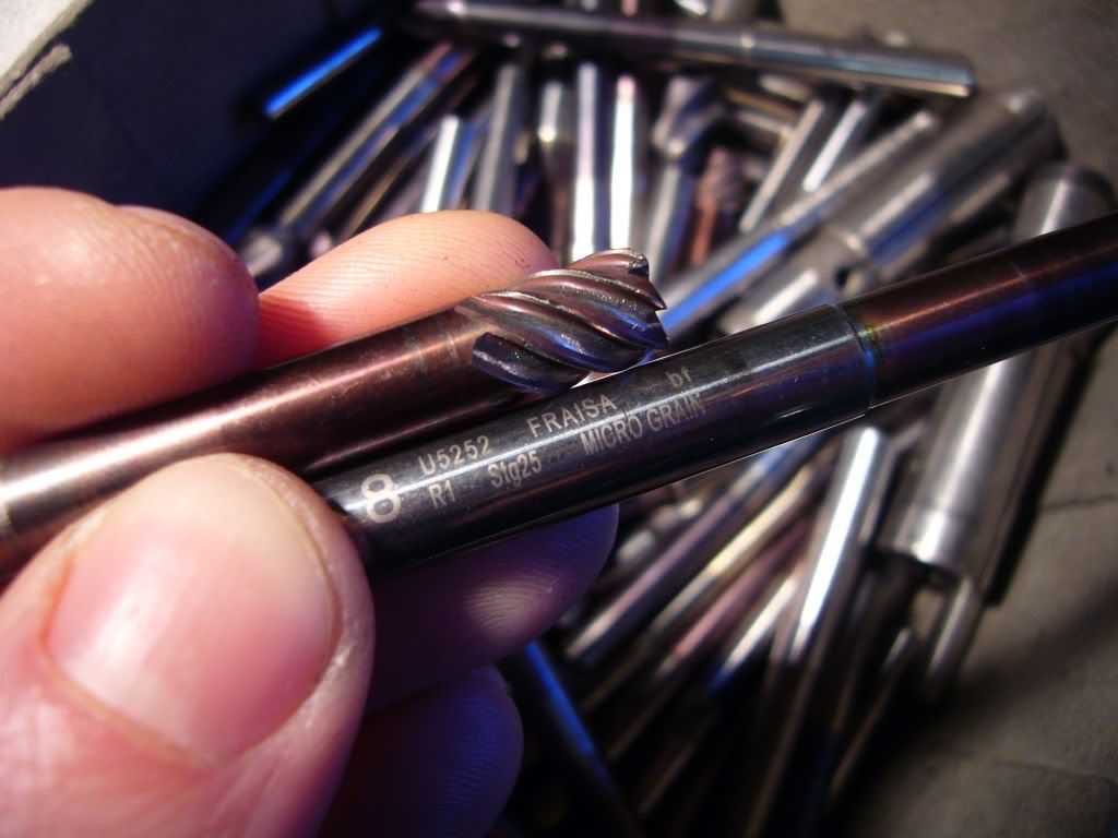

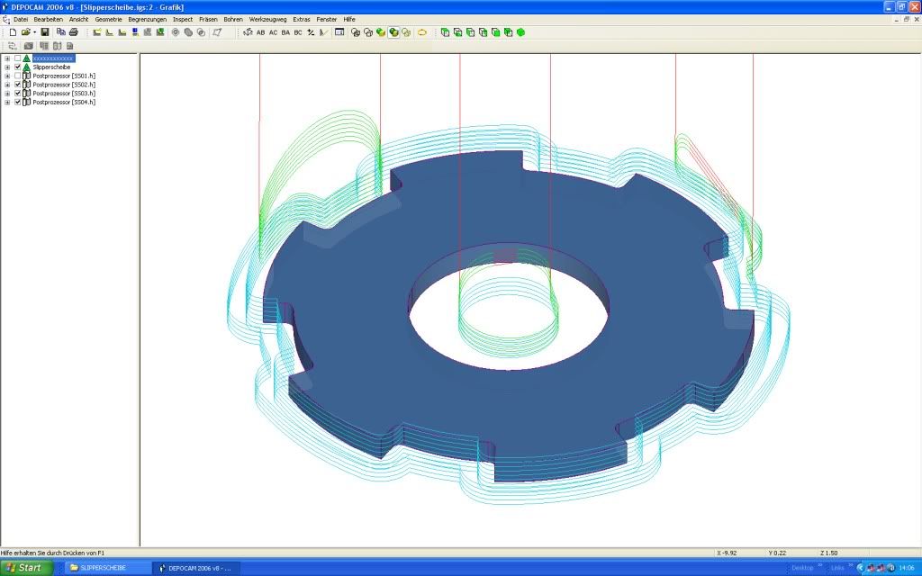

I have a CNC Router and have been thinking about making some custom parts out of carbon fiber. What kind of speeds and feeds (tool RPM - cm/minute) did you use to get such clean cuts? This is the machine I have:

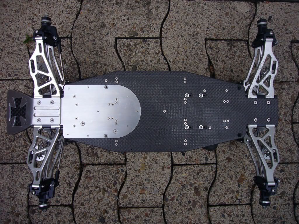

Damn that is a beautiful truck. How rigid is that chassis with the cage? In some pics it doesnt look like it has any bracing lick the truggy chassis.
Also, a stretch, but have you thought about doing a limited production?
Stumpjumper
Posts: 27
Join Date: May 2009
05.04.2010, 10:17 AM
@ all - thanks
@ rc4x4nut - Yes I think about a conversion kit but not full. Only for the normal Nitro-LSTīs. There are so many things I arranged in the gear box. The motor mount is so complex. I donīt want to build it again.
@ JAILBIRD - I use VHM tolls (VHM = Full Harded Metall). We used it normaly to cut hardened steel (about 58-62 HRC).
If you toke normal tool stell cutter itīs blunt very fast. Speeds and feeds - very slow! Itīs a matter of feeling. Also lining. Carbon is so disgusting.
And donīt forgett to exhaust! We have a very big exhaust system. Itīs the big pipe you can see on the pics...
and the smaller one I normaly use for this stuff

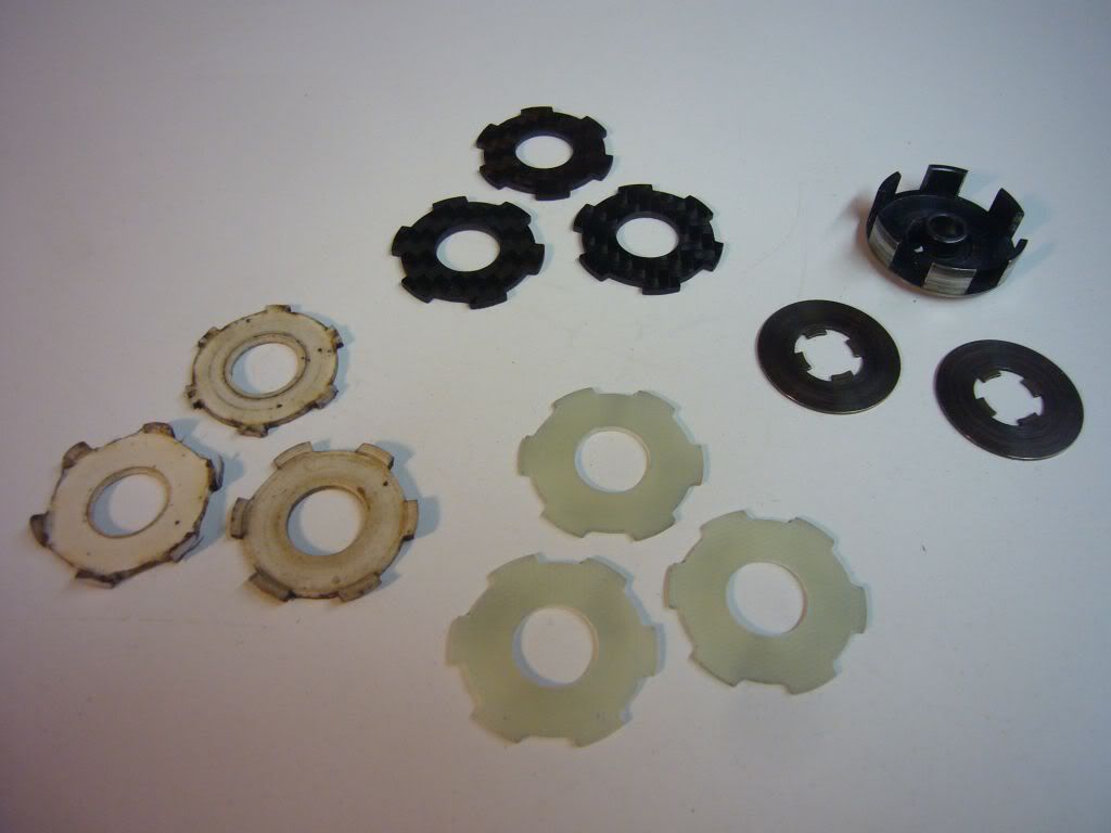

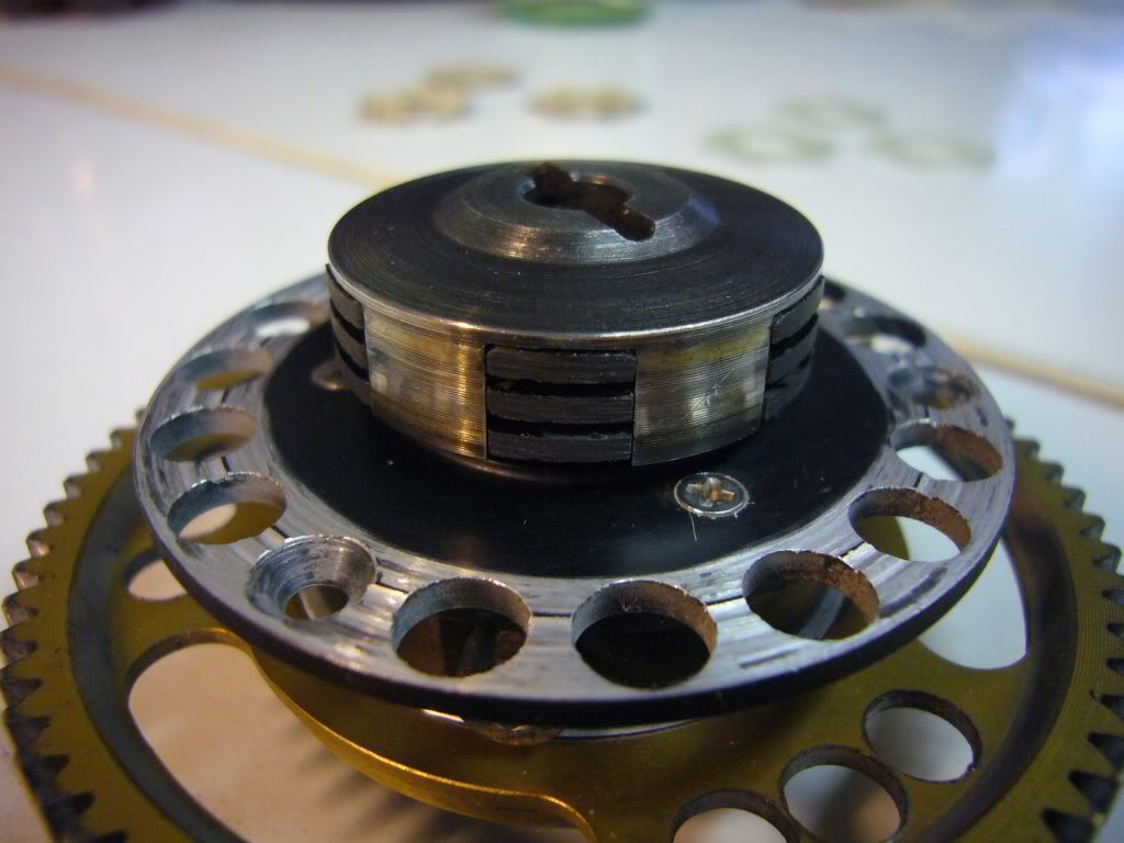

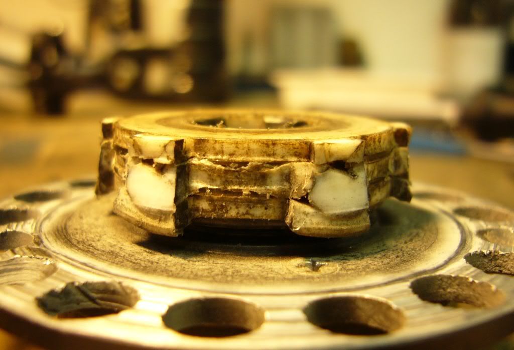

After 3 runīs....
Itīs still the first slipper. It alived the nitro stuff and the last conversion whit the Big Maxximum at 18 NiMh Cells. But now I need a new one.

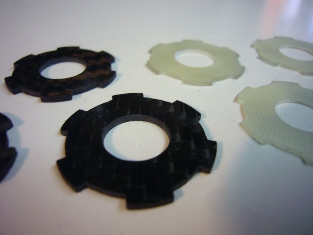

Are you going to manufacture your own?
N. Rustler conversion
Stumpjumper
Posts: 27
Join Date: May 2009
05.12.2010, 02:09 PM
of course!
And here is it:
