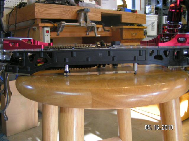

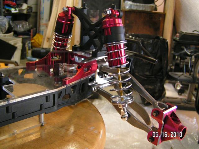

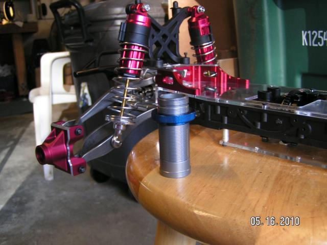

Made some decent progress this week. Got the prototype upper and lower plates cut. Had to make the upper plate twice as I found that some of my hole locations were off a bit, and had to reduce the taper on the front by 1/2 a degree. Still have one set of holes that are off by about 1mm.
First I had to finish up the front end and get some shocks put together for the rear (still waiting on a pair of Ti shafts for the front). I had originally purchased Dynamite Red bodied shocks, then changed my mind and bought a set of Losi threaded hard anodized ones. Only issue at first was that I would have to get the shock ring re-anodized red to match the truck. I was going to use the red caps off the Dynamites, and hopefully end up with a decent looking shock. Well, the cap wouldn't thread on to the Losi's. I then tried the stock blue caps, and they threaded onto both shock bodies fine, and the red caps threaded onto the stock blue bodies.....don't have a clue what could be happening here, but it's fairly obvious I'm not going to be able to use the hard anodized ones.
Also added some Dynamite red chassis braces.

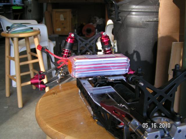

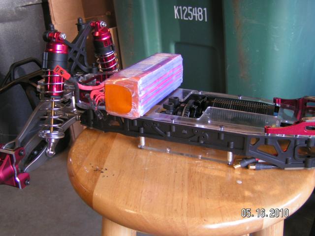

couple more pics
I was going to go the route of a single pack, but looking at the pics, you can see that it doesn't look like a good fit to me. Seems to me that side mounted packs (flux style) would definitley fit the lines of the layout better.
The lower tray is a half inch lower than stock. I may drop it a little more to get the top of the motor mounts level with the top plate - but its right on the edge of being too low I think.
Also I used a stock LST axle CVF for one of the centers...its about 1/8th or so too short but I can move the mounts a bit to make it work. So that solves one end. Waiting for a XXL center shaft to see how that fits.
I also think I'll be moving the servo mount back a bit - too close to get screws into the front on it.
OH...and one beef....those stock losi screws suck! I've got three of them on there right now that are going to be a real bugger to get out, and two of them have to come out for me to finish this build. And being flat heads, I'm going to end up messing up the plate that they go through.....lesson learned...

couple more pics
Most definitely. This build looks great. Having a big honkin' lipo on top would clash with the layout you have with the motor and slipperential so low. This truck will handle so much better with lipos on either side of the chassis placed as low as possible. Just my opinion here from what I'm experiencing with my own XXL.
I agree...split that pack and put one battery on each side, not on top like that...it looks like an afterthought, not to mention destroys the look of the truck, and kills the center-of-gravity.
