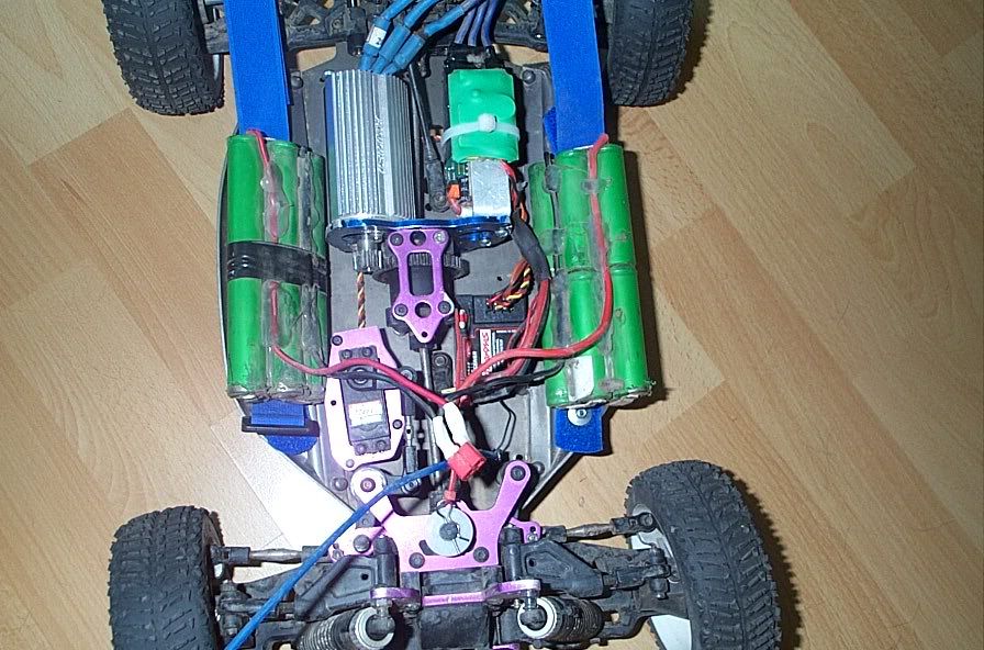

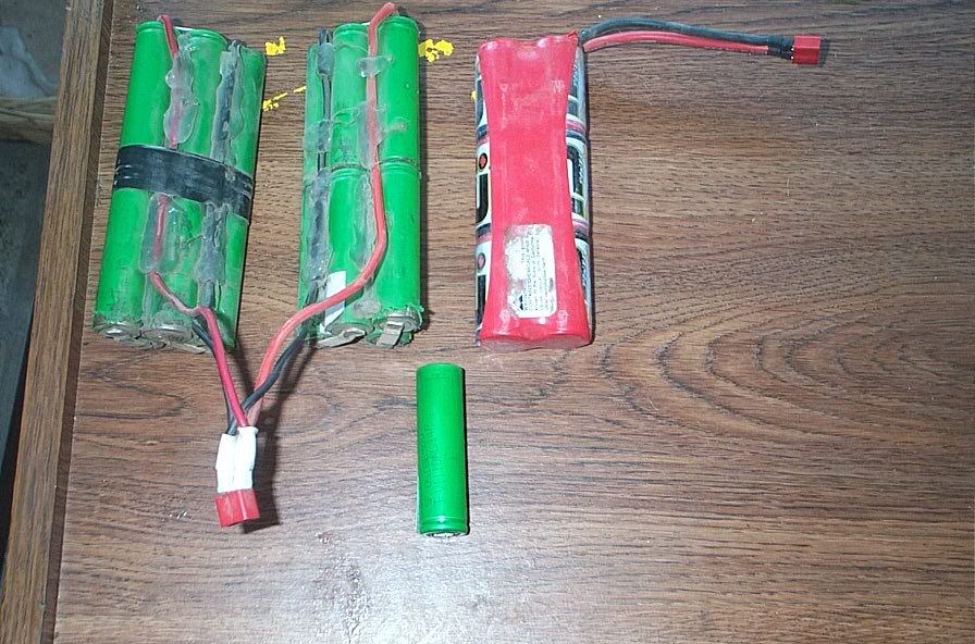

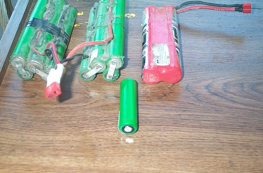

Sorry for the delay.
I think my preference is the more cells you can do alot more with more cells. (Play with weight, add more voltage, add voltage subtract mah ect....).
These cells are from here
http://www.toolsforless.com/product/7364.html

Those are the Makita cells, though, and are different from the Moli cells in the Milwaukee packs.
