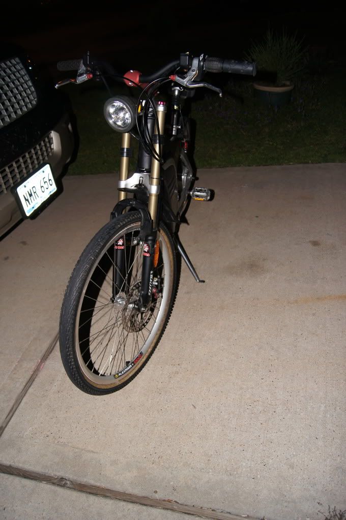

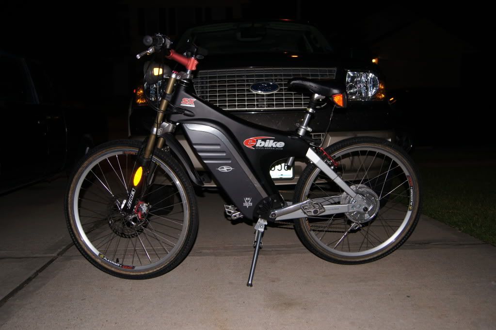

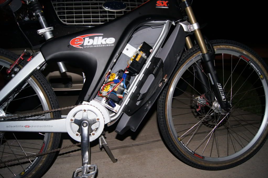

Scored me an Ebike today. I dumped the worn out lead acid and stuck in 10s2p/4p A123's in there. This is an old style ebike, with working horn, cruize, headlight, stop light and it runs a DC geared hub motor! Talk about old school. My wife is using it to tow the little kid trailer around the neighborhood.

Cool! Nice find! Two e-bikes would be so much fun!

It was a good find for sure. Paid 300 bucks for it. It looked like the owner couldn't source a replacement battery and let his son sell it for him. I was suprised how well built this bike is. This model was meant for bicycle cops. I just don't know how they could've pedal this bike around with that heavy 36v 10A Lead acid battery.
The bike also has a Power and Economy mode.

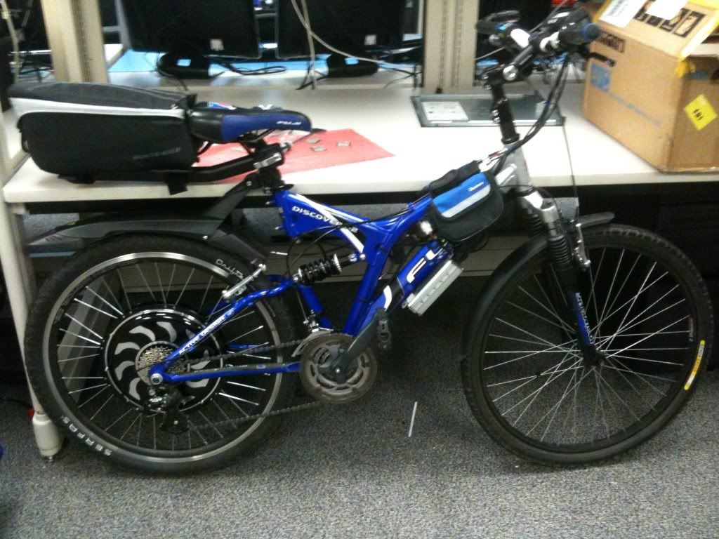

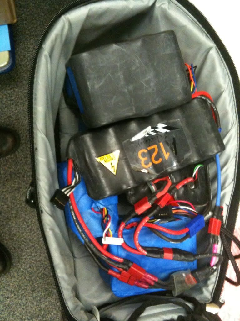

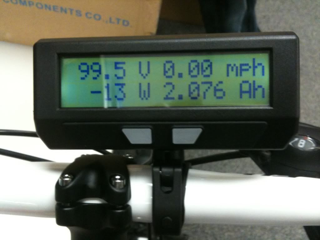

The 107F Houston heat got me worried about running lipo's in my bike, so I opted back to running A123's. 28S2P this time around, which is 85.1V underload and 99V off the charger.

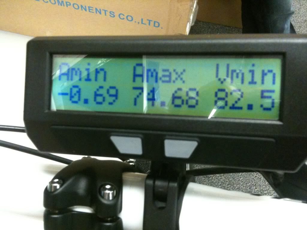

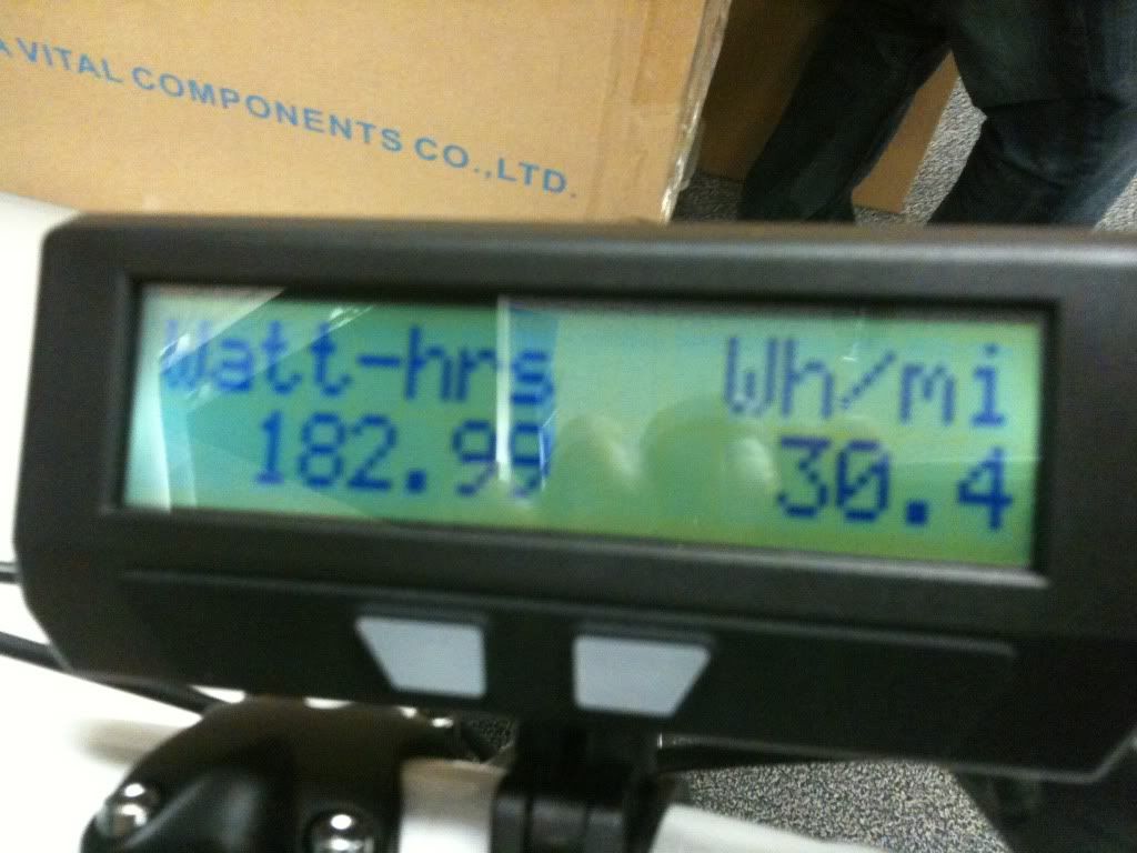

This bike is serious!!! Wow is that 6161.1+W!! Have you gotten any higher? And how are temps w/ the controller and motor?

Yea that is 6000W. It could've been more, but I have set the CA at 4 for the data refresh rate and the amp limit is set at 50A. At level 1 I think I could've caught a higher spike. Temps aren't hotter than when I was running the Ebay 500W motor on less voltage. I'm really liking the Magic Pie motor for it's torque. I'm hitting 42mph with my chest against the wind. My powerlab charger is pushing 850W on a daily basis now at work. I can't run dual power supplies from one wall sockets at my house without tripping the breaker.
btw, Lyen also sells the CA.
