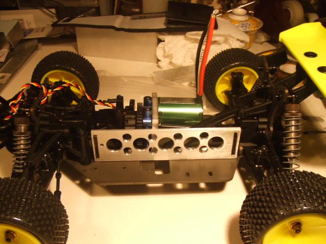

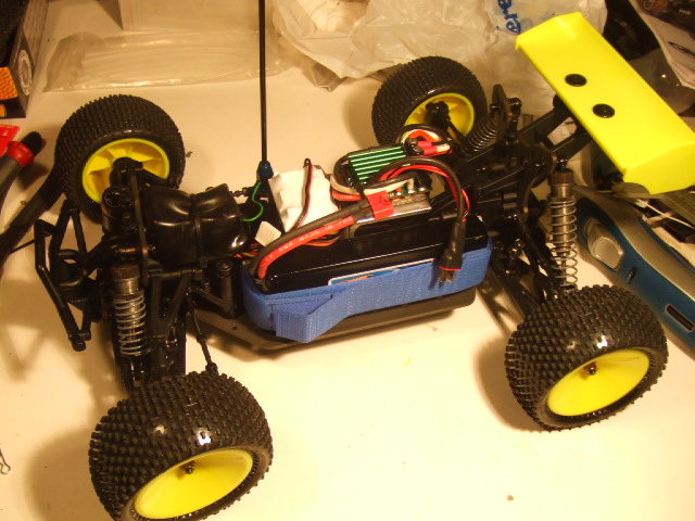

Here's a pic of the mount i used a piece of angle aluminum and use velcro to keep the packs from sliding out and a strap to hold the batteries in it also makes a great chassis brace.:)

The narrow steel spurs are hard on pinions or have been in the past with brushless motors? a hardened pinion seems to hold up if you have a sturdy mount with no flex. The hardened pinions are more expensive though and depending on the motor shaft Dia. sizes are limmited.:eek:

Do you have the aluminum battery thing screwed up from the bottom of the chassis?

Yes the motor mount and battery mount are bolted to the chassis I have seen some people make there battery mount bolt into the existing motor mount holes only but you would be better off drilling a couple of extra holes and using the mount to stiffen the chassis also. :)
