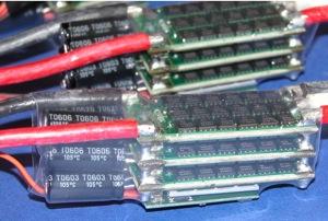

Originally Posted by BrianG
I'm surprised some engineer at Castle hasn't thought of a modular ESC idea. That way, they can use the same brains board, and just feed the signal to as many power boards as needed. Would be a little more pricey at first to come up with a modular unit, but would cut their costs on the long run. That is assuming their firmware/software was totally upgradeable like the MM...
Do you mean like this the CC super 300. :032:
  (#78)
05.19.2007, 12:42 AM
Sort of, but I'd want a heatsink for each layer. :)

Getting close to the testing stage...
Mamba duplex Side A and Side B.
New Caps, extra heatsinks in between boards, transorb and couple mods ESC.
CC change their design a little bit, painful to take apart and solder quality looks not as good as used to be...
Plan to finish by sunday and start testing next week.

06.18.2007, 08:46 PM
SWEET! Are you going to make any software changes while you're at it? ;) J/K.
Awesome job! Looks better than some other manufactured ESCs. Hopefully it works once it's all put together.

DANG! Artur, that is smokin! Those are some monster caps on that thing... I LIKE IT! :004:
What kind of current rating are you giving it? 180A?
