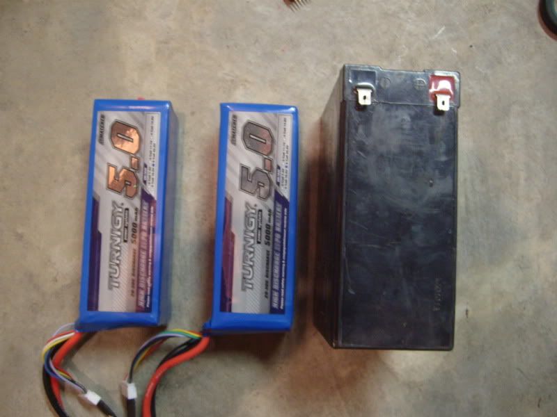

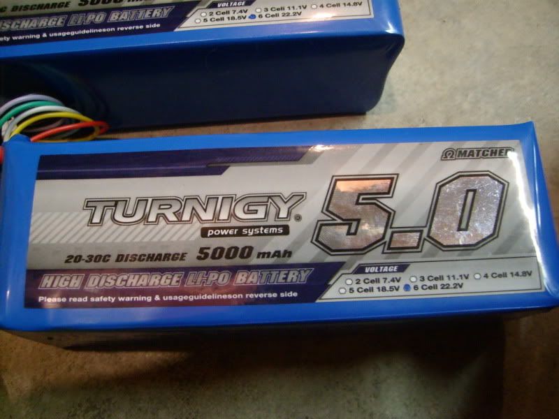

I got my lipos today!
It got a little hotter then I'd like tho.. The windings got up to 175+ after a 30 second run at full throttle into the wind. It was around 160 after full throttle going in other directions. I am going to apply some thermal grease between the motor and the aluminum mount and also add a small heatsink to the outside of the motor where there is a flat spot.
Top speed was 20.9mph. Yeah! Pretty dang happy about that. It felt really fast and pulled all the way up there. Killer acceleration, but I have to go slow or something goes wrong. It might be loss of sync, but there isn't screeching sounds. The battery wasn't fully charged at the start of the run and it ended up at 3.9v per cell after 9 minutes of short runs and covering 1.4mi.

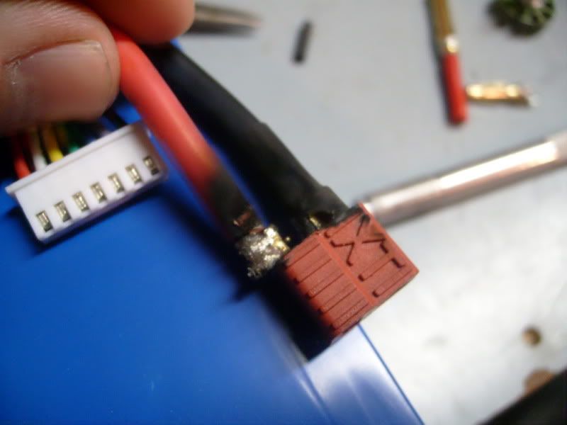

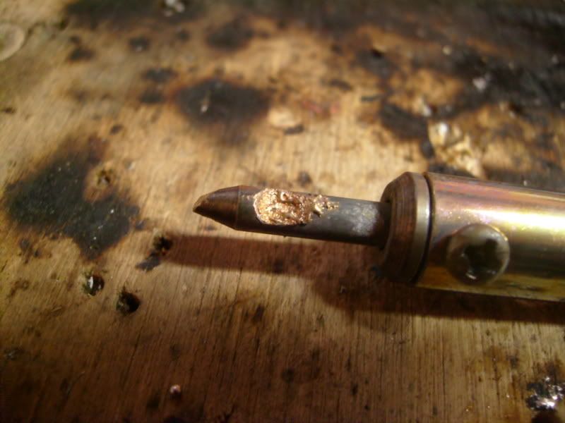

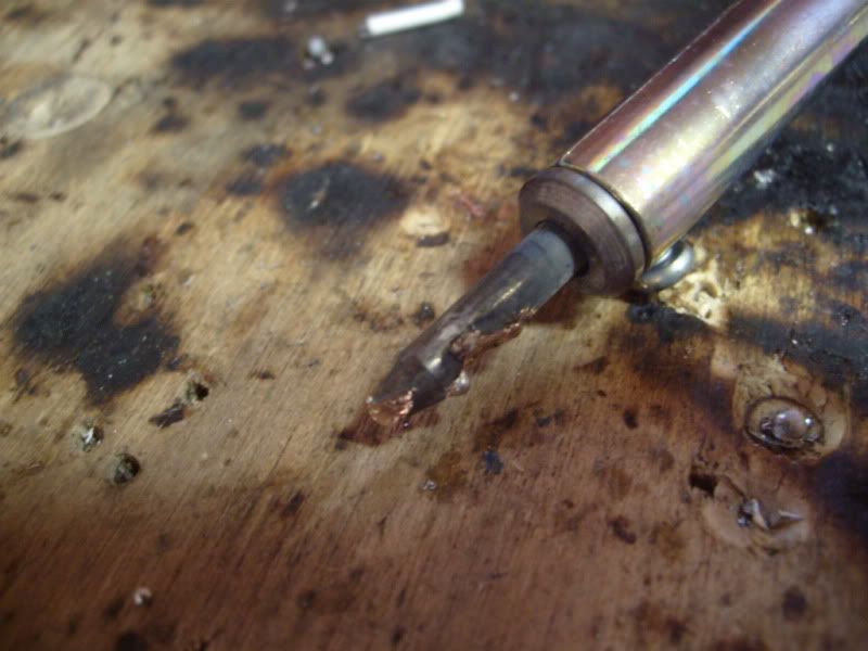

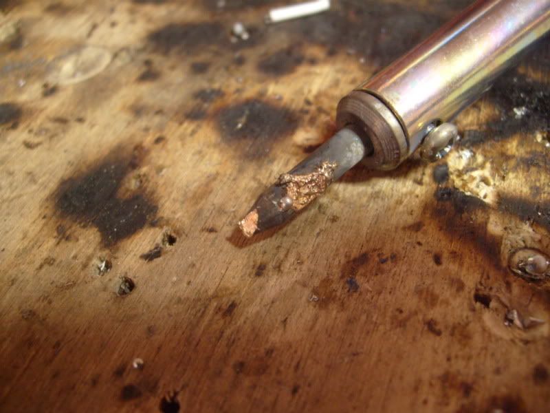

I also had a soldering mishap putting fake-deans on the batteries. The iron slipped and shorted out the pack making a huge, bright spark. I don't think the pack was damaged so it's all good. It made a nice wire-shaped spot on my tip along with a less-sharp end.

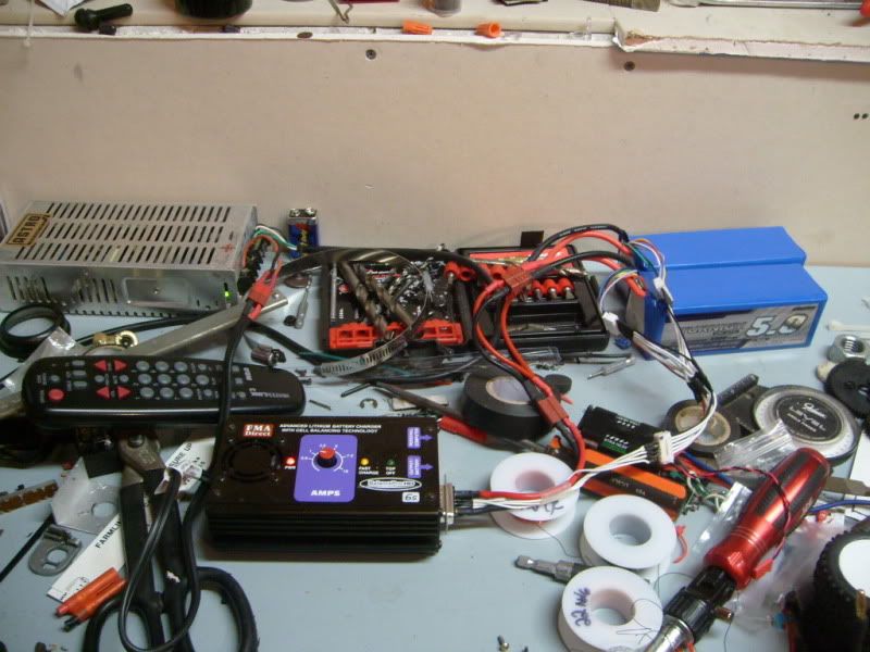

And I guess I only have one picture of my new lipos. This is how I charged them before I moved to the concrete floor.

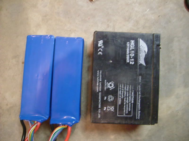

The new lipos weigh 12 pounds less then the old ones with wayy more power. The scooter is pretty dang light now.

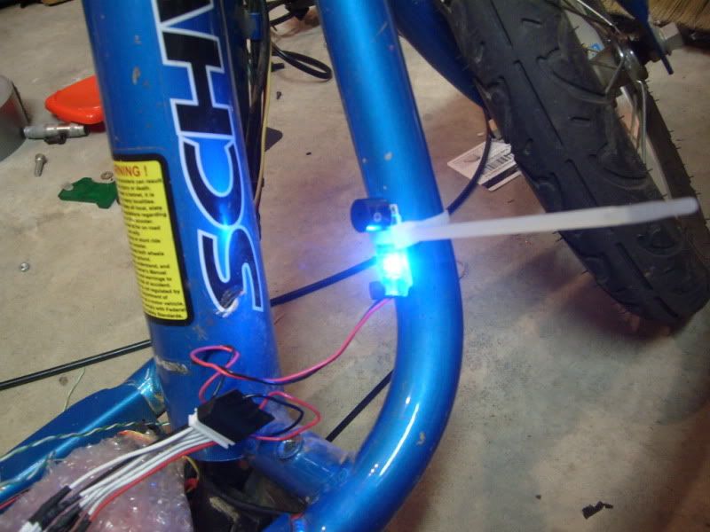

I got a battery monitor/lvc for my lipos. When I got it, I figured it wasn't really necessary. Man I love the thing!
A blue light that shines if the pack is above or at nominal.
The blue light flashes at 3.4-3.7v/cell.
A red light will shine at 3.3-3.4v per cell
A beeper and flashing red light starts if the pack goes under 3.3v/cell.
I started at solid blue (never checked voltage, but last night I was at about 4v/cell after the initial 30-minute partial .5c charge) and it was sold blue for the first couple miles. It then was blinking blue until I accelerated hard out of a turn when the beeper and flashing red light came on for a second. I just happened to be right by my house so I just 1/4 throttled it back. It went back up to flashing blue, meaning above 3.3v/cell.

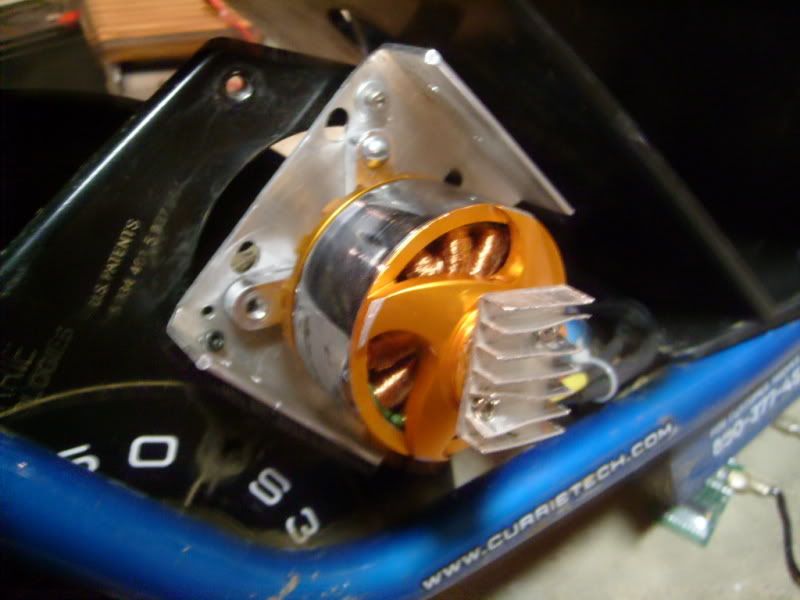

Top speed was 20.5mph, average speed was 15.2 according to gps. I could cruise around 19 all day. I put thermal grease between the motor and the primary mount and the secondary mount(the aluminum plate with bends in it). I also added a small heatsink to the end. Temps were wonderful. I checked periodically throughout the night and they never got over 140 on the windings. It was usually a tick over 130. The case was well under 100f. The controller is cool and batteries are ice cold. I am very pleased with temperatures.

battery monitor. The black thing above the light is the beeper. The light is pretty dang bright and the beeper is easily audible.

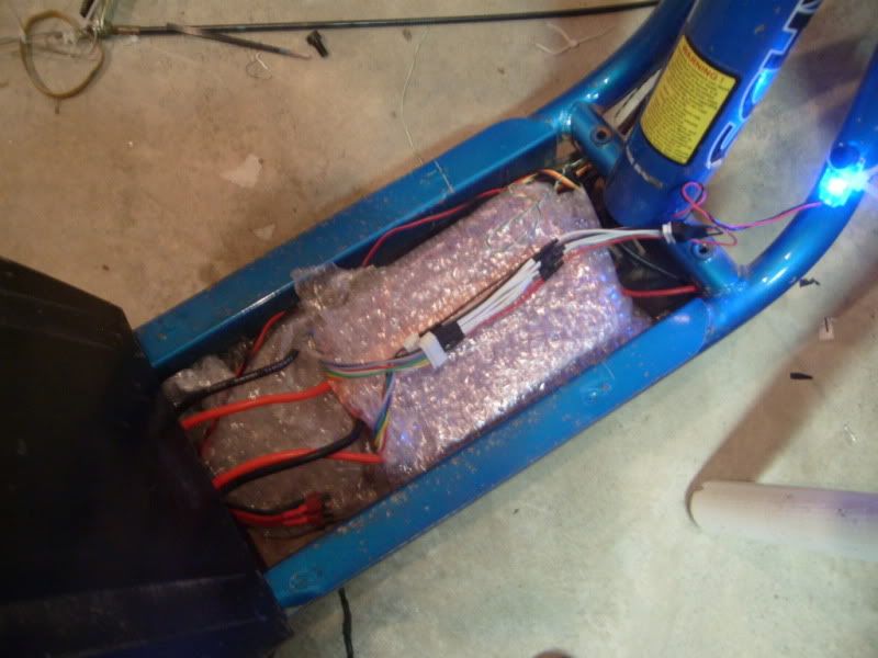

My battery nest and Parallel balance harness
I also soldered a jst plug to the main parallel connector, and I have a bec plugged into that. I had problems with too much voltage goinng to the servo tester; I hope a fully charged lipo isn't too much for the 22.2v input on the bec.

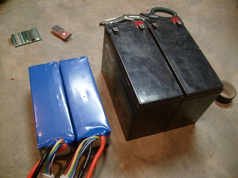

I got some shots of the new lipos, out of their "nest"

Sweet- need a video at some point, and any chance of a wiring diagram; all I can see is wires and bubble wrap!
Not sure about that little heatsink though- I assume it spins around with the endbell, which kinda makes me nervous about the damage it could do to your legs... maybe something a bit rounder and less pointy?..

Yeah love the improvised sink lol. That'll drop temps at least 1-1.5 degrees!
I agree with Neil- don't let it snag a pantleg...
That is cool as shit actually. A true BL & lipo transport. So 2 more of those packs could either double your speed or range, and you could switch between parallel and series pretty easy... wanna reason to put a helmet on?
