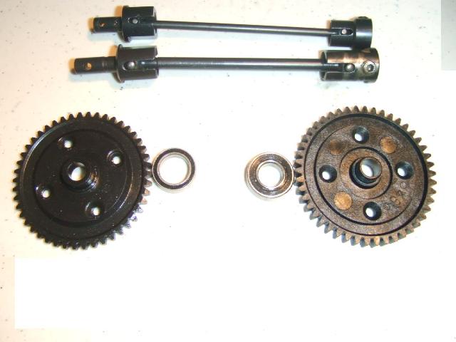

Originally Posted by NiCad
Can you please give me detailed description of the kyosho spur and what bearing is needed. I am lost on this aspect of the conversion. I think I am trying to make it hard or simply if I got the parts I would see what was needed or not. I am really tryting to get a complete list of things. This way the parts are here for when the mount and power plant arrive. I then would have everything ready to convert it.
Thanks you,
NiCad
Check out Ricemans thread you need a HPI Savage front center shaft and 1/8th scale drive cups http://www.rc-monster.com/forum/show...ighlight=crt.5
I used Jammin buggy drive cups and rear diff mount so from the spur back to the pinion is 1/8th scale buggy part's with the HPI dogbone. with the wider Kyosho gear your diff is going to be about 1-1.5mm longer and requires relocating the diff holes in the chassis.:( I hear there is someone working on a offset spur so the stock diff holes can be used when who knows? if you want to run the Kyosho gear it works great but needs some mods to fit I'm happy with it when the new spur comes out I will just pick up a new chassis on Ebay for around 10 bucks and go back to the lighter stock set up. :)

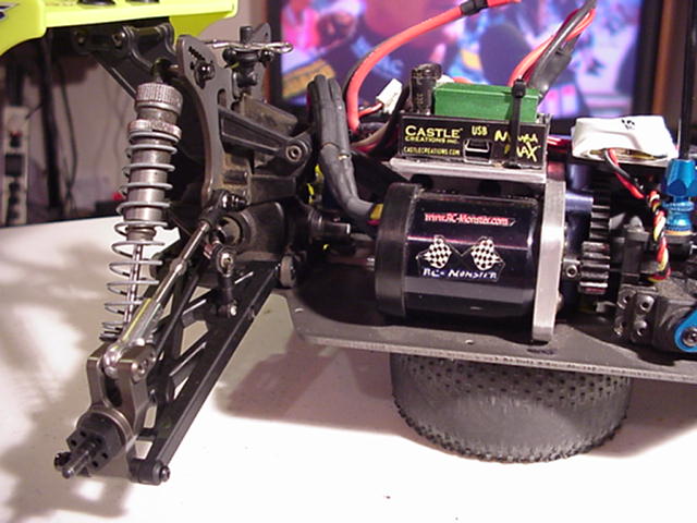

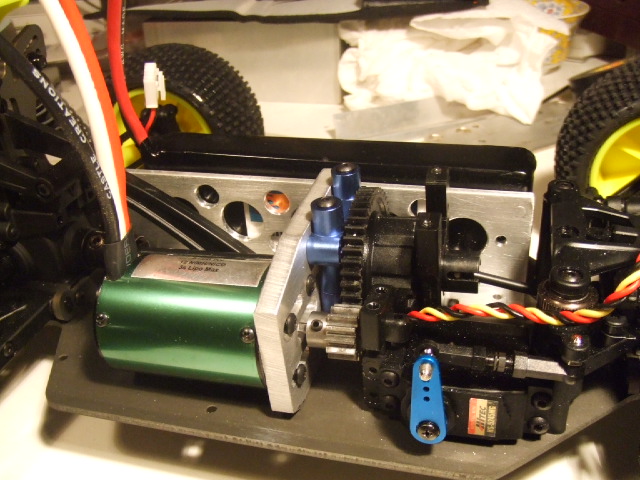

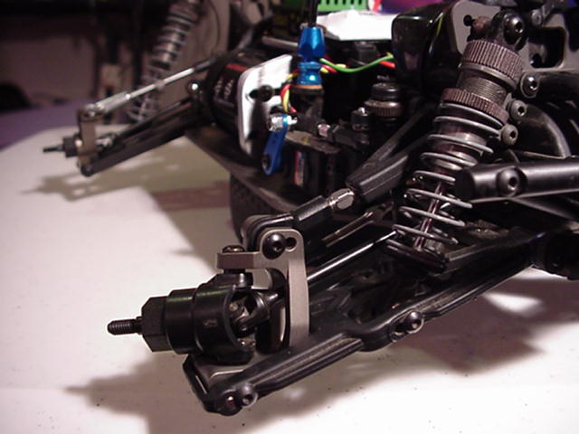

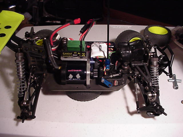

No prob I see the brushless CRT.5 is getting more popular it is the perfect car for it though. There is a 3pc mount on Ebay also you might check out?
I got a chance to get the new aluminum part's on no more broken rear hubs.:) The 1506 Neu is working great with the Mamba Max ESC no sign of cogging yet.:027:
Any body know of a off road track in or near Hilo Hawaii? I'm going to be there for about a month working on a movie and was thinking of taking the CRT.5 and have some fun while I'm there.:032:

What aluminum parts are on it IB?
