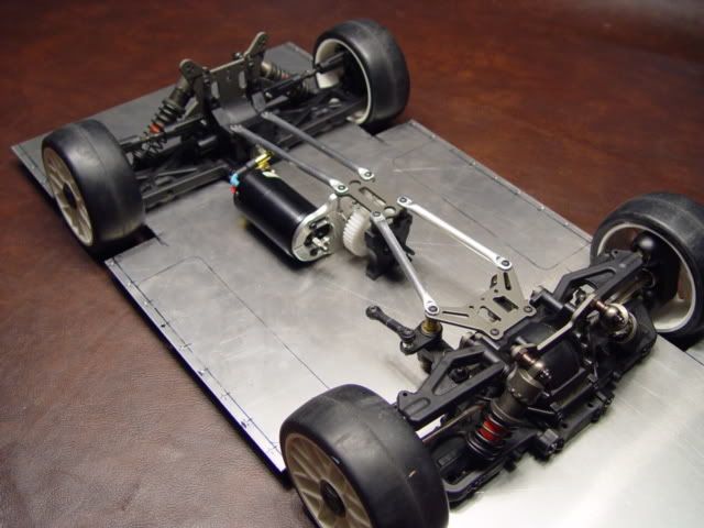

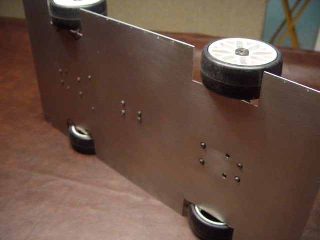

Anyhow, I ordered up some 12"x24"x0.08" (2mm) 7075-T6 aluminum plate a couple weeks ago. The other day I got around to cutting it up. Here's what it looks like now:
I also ordered a 12"x48"x0.025" piece of polycarbonate to make the sides and the internal support structures. It came today, so hopefully next week I will have time to cut it up a bit. I'm going for the "speed wedge" look, with a twist- I'm going to design a venturi into the top so that it will create a vacuum inside the body and (hopefully) help stick the car to the road.

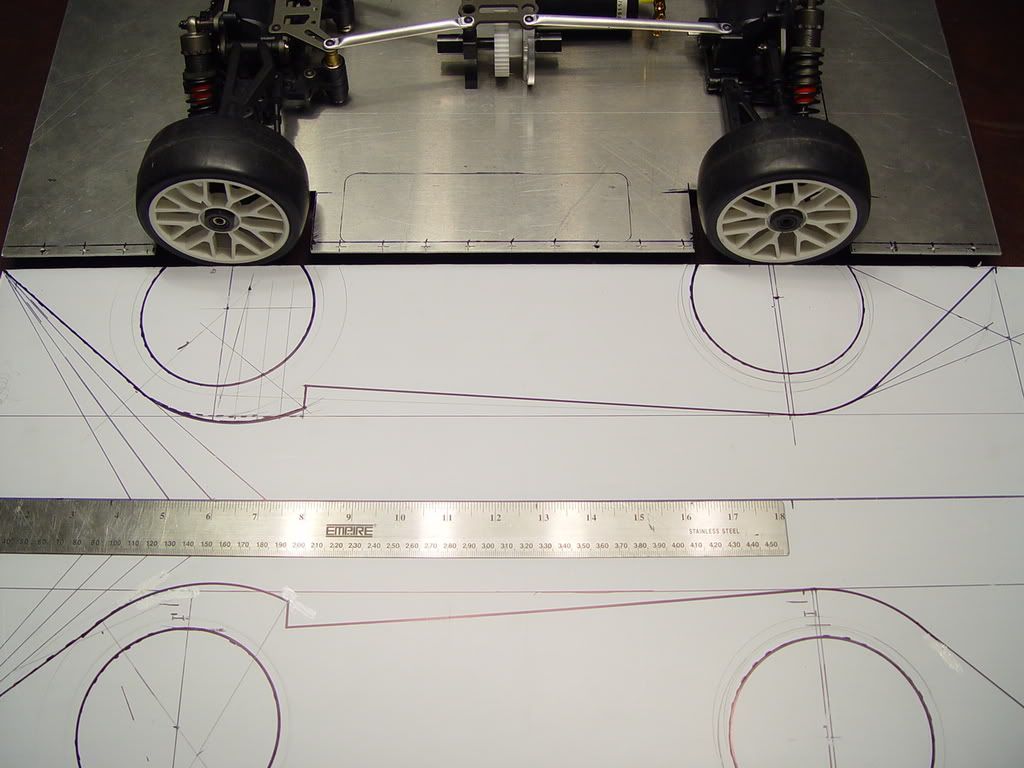

I finished outlining the body's profile on the polycarbonate. I am going to buy a thinner blade for my band saw before I even attempt to cut it out (1/2" blade on there now for cutting Al). I think a jig saw would make a really rough cut, and I don't want to crack/chip the edges either.
Here are a couple pictures of my design. The "notch" is at the front of the car. It's where the venturi will draw air in from underneath the car.
Now for the million-dollar question: Should I put a wing on the back??? It would be made from the same polycarbonate/aluminum as the body.

Sooo... I'm poor as s#!7 right now and as such I haven't been doing much on any of my projects. I did finally buy some parts for this car- An RC-M 8T motor mount, and the OEM 8T CD mount/brace kit. These will allow me (hopefully) to drop in the Slipperential I bought 5 months ago. I need a short dogbone for the front (these?) since it will be FWD and I want to move everything forward. Oh and I've cut out the polycarbonate body panels. I'll get pics up later today.

Ok, I forgot to take pictures before I tore it down.... Oh- and I read that the Slipperential was a drop-in for the 8ight so that's why I bought the diff mounts. Guess what? Mine isn't! It came with 8x16x5 bearings. I need some 8x14x4 flanged bearings. ..... Mike's 8ight motor mount is frakking sweet though. I like how you can remove the motor- with the screws still in it!
So I'll get the bearings and take some pics when it's all back together.

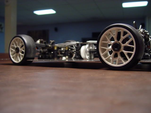

Here are some recent pics-
http://i52.photobucket.com/albums/g4...P/DSC00342.jpg
http://i52.photobucket.com/albums/g4...P/DSC00341.jpg
http://i52.photobucket.com/albums/g4...P/DSC00340.jpg
http://i52.photobucket.com/albums/g4...P/DSC00355.jpg
