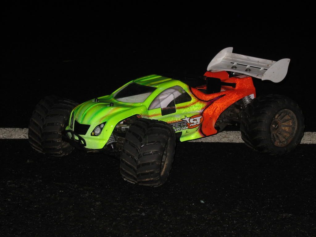

I don't feel like starting a whole another Hyper ST thread, so I'll just throw a couple pics of mine up here. Currently it has my old 8XL and my MM from my CRT.5 currently powered by 4S 5Ah TrueRCs. Plan is to change over to a MMM and a Neu 1515 2.5D and adding a cell to the batt for 5S. I can ditch the BEC and the extra wires for the fan and the bec power supply then as well and clean up more. I have it geared 12/46. On the mashers tonite I was pulling 45-46 mph on radar. A bit too fast for the track. Here's to the MMM coming out soon.
BTW.. I don't know why the paint looks sparkly. Its insanely humid out, must be water droplets. I also already managed to lose a wheel nut and had to use a spare Lots of loctite on that one. :)

You should be closer to 38mph unless you are getting .5" ballooning...
Differential Ratio: 3.909090909090909
Transmission Ratio: 1
Other Ratio: 1
Spur Tooth Count: 46
Pinion Tooth Count: 12
Total Voltage: 14.8
Motor KV: 2084
Tire Diameter (inches): 6.6
Tire Ballooning (inches): 0
Motor Current Draw: 0
Motor coil Ω: 0.0073
Spur/Pinion Ratio: 3.83 : 1
Total Ratio: 14.98485 : 1
Tire Circumference (inches): 20.73 inches (526.66 mm)
Total Motor Speed: 30843.2 RPM
Vehicle Speed: 40.41 mph (64.92 km/h)
Estimated Adjusted Speed: 38 mph (62 km/h) - 5% loss
Effective KV Value: 2084

I prob am, def even more so in the F under WOT due to the light fluid in the diff. I admit it was much higher than I expected, but I ran it several times back to back with the radar gun and it was consistantly 45-46mph.
