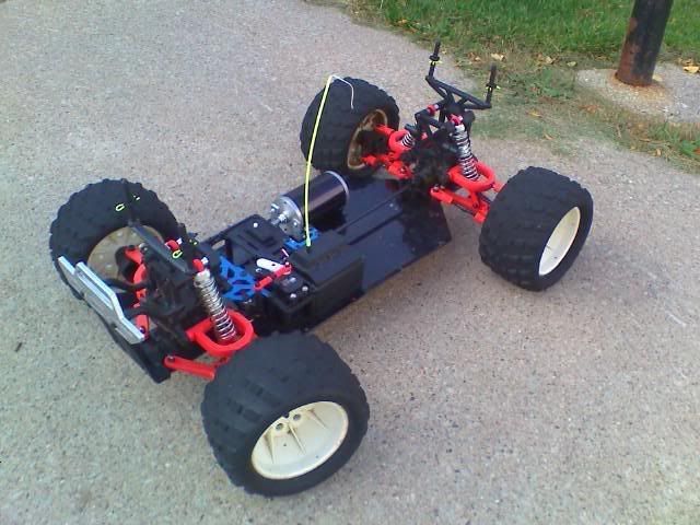

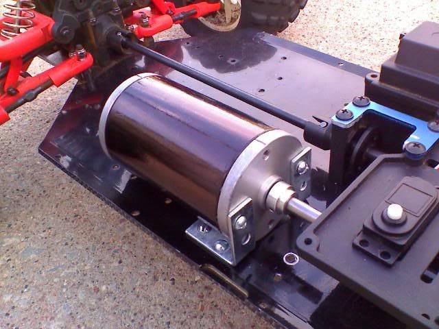

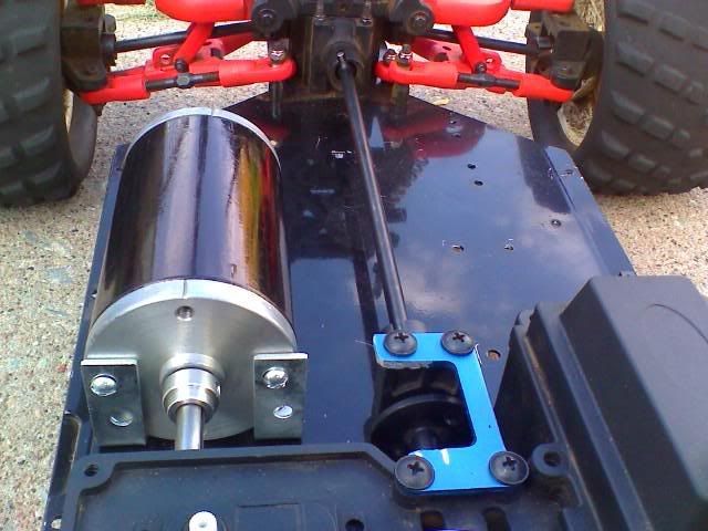

Here are some pics of the motor mounted...

  (#117)

I will also be installing 2 more mounts of the same specs on the rear end of the can to keep it from swaying.

  (#118)
brushlessboy16
brushlessboy16's Avatar
10.12.2008, 05:41 PM
Looks good takedown i still think belt drive to the center drive would be better then chain..

10.12.2008, 05:44 PM
Im afraid of belt drive. Ive seen them snap on scooters quite often. The reason I want to use chain is because I can get the very small beads and not take up space but yet have a very strong connection between the pinion and the center diff. And their is less room for meshing error with using chain. If you mess up the meshing on a belt you could strip the belt.
RIP- Tammy (9/14/08)
  (#120)
Krawlin
Got brushless?
Krawlin's Avatar
Posts: 592
10.12.2008, 05:50 PM
1 word can describe that.
Beastly.
Looks awesome Ryan, should be one hell of a truck.
As far as belt vs. chain, I have to agree with Ryan, the chain would be better, would have a far more solid/crisp throttle feel than a belt, and would be stronger. And as the chain stretched, you could take links out as needed. Cant do that with a belt. Good luck, should turn out awesome.
