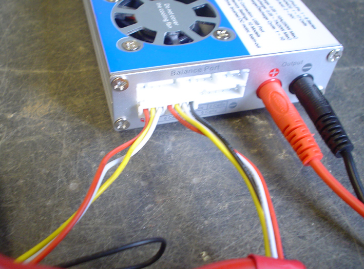

running side by side for 6s fun. Charging on an Icharger, in the end I cut the tap on one pack, joined them together and charge it like a 6s pack, all is well

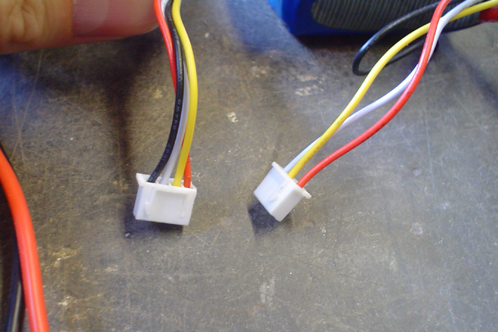

Curious as to what you did with the balancing wires- did you run them both together into a single 6s tap, or something different ( quick diagram/photo )?

sure thing, like this
so I trimmed my taps so the little lug is still on one side, this way they only go in one way.
the removed one is just a dulpicate. As you advised me though, still need a powerful charger to do the 6s at 5 amps.
06.14.2010, 10:30 AM
Sweeeeeet, now thats inspired work, even accounted for the 1 negative wire & rest being positive with the zippy balancing plug layout vs viceversa on the diagram
Not so sure on the crocodile clips > bullet connectors, but if they arent heating up then thats cool, nothing to worry about.
