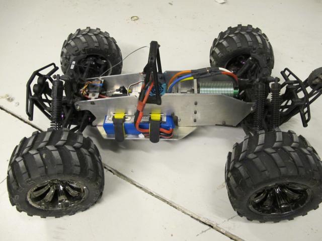

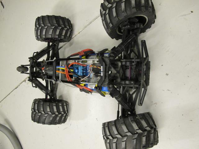

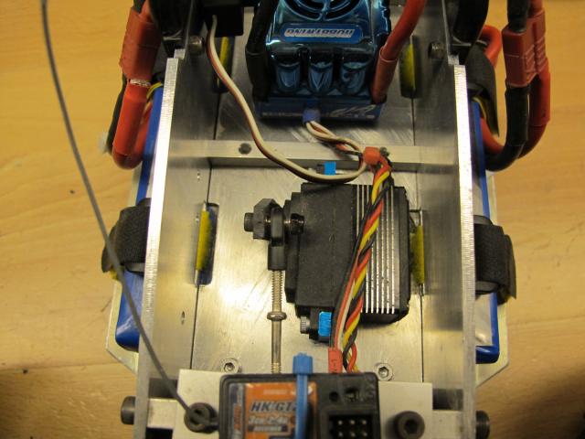

Truth be told I crashed it last fall and didn't feel like disassembling it again... sooo its been sitting in the basement until recently.
Lately I found the urge to fiddle with it again so its been updated a bit more:

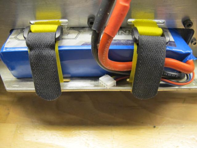

Strap me up Scotty!
Its almost a G-Savage :)
Center diff is locked 100% This means that instead of unloading the front wheels I unload on all 4
It doesnt wheelie well, doesnt flip over well... its no longer a Savage - its something else.

Nixpus: Nice work on the straps though I hope they don't get too beaten up underneath.

I think the "problem" is that I have a super low CoG... I shifted all the weight I could as low as possible and I shortened the damper travel so the suspension arms are horizontal. Ive made it into a go-cart... and it behaves like it.
The truck just unloads on all four when I push the trigger hard... its actually a tad dull ;)
Its also the reason why I locked the CD... I thought the truck just unloaded on the front...
Im really happy about most of the truck. It jumps well and it does not roll over unless I do something really silly. If you look at page 6 or so you can see that it is almost as wide as it is long (disregard the bumbers). If you want to avoid roll overs you got to lower/stiffen the suspension and find wheels with less side wall. Extending the wheel base also helps.
The bottom plate where the batteries lie are bend slightly upwards at the edges... I hope it will lessen the wear of the straps :)
