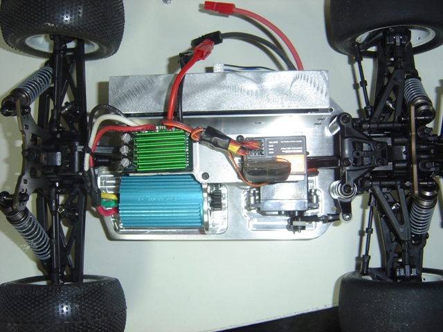

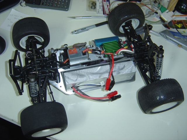

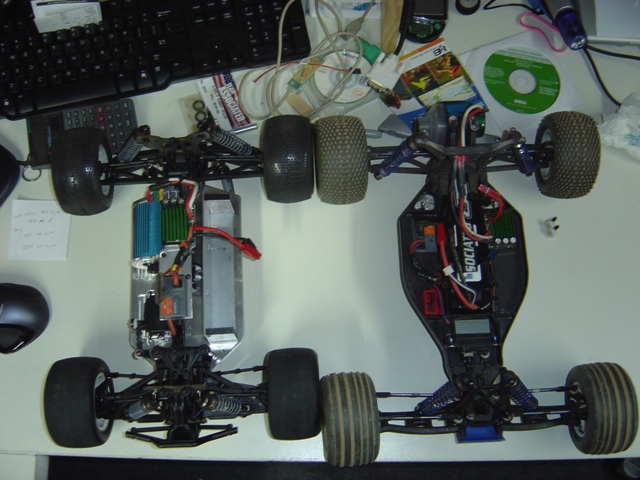

Couple of pics.
Next to a T4 for size comparison.
I used some aluminum angle and delrin blocks to make the battery tray. It fits a maxamps 2s6000. I didn't like the idea of the battery hanging off the side of the chassis, so it's on it's side. I also made room for the RX and ESC on the diff top plate.
I just need to mill out some holes to lighten everything up.
I tried a few bodies at the LHS. Found the Proline for the Losi XXXNT fits pretty good. Had to lose the wing, but that's ok because it looked a little small and silly with the 10th scale body.

Nice! Finally a comparison pic Thanks!
Your .5 looks grate! Nice work!
