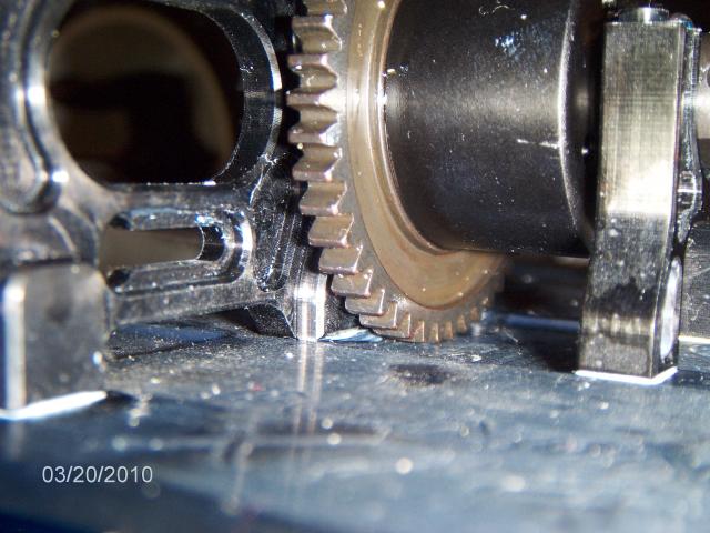

Now what the center diff is hitting what did i miss ?

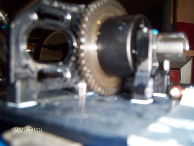

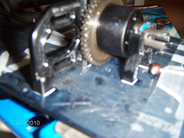

Bottom of diff original xray to xt8 havent even put it together yet and its already bottomed outOK gurus what gives Suicideneil probably already knows
ID:	8692   Click image for larger version
  (#126)
03.21.2010, 02:31 PM
Hard to tell from those photos- use the macro setting ( little flower ) to get a good in-focus close up. I'd also go ahead and intall the rest of the unit to see if it rubs anywhere else, but I'd definately say that spur looks huge- what tooth count is it?

03.21.2010, 02:35 PM

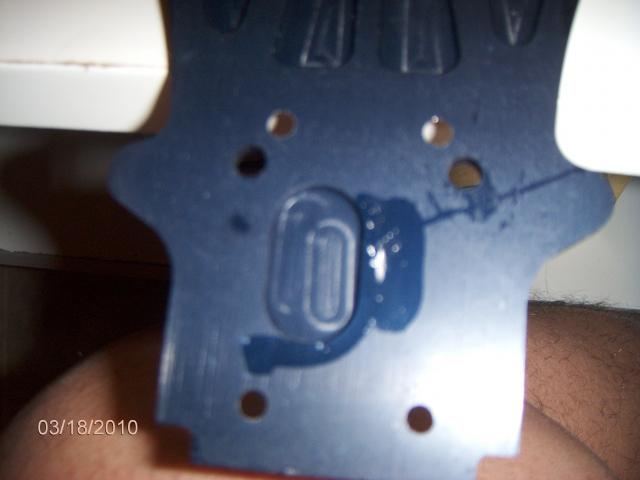

Scratch on the RCM chassis from not putting the diff in the correct way OOPS the other day what the hey first build> ok thats what the grooved area is for LOLthats bottom part is my leg since you guys are quick to pick apart lol

48T original maybe I should get RCM slipper

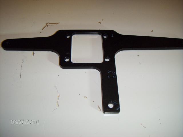

After further extreme close observation reailize the bracket with the square goes under the center diff to give clearance and the build continues
