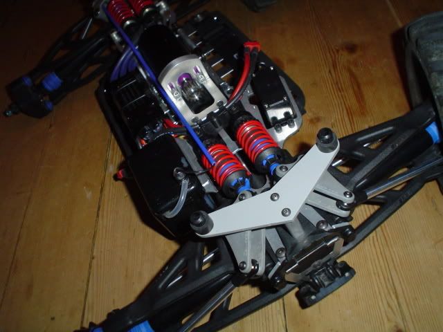

Yes, lots of news on this, actually. It's my standard truck now. My weapon of choice when I go out RCing, and I take the first BL revo with me so friends can drive it.
I made custom body mounts for the G3R, letting the body sit super low. Looks awesome.
Unfortunately I have some issues with Maxamps Lipos, at the moment I can only use 75% of the 8000mAh capacity... but since I spared no expenses on this truck, I'll soon have top notch Lipos too. You get what you pay for, and Maxamps just won't cut it for me anymore. Stay tuned on this.
Here are some pics of the new body mounts, they are made out of PVC:
Cheers

ay dafni car look real nice. i had a question what is that part that holds the shim pins in place over the bulkhead brace. building from parts so i dunt know all the parts and traxxas does not show it in the assembly pictures.

Brushless Losi, I'm not sure what you mean by shim pins? But I assume you meant the part that was once just a stock revo bodymount/bumpermount. Right? I modified it, and it does appear on the exploded view, btw. It's part number 5314.

thanks they looked like a seperate piece in the picture. didnt know they were attached to the body mounts. thnks for clearing it up for me.
