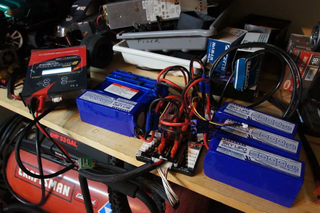

Got my batteries today, so tomorrow will be the test. Most that I can fit is 22s2p.

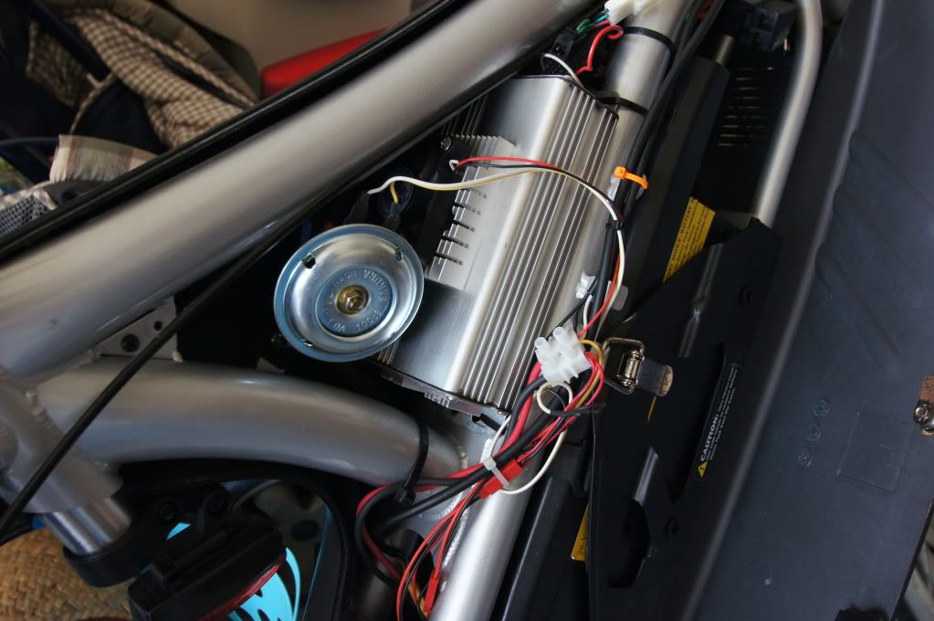

I also added a heatsink with fan on the controller for when it gets hotter. Gonna add a temp sensor to see how much the temp drops and than figure where to add intake and exhaust holes.

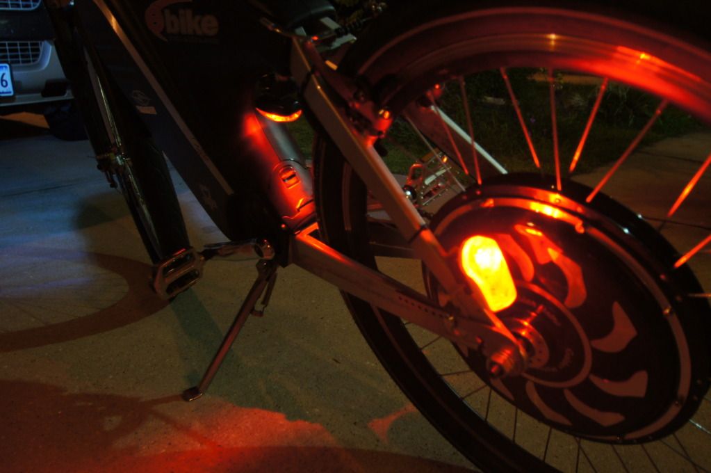

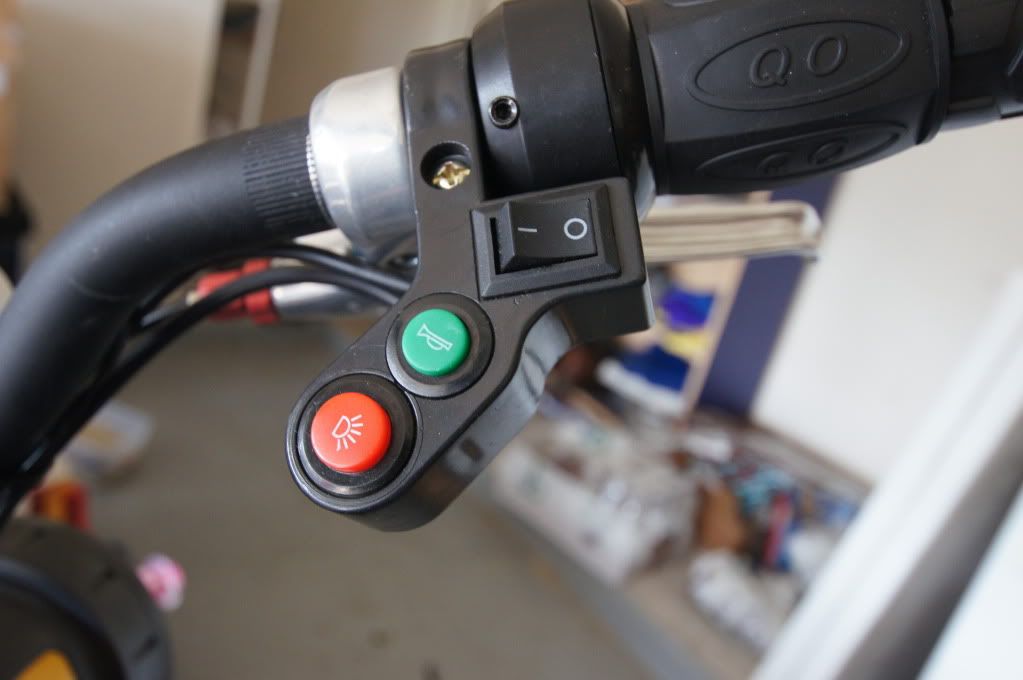

I added the horn and got a lights going of the new switch. Fan, lights and horn are run off 4s1p 18650 batteries.

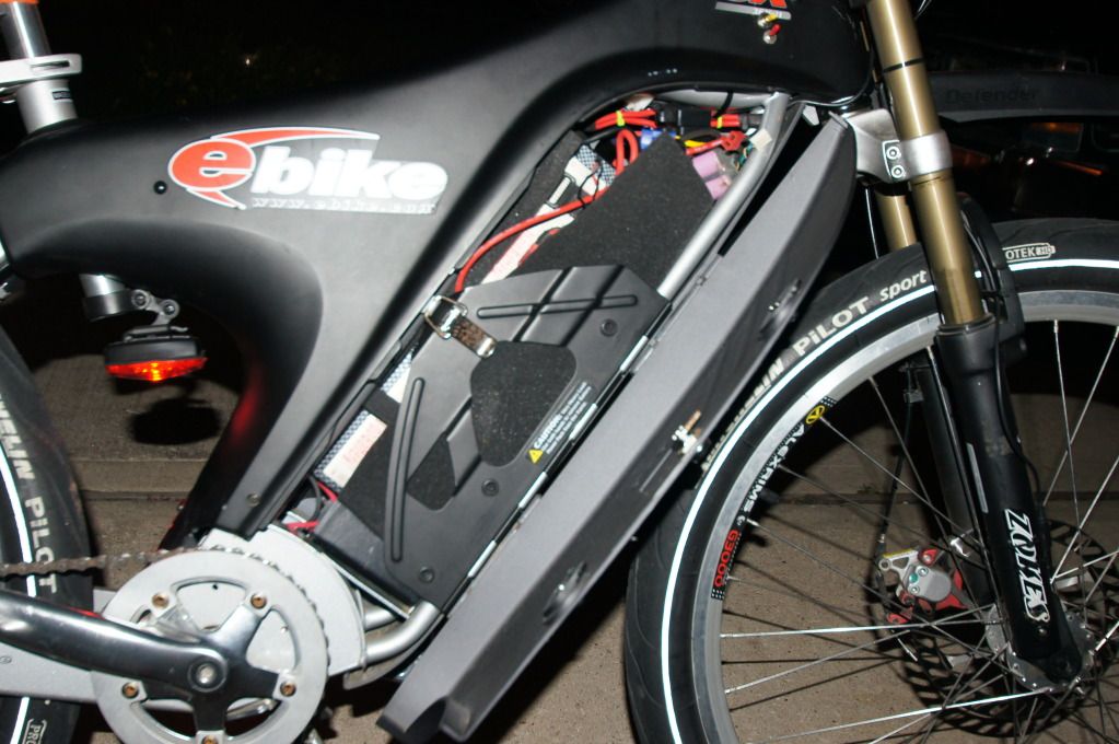

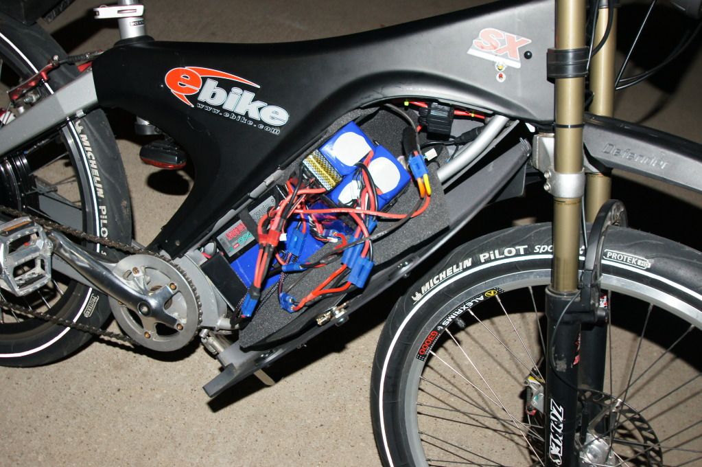

20s2p setup in my bike. It's rocking 6 new 6s1p 30c sky lipo and two 2s1p gensace that are 2 years old and still kickin.

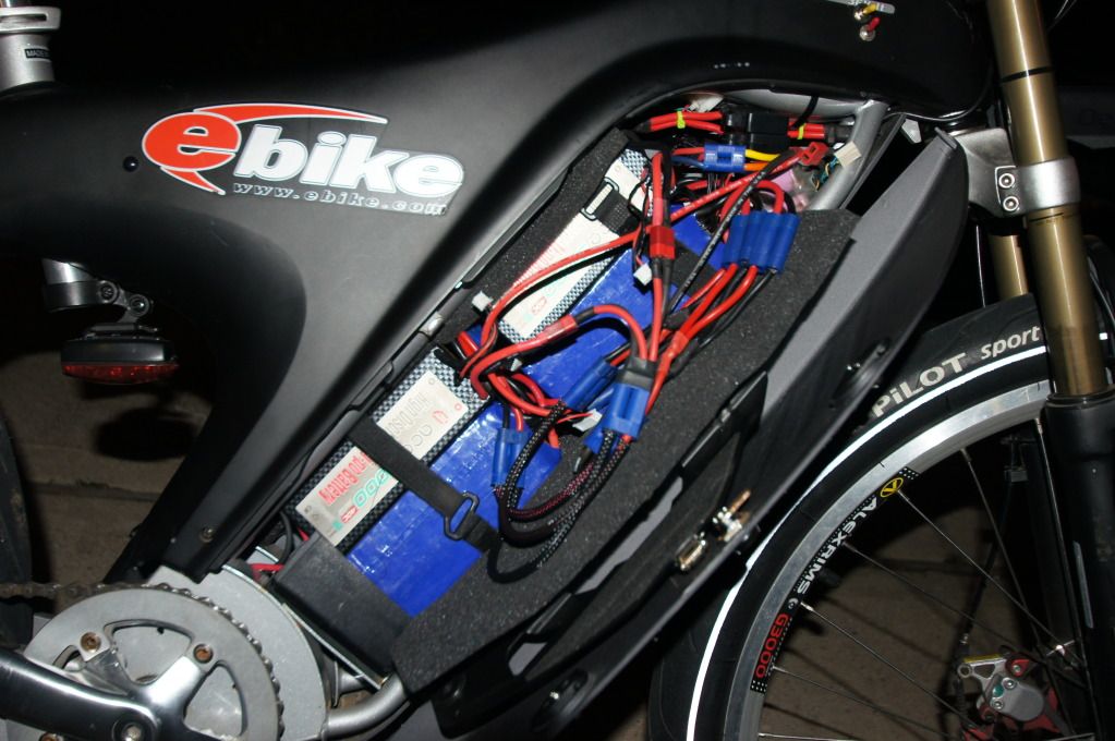

I managed to squeezed 24s2p inside the frame and I love it. A coworker was willing to try to build me a adjustable throttle delay to prevent me tripping the controller under acceleration. Gonna have to wait till he has some time to actually do it. I'm also looking for a small 12V laptop psu that I can hook up to my batteries to run my accessories.
I did a shakedown with the 24s2p pack.

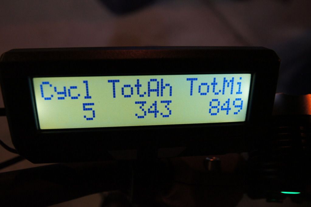

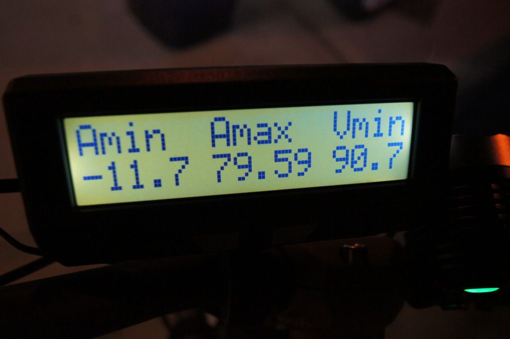

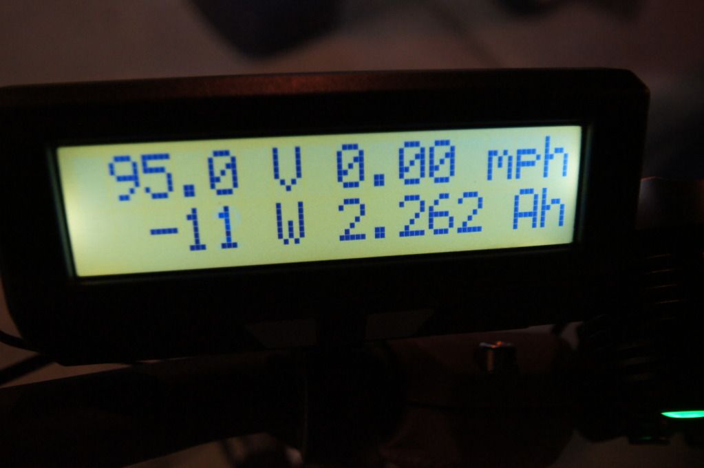

This is my 6th cycle on my Sky lipo's and had a bit of a tailwind.

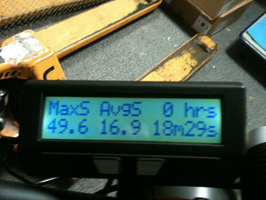

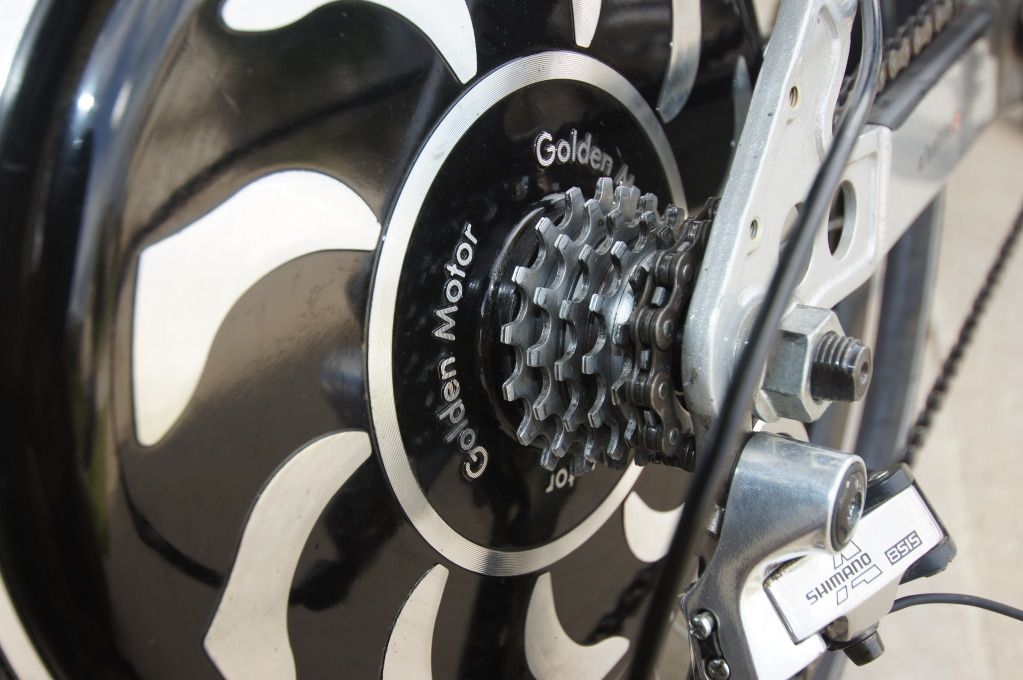

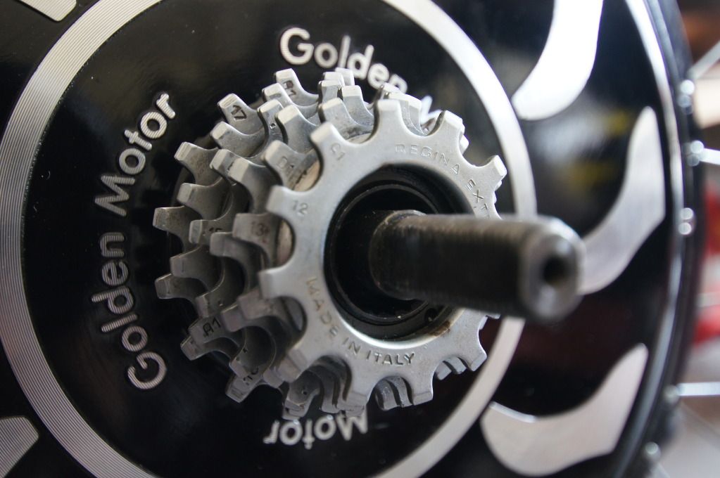

I bought a used 6 speed Regina extra freewheel and goes from 12-17T. The chain doesn't rub on the frame anymore, as it did with the 11T 7speed freewheel.
I upped the battery Amp to 65 and the Phase Amps to 140. Bike takes off smooth in my 2nd 57% speed now. 100% still cuts out if I hammer the throttle. Drilled a big hole into the controller case and added a fan. Still need to drill out two holes for fresh air to come in and add two fans. Waiting on some fan grills to come in.

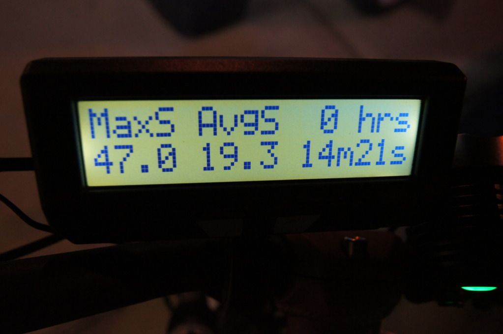

Today I did a 21 mile ride with mix road conditions. I used my lowest speed setting of 35% and 1 short burst of 57% speed setting. That whole trip only took me 3Ah. So I could easily get 60 mile range out of my 10Ah pack. Average speed is 18-19mph and easily to pedal with my new 12T freewheel.
Got to love HV setups for efficiency.
