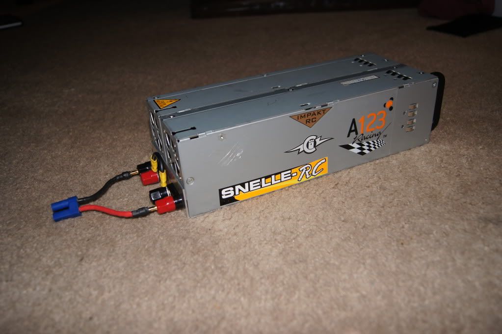

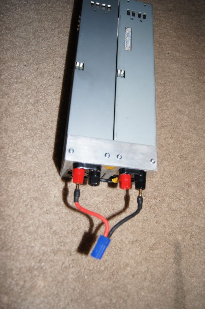

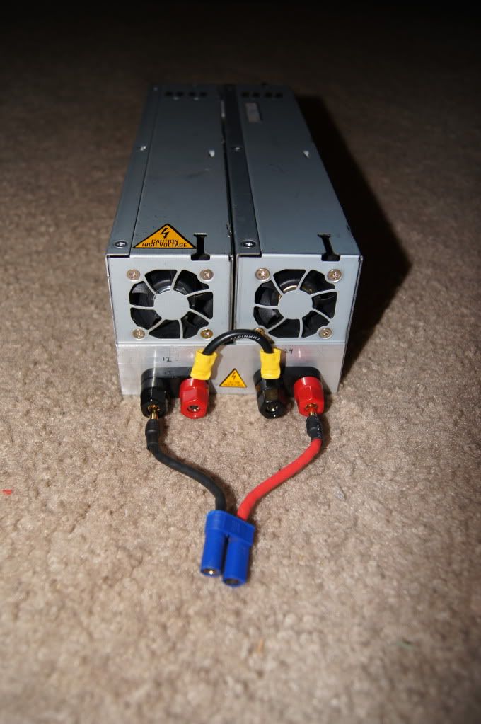

snellemin 07.05.2011 11:13 PM
I was lazy and bought me a kit from this dude on rcgroups. It's a pretty good kit, if you don't have much time to custom make your own 12v-24v PSU. You basically just lift the ground off one of the legs on the second psu. Cut some wires and connect everything.

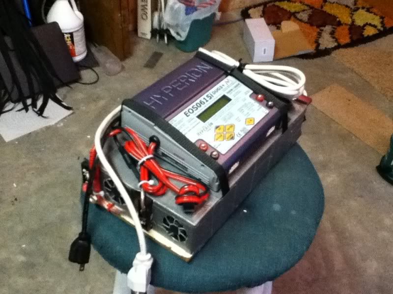

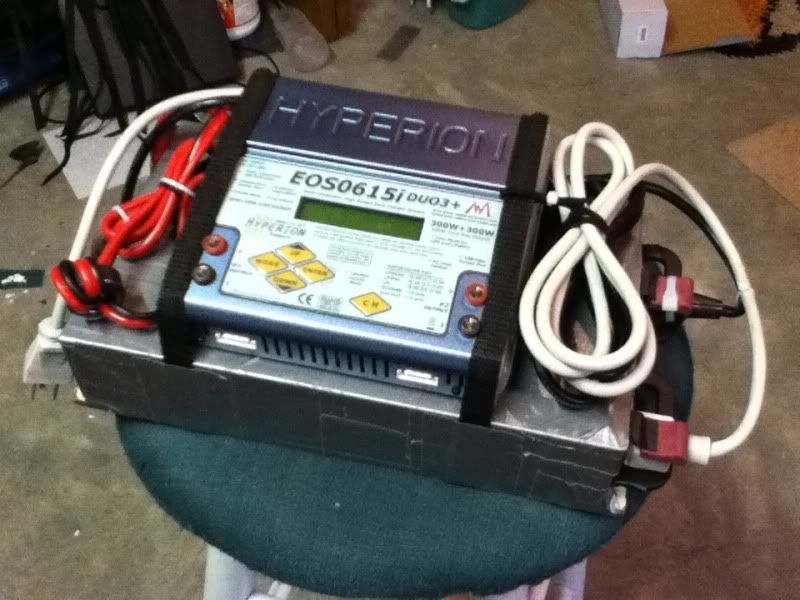

Ola 12.14.2011 06:01 PM
Just put together a PSU based on this thread! HP 47A psu`s in serie, making 24V 47A..
Not alot of work, and works great so far with a 206B 20A charger, while i`m waiting for my Powerlab PL8 in the mail..
Ill post pictures of the portable "charging case" im building when the PL8 gets here..
But the noise...
Anyone that has solved this without rebuilding the psu completely? Does it need all the airflow to stay cool?

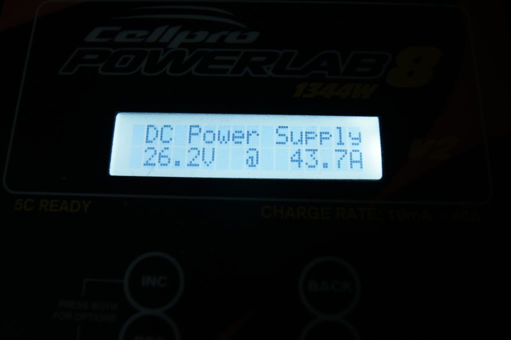

snellemin 12.15.2011 11:10 AM
27.6V......sweet.
This is what I was pulling this morning charging my ebike batteries.
http://i189.photobucket.com/albums/z...8/DSC01752.jpg
