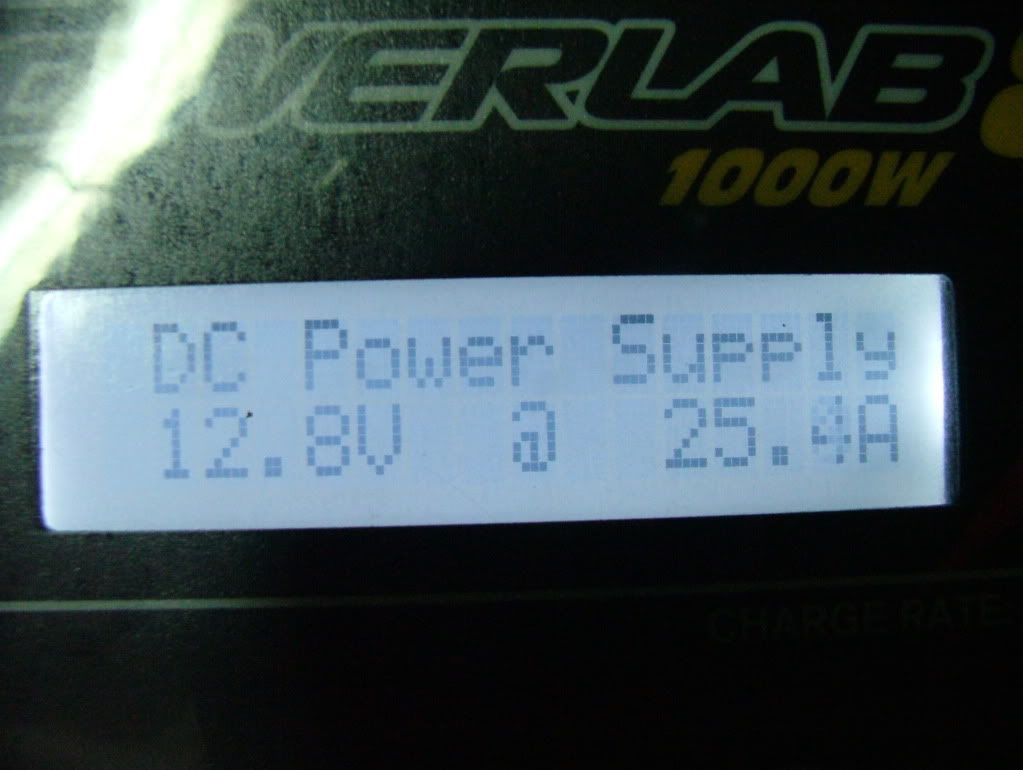

Naah, I haven't bothered opening it up. I wanted something simple and cheap. A regular ATX is too much work compared to this PSU. I will ask at work if boosting the voltage is even feasible with this PSU. I have no schematic of what the other pins do. I was pulling 25A last nite out of the PSU and the charger stated 12.8V@25A. When I get a few more, I'll open one up.

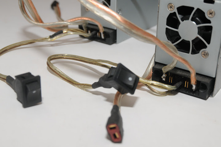

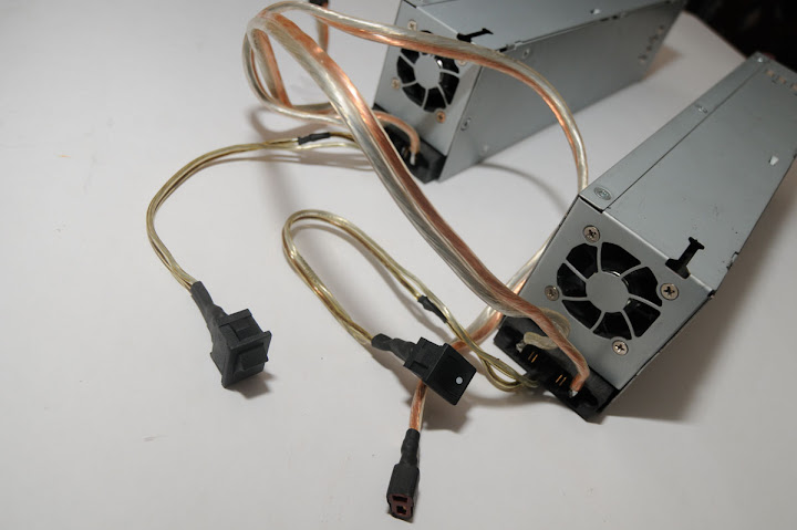

Yep... I got a pair of these a couple months ago from ebay... took some time to figure out what pin combination would start the 12v rail, but when i did, I was not disappointed...
I'm loving them plenty... very stable and very cheap... The fans are pretty loud though when the 12v rail is turned. I added a switch on mine and used deans for the output...
A few photos:
