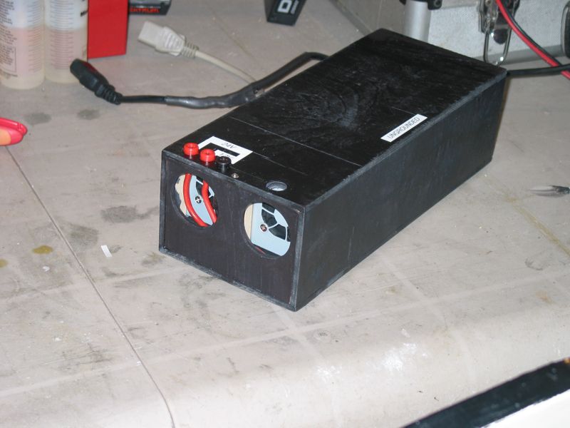

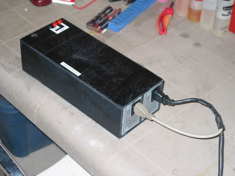

mistercrash 03.03.2012 09:07 AM
I made a 12V/24V power supply from two HP PSs. I installed an ON/OFF switch on the little wires I used to connect the three little pins of each PS and it worked fine. Then I decided that instead of having two power cords (one for each PS), I wanted the two to merge as one so I did that. I made sure to have one PS grounded and the other ungrounded. So now the switch doesn't work. Is there a way of wiring the switch so it can turn the power supplies on or off when the two power cords are merged together.
Thanks
Oh yes, the pics. Some in here like pics. I went for the compact look.
http://i177.photobucket.com/albums/w...no/24v_ps1.jpg
http://i177.photobucket.com/albums/w...no/24v_ps2.jpg

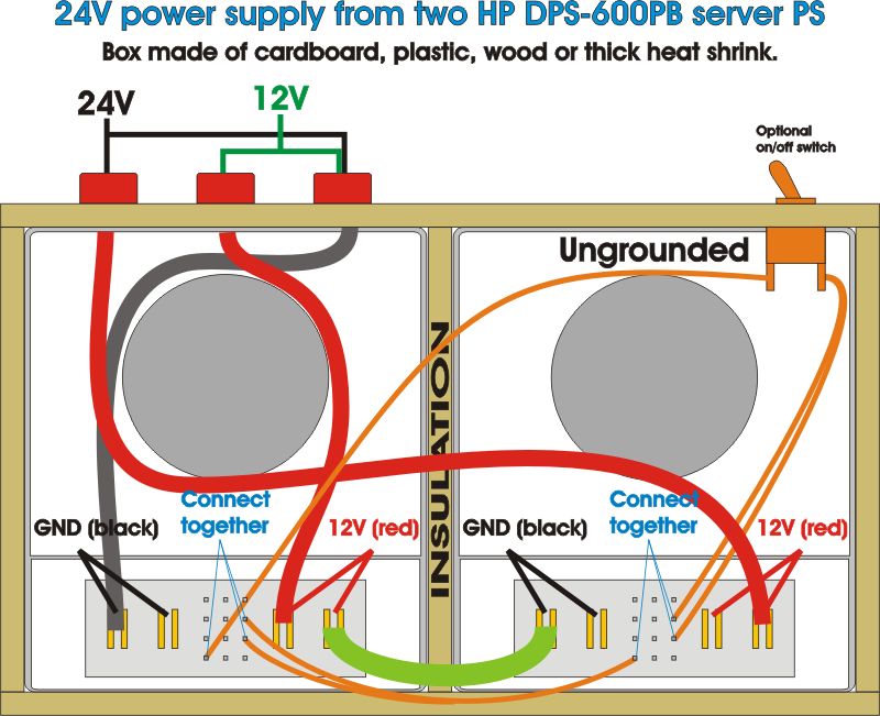

mistercrash 03.03.2012 09:51 AM
Here is how it was wired with the switch. It worked fine shutting off and powering on both PSs. But when I merged the power cords together, the ungrounded PS would always stay on and the grounded PS would always stay off no matter where the switch was.
http://i177.photobucket.com/albums/w...er_supply1.jpg
bruce750i 03.04.2012 10:54 AM
Switch the merged 120v
Mr.MC 1st I floated the 12 and 120 on one unit. Then I ran a single 120 cord into a 120 light switch (mounted on my charge box) then split out from there to feed a switched 120 to both units.
Edit: After looking at your pic of your nice and compact ps you don't have a place for a 120 switch. Oops my mistake.
Here is a pic of the last one I made.
mistercrash 03.04.2012 11:48 AM
Thanks for responding, I know I can easily put a switch on the power cord but my PS is self contained and not part of a bigger case. That is why I wanted a way to put a switch on the small wires used to connect the pins together, so the switch can be small and be part of the small box I made for the two PSs. Maybe I'll end up putting the thing in a case, yours looks real good by the way.
