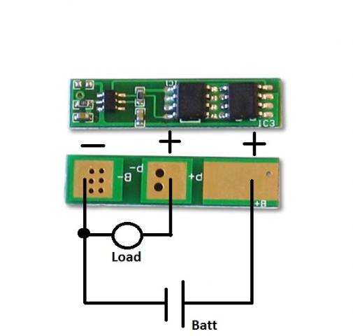

Chad, I'm not seeing like that at all. I see it as the lipo + and charger/load + are connected to the large pad on the right. The lipo - is connected to the pad on the left. And the charger/load is connected to the middle pad. Essentially, the LVC just disconnects the - lead if an error occurs.

In looking at the pic below, it should be pretty obvious that the battery + and load + are common.
http://lib.store.yahoo.net/lib/thesh....7vpcb8.5A.jpg
Which would mean there are two grounds?
@Chadworkz: I thought the module would be supposed to be separate from th charger device, as in only the lipo, module, and a connector (for charging AND connecting to the device, but not at the same time)

Two grounds? I think we are all making this a WHOLE lot more complex than it is. See the pic below.
http://rc-monster.com/forum/attachme...5&d=1274071038
They probably made it like this so that the "charger" also powers the circuit when it is plugged in, kinda like a laptop or whatever.
Chadworkz 05.17.2010 01:13 AM
If the LiPo and Device positives are connected to the same pad, the LiPo will directly power the Device without passing through the Protection circuitry.

BrianG 05.17.2010 02:24 AM
Not if the grounds are seperate, which they are. Normally, you see circuit interruption in the + lead, but there is nothing wrong with switching the ground lead. In fact, that's how old-style dome lights are switched on via pin switches in older cars. Car horns operate in a similar way. Just depends on the application. Could just be a matter of the circuit using an NPN vs a PNP transistor to do the switch action...
zeropointbug 05.17.2010 02:31 AM
Okay, do you see the labeling though Brian? If you ignore the drawing they provide, doesn't it look like they are switching the + batt terminal?
rawfuls 05.17.2010 03:39 PM
Got a quick email back...
"Hi Justin,
Thank you for your e-mail. The circuit diagram that you provided does
look correct.
Best regards,
Don Clark

BrianG 05.17.2010 03:45 PM
That photobucket pic is missing. It would be nice to know what the proper wiring was...
zero: The labeling is a bit "crappy", but the pic I posted makes sense assuming I am reading their label correctly.
No matter what, if I were to buy that device, I would be reverse-engineering it to make sure I knew what goes where. Those ICs are most likely commonplace for those types of modules, so a datasheet lookup should tell the tale.
rawfuls 05.17.2010 03:52 PM
I think it's around post 29
BrianG 05.17.2010 03:56 PM
Ok cool, that's just like the diagram I posted except I put the battery on top and the load/charger (connector in post 29's diagram) on the bottom. Same connections though...
Chadworkz 05.17.2010 05:06 PM
here is the fixed picture he posted above...
http://i53.photobucket.com/albums/g6...CMDiagram0.png
