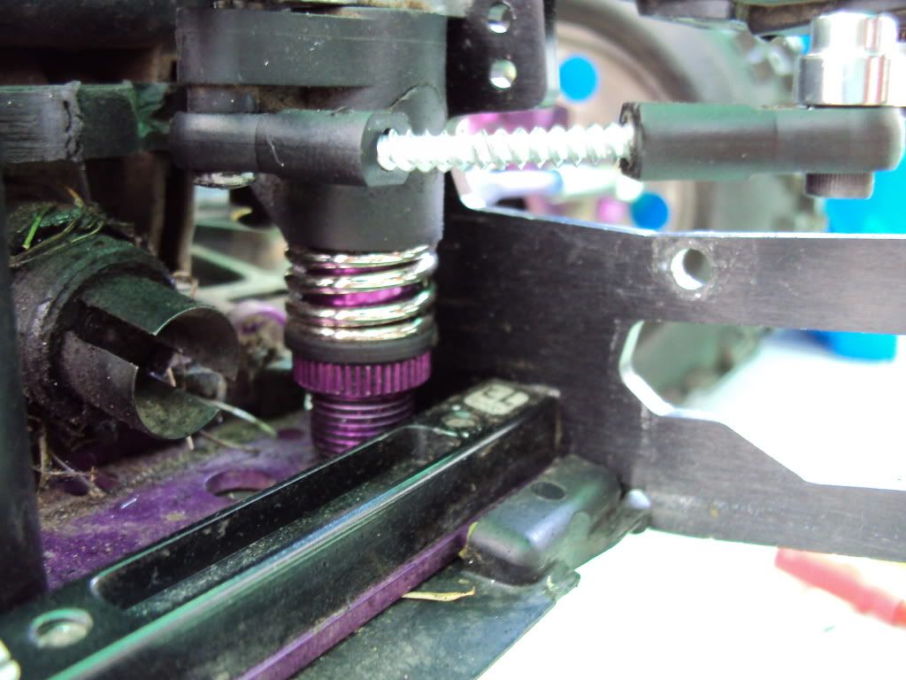

What are those tie rods?
I used Hellfire rod ends for steering in my build. Had to shave things a tad to get full suspension throw but zero issues after some major incidents. Haven't got a good pic of them but they are chunky and look the part. http://i1010.photobucket.com/albums/...h_IMG_0387.jpg 93627 HPI Turnbuckle M5x60mm Hellfire 85230 HPI Rod End Set 7x45mm Hellfire 86144 HPI Ball 6.8x8x3mm |
You ok _dv?
yea i was contemplating the hellfire ones... But i when i saw these i thought they were awesome! They are from a hyper st rear turn buckles http://cgi.ebay.co.uk/Hobao-Hyper-ST...item255b4068ac I like the bend in the rod as i have grinded a little too much on my RSC Conversion and its when at full throw... the steering isnt tight, but loose... so hopefully this small bend in the rod end will solve my minor issue and pull my steering inwards a little bit... terrible explanation but ill get pics... |
The stock savage rod ends are soft, sloppy POS... IMHO. lol

Ok i ran the truck yesterday evening... Those tie rods are awesome!!!! My steering is back to how it should be! very nice and tight!!! problem is because i ground of too much from the RSC Conversion on the knuckle, and the tie rods are doing such a good job... my drive shaft is popping out on one side occasionally... Nothing an O ring or two cannot fix on the diff side to push the shaft outwards a little... These rods are not necessary for anyone... i only decided to use them because i ground too much off the knuckle on my RSC Conversion.... upon fitting, you do notice they hit on the hpi sway bars upon turning if you have them that is... But its a simple fix... just slide your sway bar mounts a little furthur inwards and dremel a little bit of the sway bar end to give a little clearance... minor problem really! The lipos - upon arrival where all equally balanced at 3.87 a cell. They charged up and balanced absolutely fine. The lipos... i didnt run so hard as i just wanted to break them in... But they gave me an awesome first run time... and held punch nearly all the way till LVC... I am extremely happy with them! and i dont think i noticed much difference if any difference between these 40/50c lipos and the nanotech 45c/90c lipos i tried recently!!!!! I will reveiw again as usually the first 10 cycles of these turnigys is where cells can fail or balancing causes problems... but i have already charged them for a second time and they were fine... When they discharged after the first use... the cells were a little out of balance, but i found that to be a prob on all my lipos... It charged and balanced fine to 4.2V per cell! |
