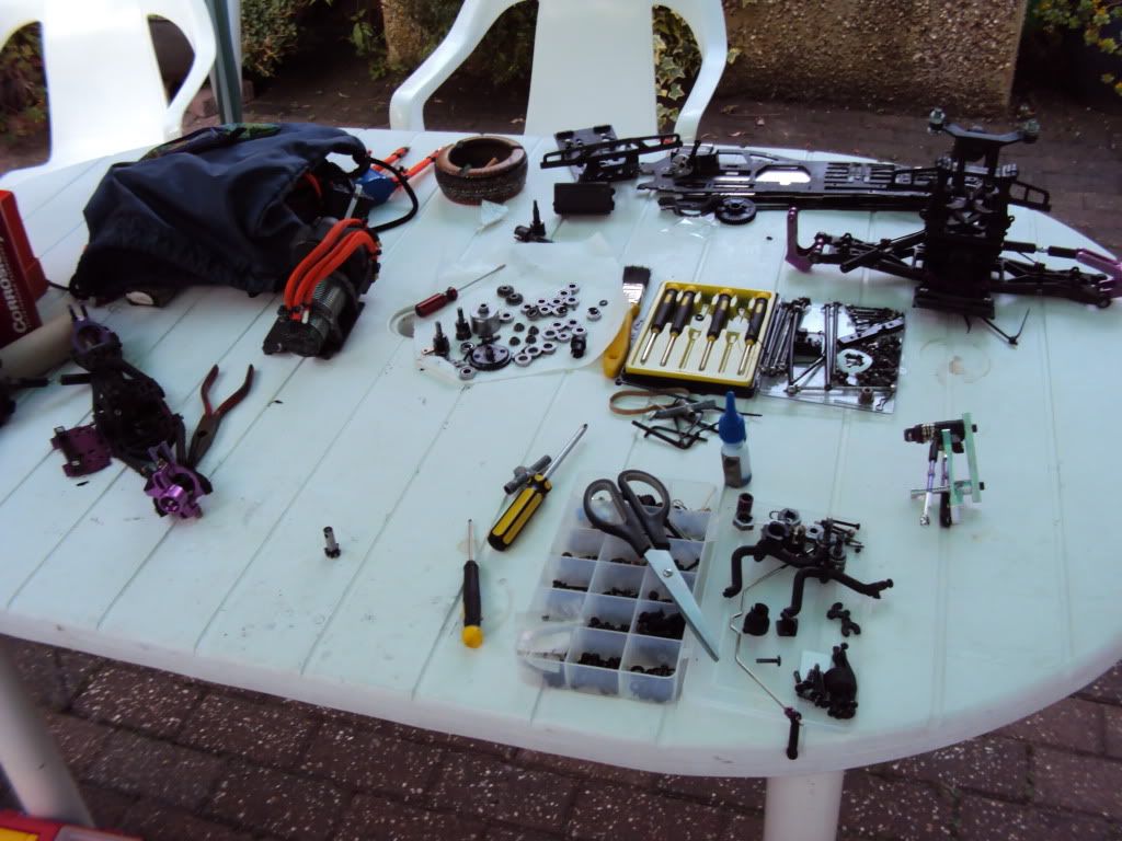

im in the process of tearing the truck down completely as its time for a full service... As we have had some very nice weather, i am doing my rebuild outside. Its a bit of a mess but here is my temporary outdoor workstation
http://i878.photobucket.com/albums/a...7/DSC00430.jpg
I found that all most of my bearings require changing or a clean. So i cleaned the ones which work and corrosion x'ed them.
I found one of my diff bearings had seized!!!! Very bad!!! So i think its nearly time for a full Boca Bearing upgrade...

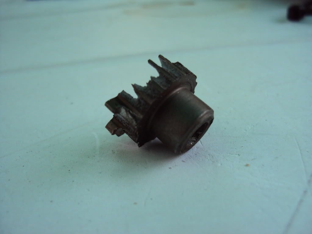

Also here are pics of my pinion which completely disintegrated...
http://i878.photobucket.com/albums/a...7/DSC00431.jpg

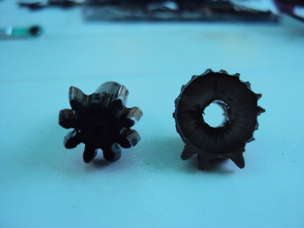

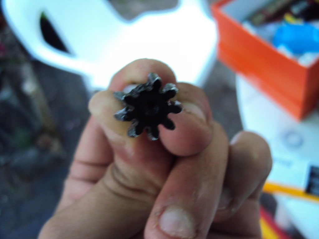

And i also somehow destroyed my fronot pinion of my so called "BULLET PROOF" Diffs gears!!!
http://i878.photobucket.com/albums/a...7/DSC00428.jpg
Here is both from a front view...
http://i878.photobucket.com/albums/a...7/DSC00433.jpg
I have now managed to buy a replacement single BP Pinion from ebay from a guy called ianwhorlow (uk ebay name) He is amazing! i asked him if he could do it and he said sure. Charged me 9 pounds! I am happy with that considering you cant get them separately from HPI... I will call HPI tomorrow and tell them about it, hopefully they will send me a new one!

nuz69 06.28.2010 05:05 AM
Hello Jahay, I might be able to help you on the pinion issue ^^
As my mugen spur literaly ate my RCM pinions, I tried 4-5 brands (my setup is MBX5T + NEU-Castle 1520/1Y + 6S + 15/46 gearing) :
RCM : fragile, already use after 6-8 batteries
losi : stronger than RCM, but already used after ~ 20 batteries
Robinson Racing : already used after 20 batteries
Castle Creations : currently testing
HPI : currently testing
NOVAK : currently testing but seems to be stronger than all previous.
==> try the NOVAK pinions ! You can find them on Ebay under 3 pinions package like 19-20-21 for example.
For your diffs, try to shim them, the mesh has to be good, and the diff must not have right-left play (mesh must be constant).
Jahay 06.28.2010 05:09 AM
I know Nuz! Im going through pinions every 5-10 runs!
Im trying a 17t hpi pinion on there now (havent run yet) but once this fails, ill prob be looking into doing my Centre diff conversion. I will look into novak pinions then.
Thanks for the help!!! im happy it isnt just me experiencing Pinion problems... Most people dont seem to have these problems...
