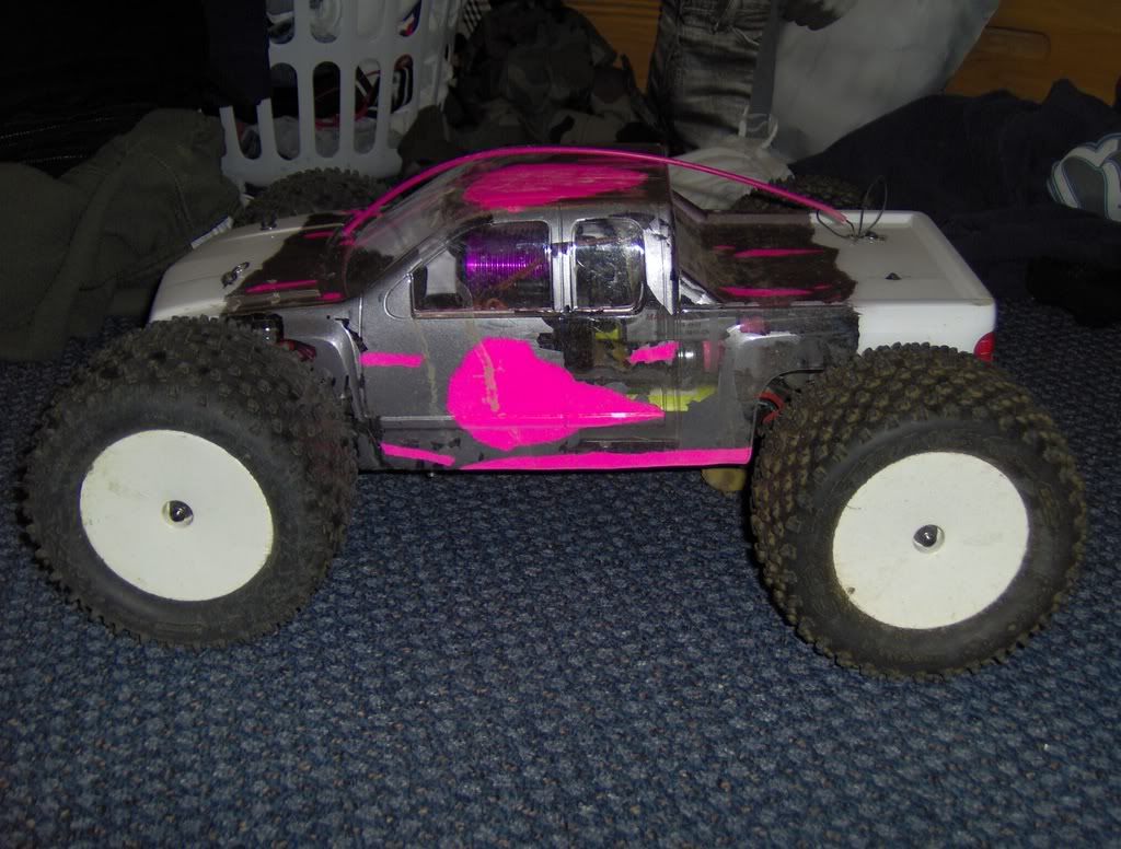

Hmm, motor is cooler than esc, so sounds abit under geared- could/should be able to gear up a tad bit further in theory. Still, those temps sound pretty decent, but it looks like something took a dump on it (what is that brown dribble?...).
gtxracer 11.11.2007 03:28 PM
Mud. Dunno how it got there but it came back from one of the passes with it on the lid. Yeah, I figured I needed to gear up.
squeeforever 11.11.2007 04:57 PM
Actually, since the motor is cooler than the esc it would be overgeared.
gtxracer 11.11.2007 07:31 PM
Actually, the motor ISN'T cooler than the ESC and the tires break loose instantly, so I'd say it's under-geared. You guys are also confusing me since you both said the opposite of what I posted, haha.

squeeforever 11.11.2007 09:35 PM
I was just going off of what he said. I didn't look to see the temps, but a cool motor and hot ESC means its overgeared since the motor will be pulling to many amps and cause the ESC to get hot. Its the opposite for undergeared.
By the way, did you happen to lightly scuff and wash the body with soap before you painted it? If not, thats why the paint didn't stick.
gtxracer 11.11.2007 10:50 PM
I did wash and lightly scuff the body. If you look close, it's only the gunmetal, which was in the "lexan" section but apparently doesn't stick well. My Pacra (sp?) Chrome did the same thing, yet was "lexan" specific paint.
