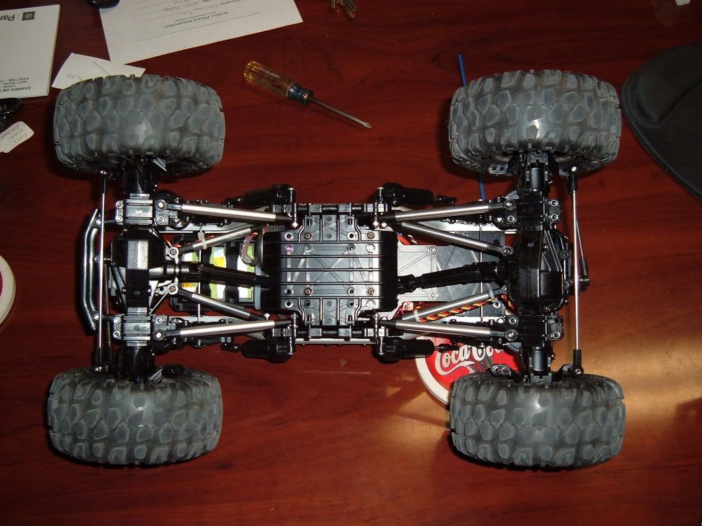

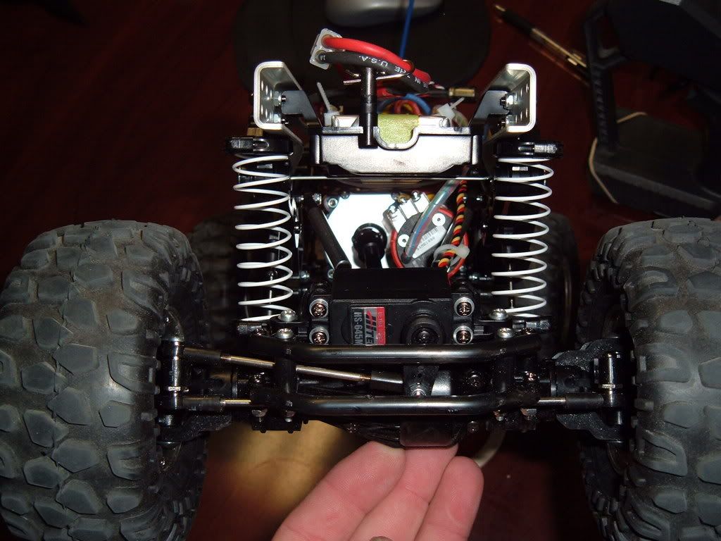

I will have some completed body off pics tomorrow. Just need to put the servos in and double check everything. The novak motor and esc fit nicely. This truck has alot of space for gear, easily could fit a pair of escs and a pair of receivers!
lincpimp 05.26.2008 07:18 PM
Picture time!
Here we go! This thing is fast, I really need to drop down to a 16t pinion from the factory 20t. Good low speed driveability with the novak ss. Only missing the drag brake. So I may buy the crawler system, but will have to find a good deal on it used...
http://i206.photobucket.com/albums/b...p/DSCF2158.jpg
http://i206.photobucket.com/albums/b...p/DSCF2159.jpg
http://i206.photobucket.com/albums/b...p/DSCF2160.jpg
http://i206.photobucket.com/albums/b...p/DSCF2161.jpg
http://i206.photobucket.com/albums/b...p/DSCF2162.jpg

johnrobholmes 05.26.2008 09:40 PM
I actually have a crawler system I am not using if you want.
The way the novak is set up, there is no drag brake. You hit throttle and it will coast if the slant is steep enough. It hits the brakes at neutral, so there is no proportional brakes. This doesn't work well on steep slopes, as it will coast until you let off- then it slams on the brakes. Some people like it, some people don't.
