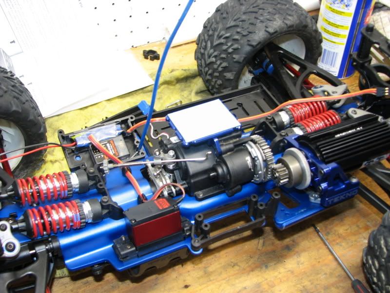

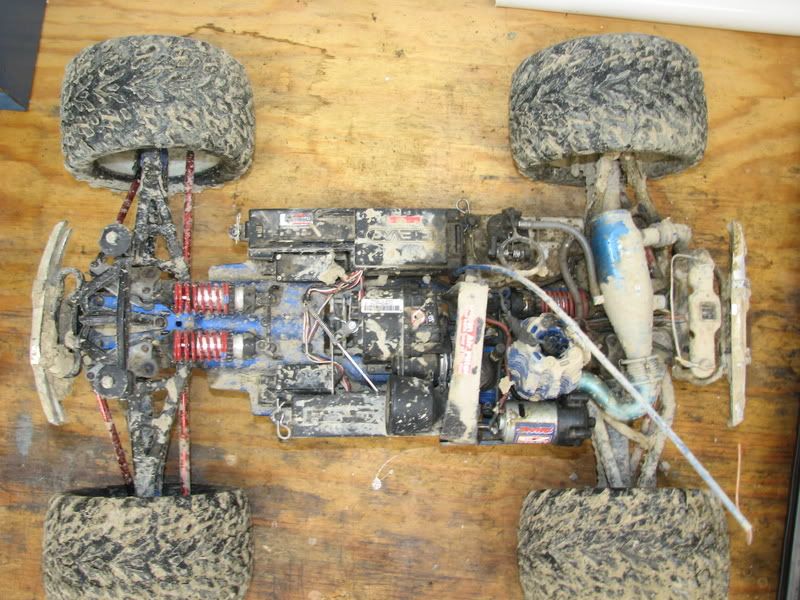

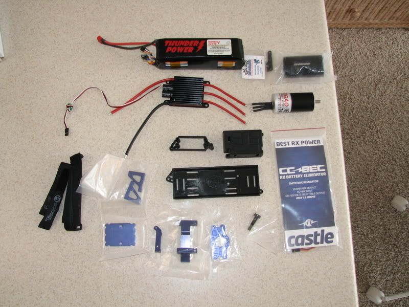

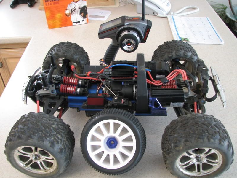

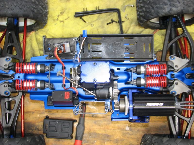

My specs: 6S 5000mah 22.2v 25C TP battery (Left over from my Trex 600) ~$290 Teckno Conversion kit ~$150 Feigao 9XL ~$80 Turnigy Sentilon 100A HV ESC 12s max (Can handle ~4500 watts) ~$100 E-revo beating the nitro guys on the track for 30mins straight...Priceless Spektrum DX3R JR 9100T steering Castle 10 amp Regulator FoC/Center Diff/Rear brake Here are some pics of my build and completion: Before http://i19.photobucket.com/albums/b1...y/IMG_3857.jpg All the goodies http://i19.photobucket.com/albums/b1...y/IMG_3859.jpg Half way done http://i19.photobucket.com/albums/b1...y/IMG_3872.jpg Mostly Done http://i19.photobucket.com/albums/b1...y/IMG_3876.jpg The big pack http://i19.photobucket.com/albums/b1...y/IMG_3900.jpg Ta da!!! http://i19.photobucket.com/albums/b1...y/IMG_3906.jpg I am going to the track tomorrow..12:41am...okay today, i will try to get some video of it. Although, that center diff is way to loose with 100k oil in it. I have some 500k on order should be here tuesday or so and I will post some videos then. Oh I should add, temps are about 5-15 degrees over ambient for the ESC and about 120-140 on the motor running in ~60 degrees indoor after a 20 min run. |

Looks good. Check that clutch bell/spur alignment. In the pictures it looks like there is a little misalignment. Could cause wear or stripping problems.
