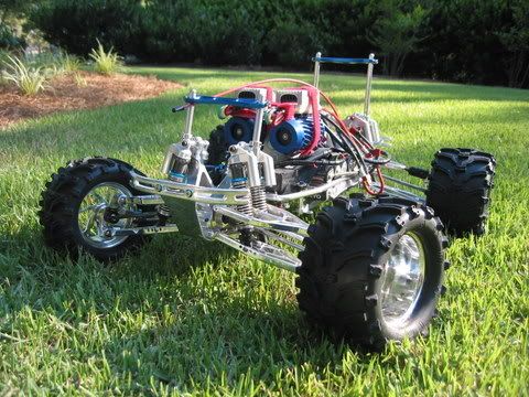

i have SUPERMAXX EMAXX with dual Plettenberg BigMAXXimums & Schulze 18.97 esc's(24cells)......All metal gears in diffs and trani.....The week link is the transmission output shaft!...does anyone make a titanium or hardened steel output shaft?????????????????

Not sure about the output shaft, but I would love to see some pictures of this beast you speak of.

that truck sure looks very nice. however it sure is awfully heavy.
so maybe making it lighter will also help to deal with your output shaft problem.

this is the reason for my problems!

this is the reason for my problems! - 03.23.2008, 06:58 PM

Anyway, i think the problem is you have enough power bolted to that truck to move a 1:5 scale... nay, 1:2 scale even (powerwheels jeep). I would suggest running a single plett- more than enough power.
You would need to get a custom machined output shaft for the stock 3906 tranny design, or go to a centerdiff type setup perhaps...

My question would be if you upgrade the output shaft, what would be the next weak point? Like was stated prior maybe you just have too much power onboard for the setup? Still the rig looks pretty sick to me. Nice work. Any chance you could post a few more photos for a better look at the power plant? Nice truck.
I have one very similar, but have not really settled on the electronics just yet $$$. I am busy trying to set up my FLM Maxx with the duel Dewalt 970 motors hooked up. I am taking my time with them because I hope to avoid any failures just to get running the way that I hope.

i will put up a vidio this week...THERE ARE NO OTHER WEEK LINKS!...the output shaft heald up for about 15 TWENTYFOUR cell runs!!..thats not bad for an $8 part...i put in a new one tomorrow!....the old shaft was weekened a bit when a grub screw came loose on one of the trani output drive cups...it must have taken out more metal than i thought!............
