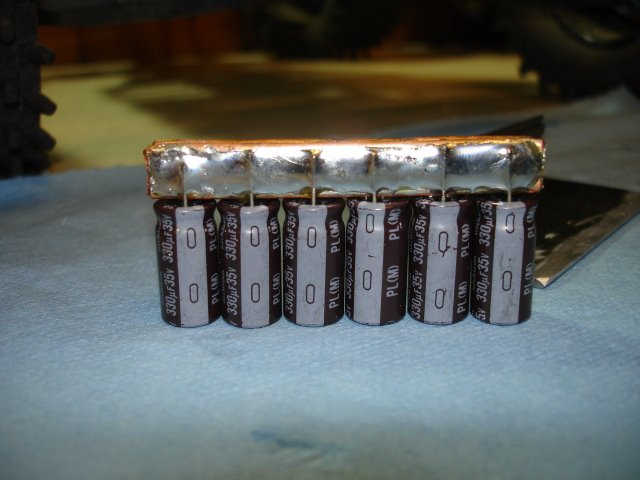

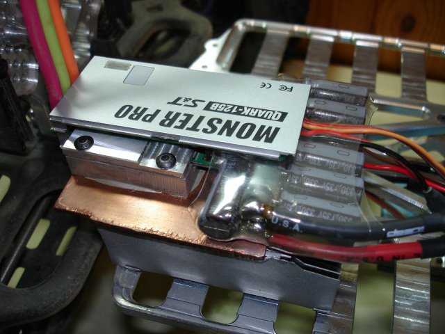

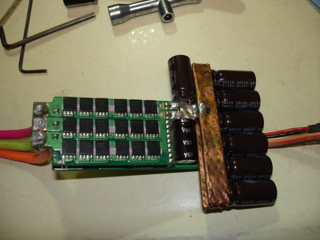

Here is what i did last summer with my Quark 125.... It's very overkill I know, but that thing could handle ANYTHING i threw at it, massive over gearing, you name it.

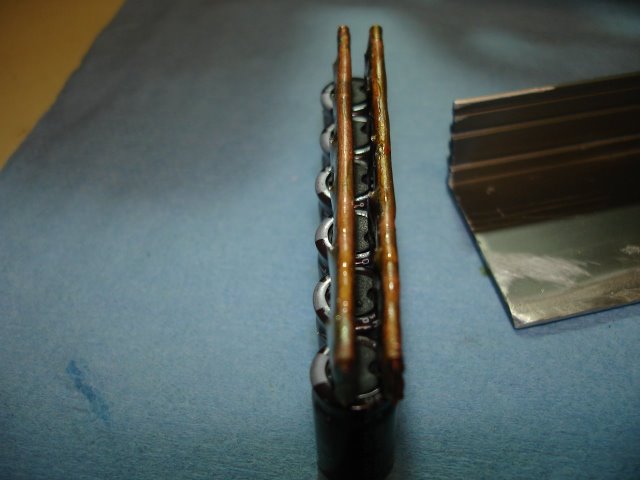

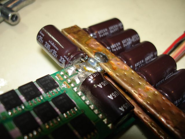

It is not bad, but to achieve the goal -> there should be no connectors on the path from caps to ESC and wires should be as short as possible.
Like Zeropointbug, but with less caps :)

A couple more pics
