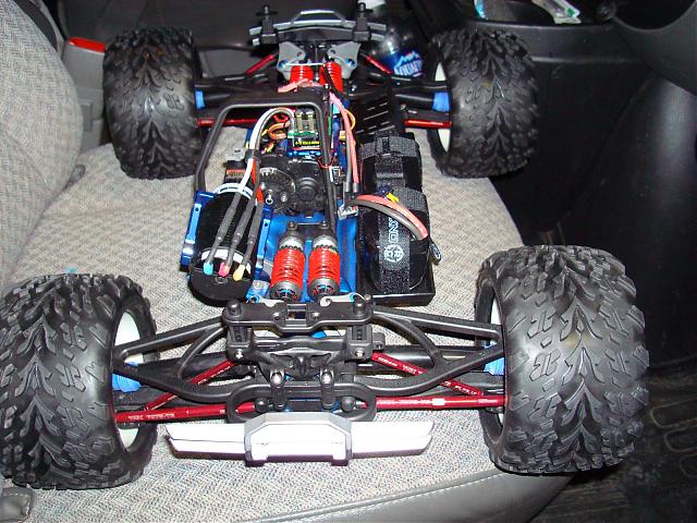

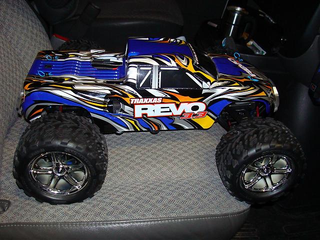

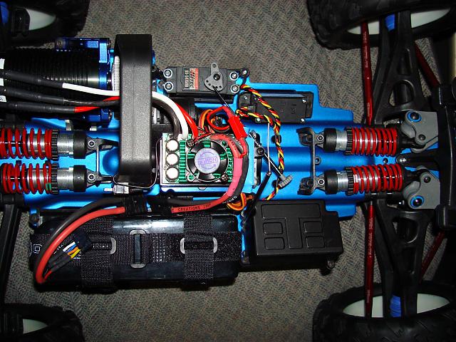

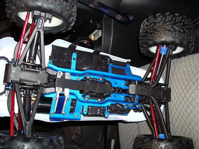

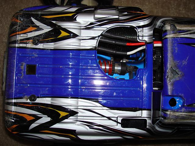

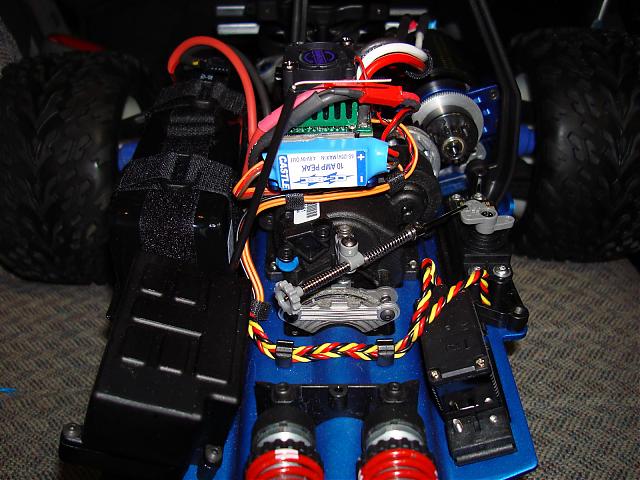

Hey everyone. I read a ton of posts here when I decided to do an electric Revo and thanks for all the information. I ended up building a Tekno RC conversion Revo and I am extremely satisfied with it. I purchased a lot of different stuff but I think the Tekno kit is the best that I have seen. Here are some pictures and I will be getting some video real soon.
Thanks for looking and I am open to questions and comments.

That's a Feigao right? Nice getup, looks clean!
:D
BlackedOutREVO
01.16.2008, 12:31 AM
Thats a NEU man.....
Very nice layout! Super clean
Looks like a Neu to me.

ya the fins make it look like a neu.
very clean setup BTW.
hows the neu workin with the mm esc?

I've seen too many finned Feigao's lately, I just wanted to know if that's what it was. Neu's usually run on other ESCs, not us Mamba users :)

definatly a neu, it has the classic neu sticker on it too, and the blue red yellow wires, great job on the truck and welcome to the forum

Looks real nice! What batteries are you running?
BTW GTX: The MM doesnt seem to have issues with the Neu Motors when used in the Tekno conversion. The clutch that goes on the motor makes it so there is no load at all on the motor at startup so there is no cogging. Startup is the only time the MM has problems with the Neu, once its moving it runs fine.

Wow, thank you everyone for all the replies and kind words. I can see what kind of forum this is.
The motor is a Steve Neu 1515/1Y/F with the MM ESC. I have heard a lot of problems with cogg on this combo but as mentioned here, the clutch system eliminates/masks the issue which I have not even noticed once. Its kind of cool to be able to rev up the motor without it moving and then blip the trigger pressure and the truck will wheelie, flip on its lid, or just moderate the throttle and it ripps away. I am still using the 2-speed and it has been ok for about 6 packs.
I am using Maxamps 4S 6000.

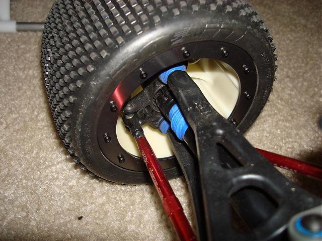

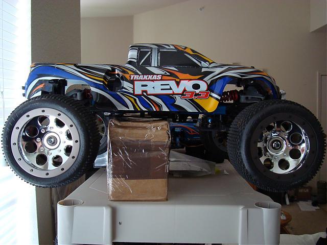

Some recent pictures....
