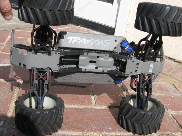

Hay David,

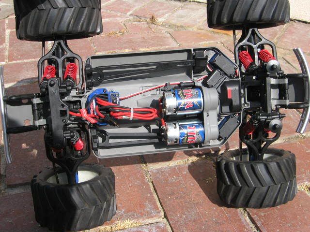

I'm a huge fan of the 3905, here are the many different looks / version of what is possible out there for you.

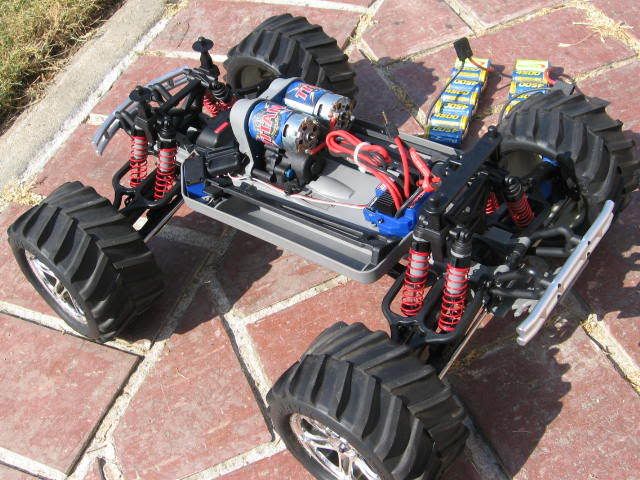

Here is a stock 3905 Emax ($345.00)

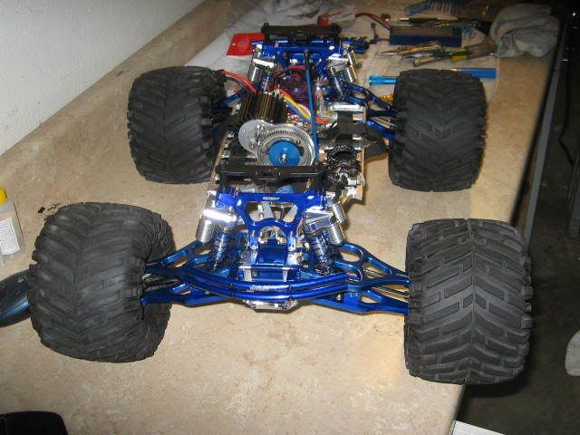

Here is what a 3905 duel V-Twin looks like (yes it takes a fricken beating) on 6s, the total investment was just under $1200 for everything.

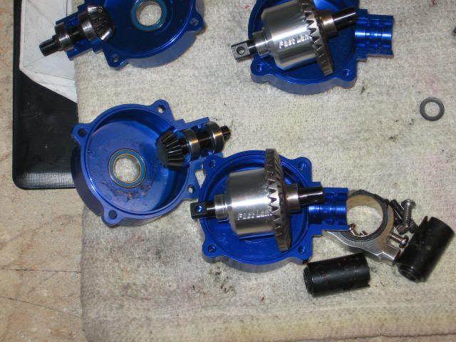

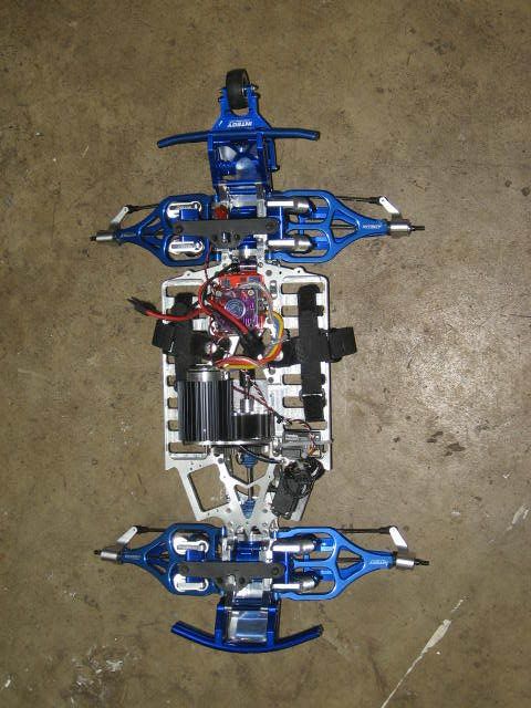

Here is an all Alu 3905 (heavy though). @ $1800

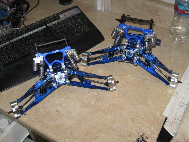

Here is the FLM setup for the 3905 @ $2100
Nothing!.. Hahahahaaa..

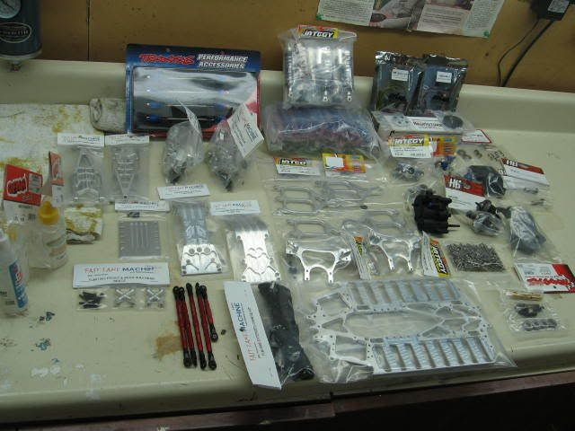

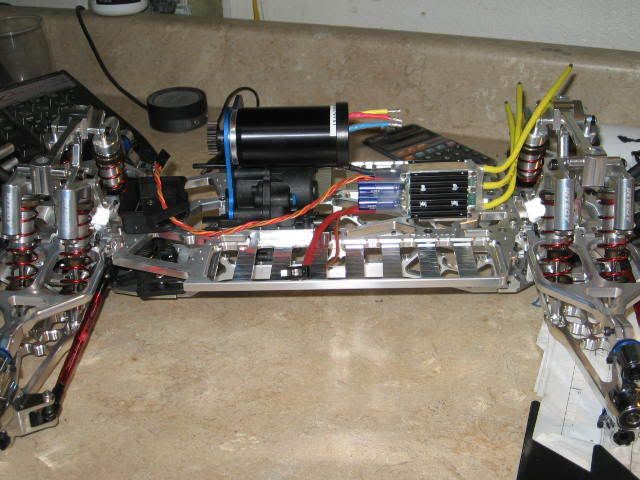

Last but not least is the GorillaMaxx 3905 @ just under $2800
Bottom Line the stock Traxxas 3905 E Max is one hell of a basher!, 6s is really to fast for it, you can do wheelies @ 45+ mph but it is extremely unstable at those speeds in this truck. It’s a basher not a racer, to achieve these speeds you will need to of course upgrade all of the drive train
The FLM version is a great basher and somewhat track friendly, however the GM version of the 3905 is totally awesome!. Mainly track but a basher no the less.
