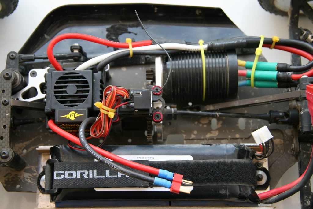

Hi guys,

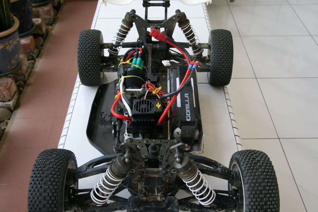

Finally, we're close. I'm still waitig for Dan's conversion kit since Feb I think. In the meantime, I decided to improvise a little :

DRIFT_BUGGY
DRIFT_BUGGY's Avatar
Posts: 2,077
05.03.2008, 05:20 AM
Nice and clear photos. Keep us updated.

pwrpony
Posts: 11
Join Date: Jun 2007
Location: navada
05.04.2008, 11:32 PM

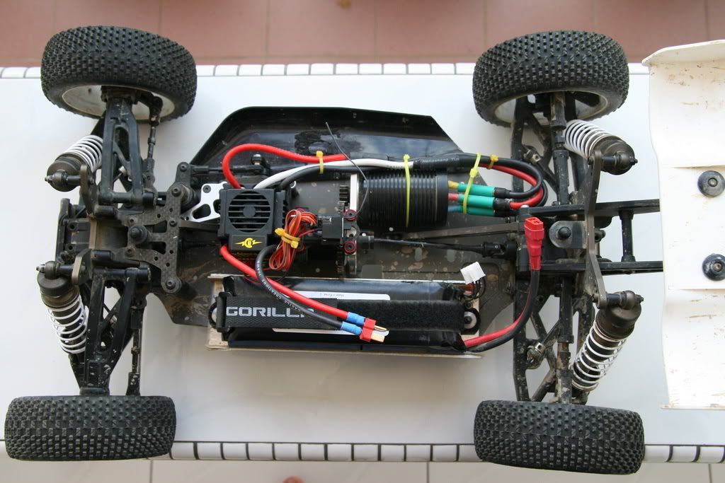

nice jammin. is that the X1? what mah batt you running?

joeling
joeling's Avatar
Posts: 463
Location: Malaysia
05.05.2008, 02:22 AM
Hi pwrpony,
I'm using a polyquest 4S 6000mah 25C lipo. Target is to keep it running for 30 minutes

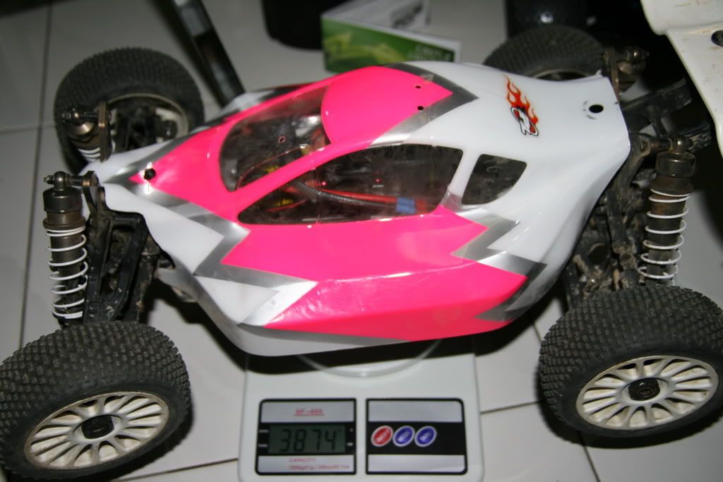

05.31.2008, 01:27 AM
Hyper 9e Medusa 4S, Savage 5S MMM 8XL, Jammin' 4S Neu MMM, X2 Ninja JX, X2 MMM 5S Neu, E REVO Medusa 6S

05.31.2008, 06:04 AM

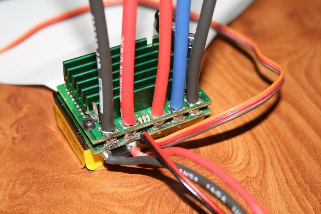

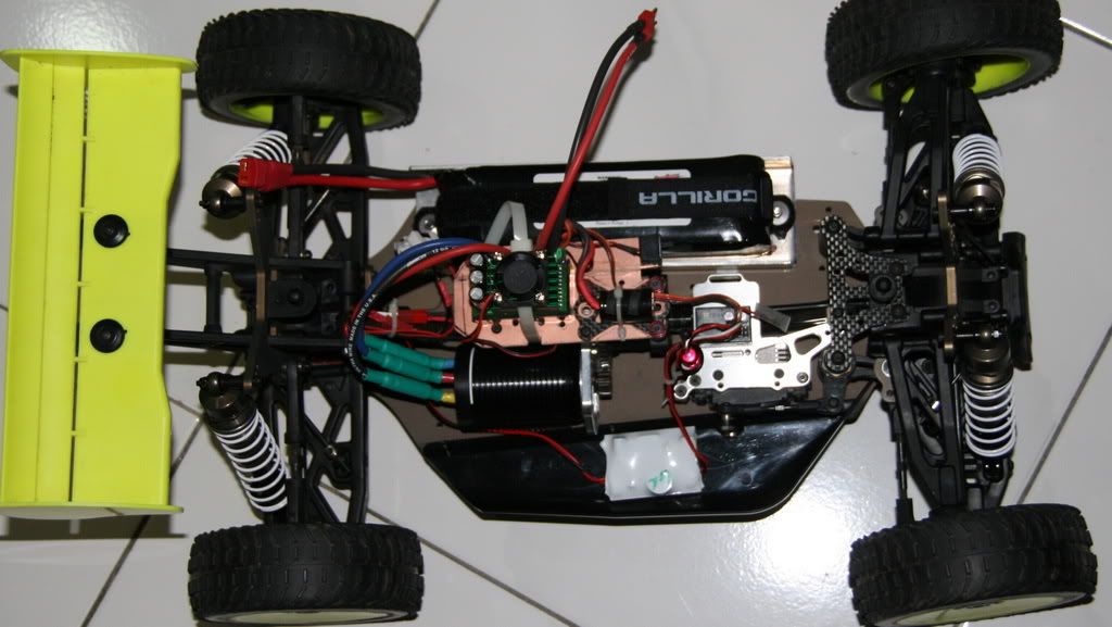

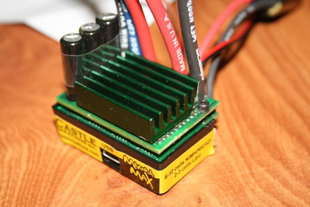

hows it running? what happened to your double deckered Mamba Max?
looks great, hopefully ill do just as good of a job with mine...

05.31.2008, 10:38 AM
Hi guys,
Thanks for the compliments. I have run it lightly in the street at the front of my house earlier today for about 5 to 6 minutes & everything seemed ok so far. The real test will be tomorrow at the bashing track.
The double deck is still alive although I managed to damage the plastic case. It needs 2 fans to keep its temperature under control. Unfortunately, the 25mm fan that I put on top of the heatsink keep dying for some mysterious reason. When that fan was not working, temps soared to 60 deg C under hard running. Too high for my comfort.
Unfortunately, weather plays a part in my line of business. We are maintenance & minor Hookup commissioning contractor to the oil majors in Malaysia & most of the action is offshore. Bad weather is bad for business...
Regards,
Joe Ling
PS : BTW the weight of the whole kit is close to 3.9kg. Is this too heavy ? How does it compare to a typical Jammin' conversion ?
